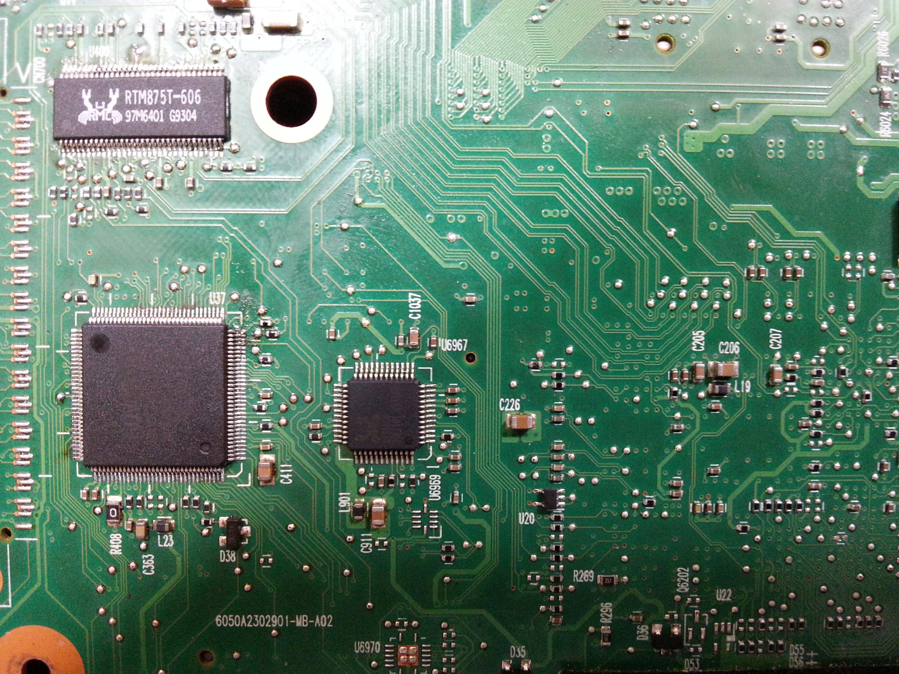

    this laptop has keyboard stuck key (3) wu=ith beeping sound:
    i removed the keyboard
    i changed I/O
    the same problem still

    check network capacitor

      Re: toshiba L505
      how can i locate it? i removed realtek ic of network but now i have no display

        Re: toshiba L505
        I think he meant, check capacitor around SIO or keyboard connector. Have you tried other keyboard?

          Re: toshiba L505
          i tried new one with no luck

            Re: toshiba L505
            i found that there is no volt on scan in 0 which is pin 54 on WINB_NPCE781LA0DX_LQFP_128P but i cannot find the datasheet of this ic?
            i want to find R415 on board but cannot
            thanks

              Re: toshiba L505
              when i found that pin 54 has no 3.3v and found it was not soldered well on board....my fault
              any way thanks all for help
              now every thing is ok
