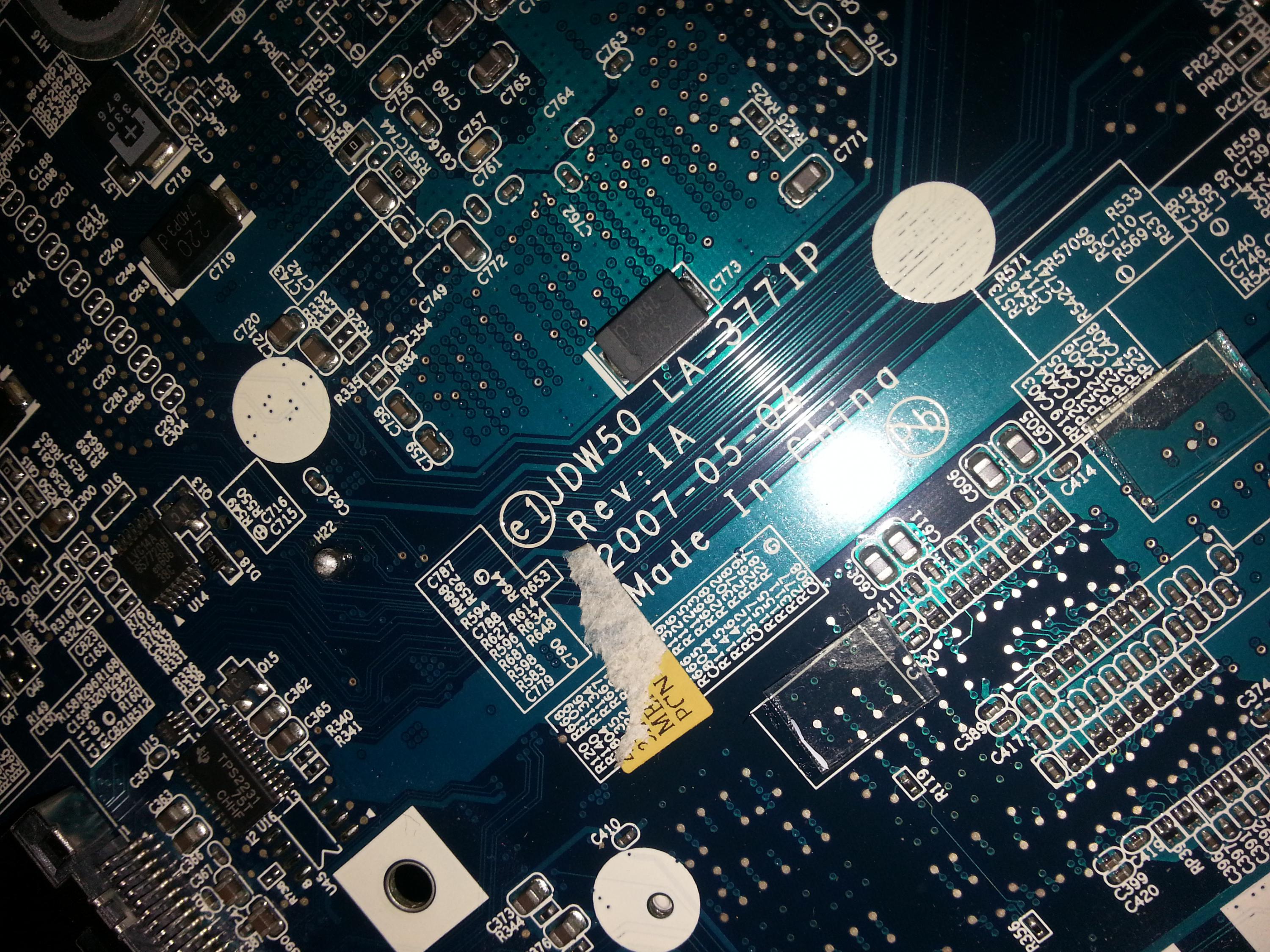

    hi

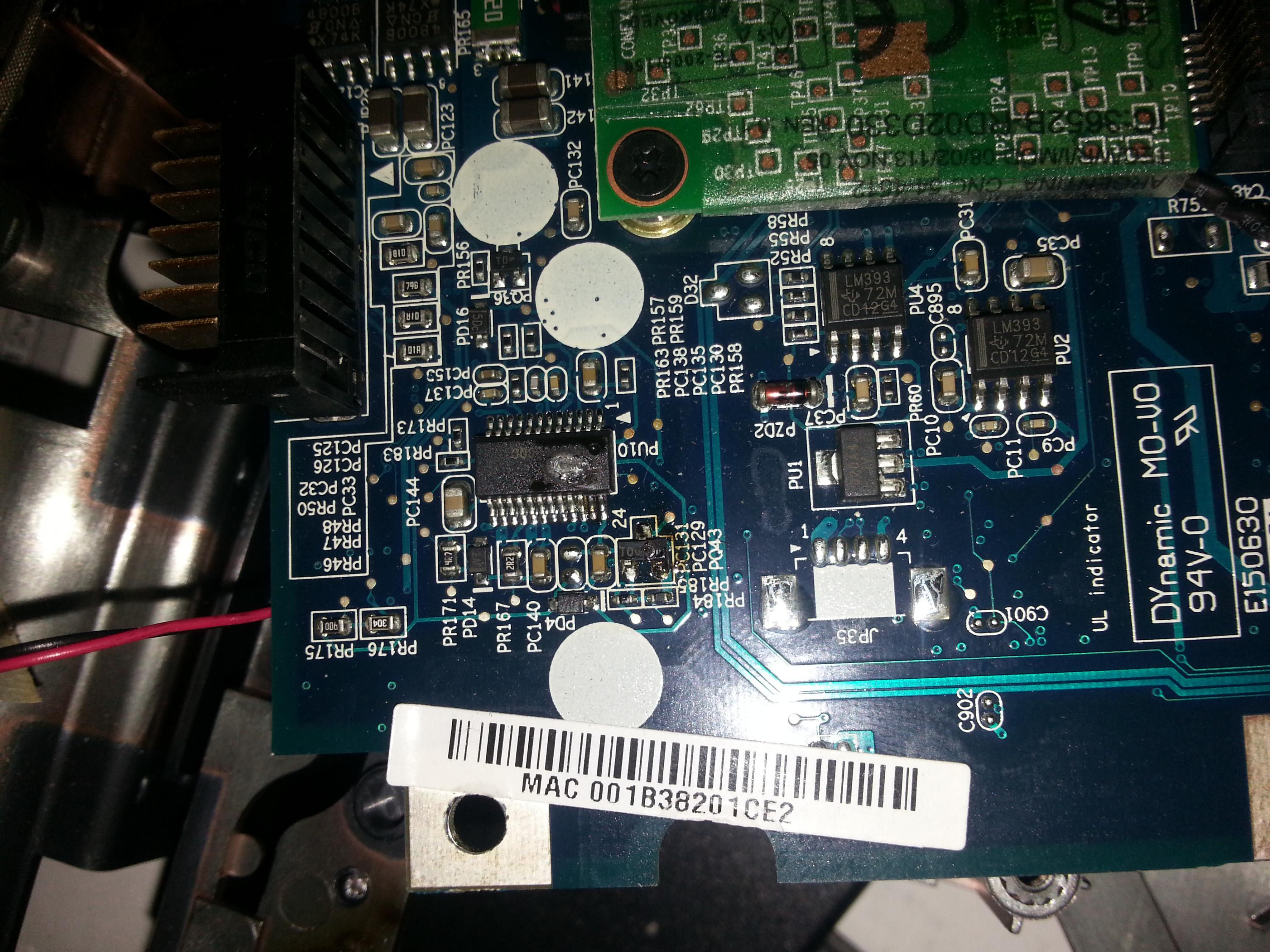

    this laptop is dead with burning parts
    i found this schematic but not the same and cannot find the reauired parts:
    Acer_Aspire_5310_5710_-_COMPAL_LA-3771P_JDW50_JDY70_-_REV_0.1.pdf
    my board is la-3771p rev: 1A 2007-05-04

    Re: aspire 5310 dead
    I hope this will help, pu10 is ISL6251. check page 37.
      what about q43? how can i determine its type
        Pq43 - tp0610k
          i cannot find tp0610k. can i replace with some thing slse?
            Hi, i found tp0610k in compal board. changed both pu10 and q43. works fine
            thank you very very much : lezsimply and greg464
