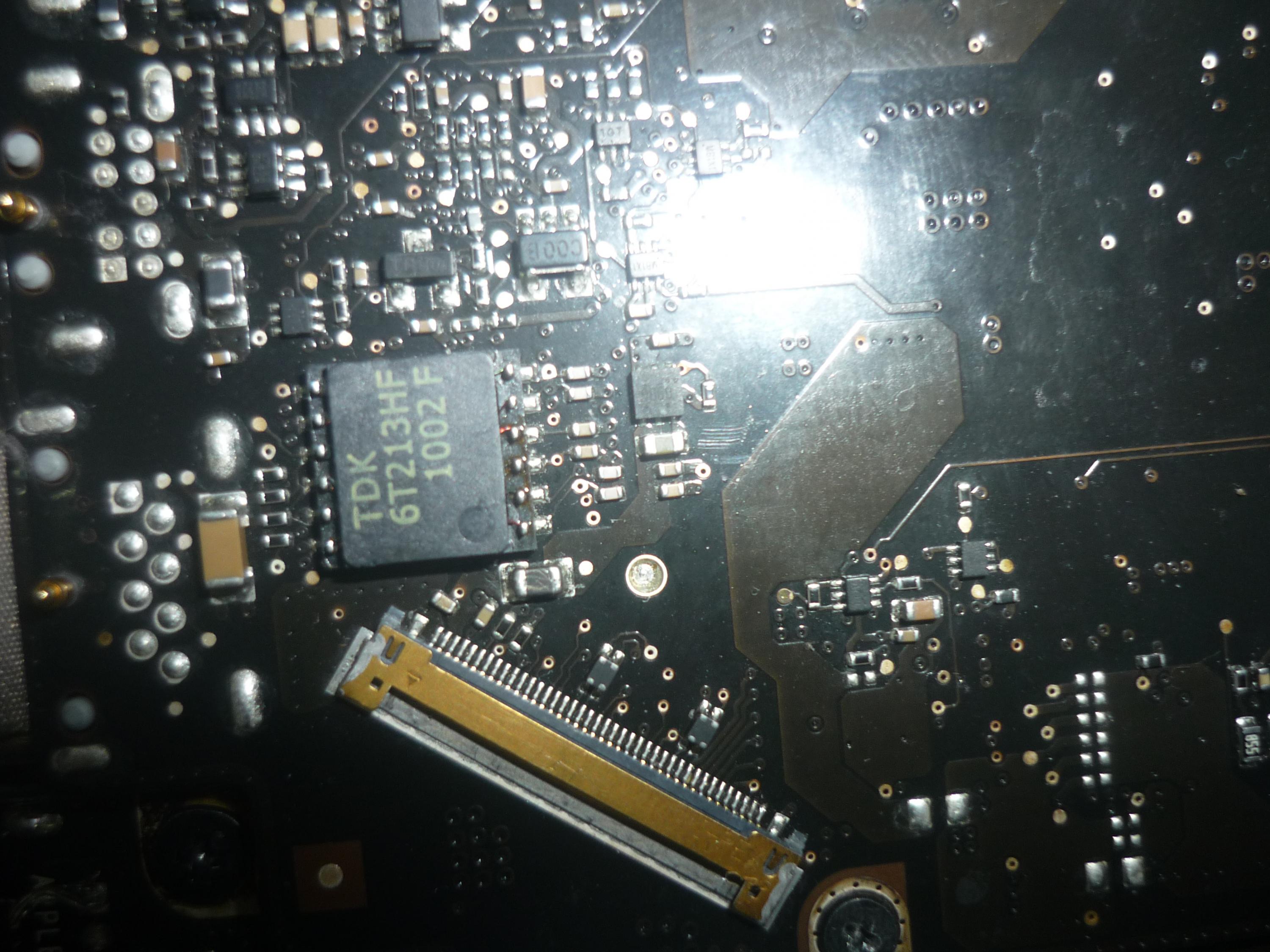

    this unit got display but no light change cable and led already but same .if somebody got schematic then thats very helpful ..............

    do you hear the "bong"? what macbook model is it?
    some old 2008 mac 15 suffer from graphics card problem and need reball

      yes i can hear the startup sound and also can see the display but the is only its dim i mean no back light

        first as in this video, check the fuses if are all ok.

          i can not see any fuses on motherboard for back light

            Re: apple mac book pro 15.4
            generally they are white or brown with a 0 on them.
              nothing like this on the motherboard
                  here is the picture
                    Usually they are located on the opposite side of the connector.
                      i checked already nothing is like this regarding led backlight.there are two fuses one for main supply and the other for gpu supply and both are ok
                        http://i151.photobucket.com/albums/s...DSC04144-1.jpg
                        that's the backlight fuse. check if you have voltage coming in and out when u power on your macbook.
                        i sayd that they are white or with a 0, but i mean whire or with a Dot on them, not 0.
                          this fuse is ok i found that the back light control ic is bad i think need to change it
