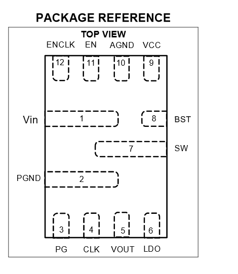

                I've replace the part, and it's still heat a lot. Do you know what can I check next? I dont have schematic.
                I've found 19v and 5v on the board.
                Replaced part is a 3.3v buck converter.

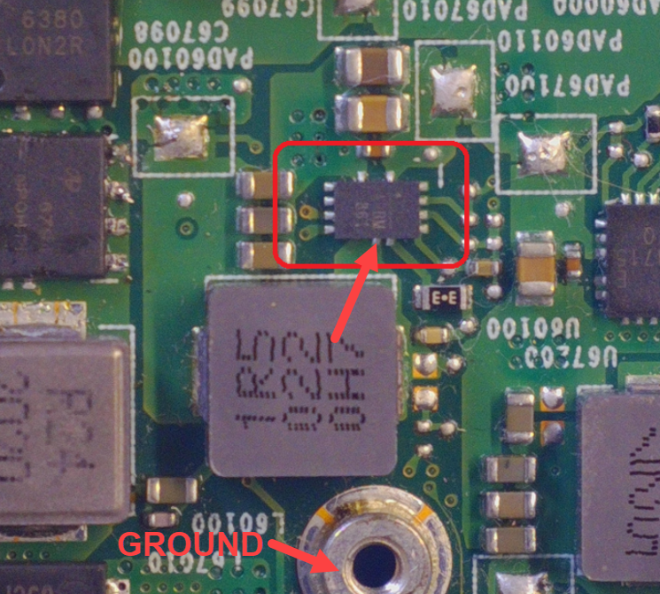

                  Remove all power. Meter in resistance mode.
                  Measure the resistance from the output of this switching regulator (see the red arrow) to ground (see other red arrow). What is the resistance in ohms?

                    This is what I got:

                          Iv'e done some voltage measurement, here is what I've got:
                          Vin = 19v
                          Vout = 0v
                          LDO = 0.9v
                          EN = 0.8v
                          VCC = 3.66v
                          BST = 3.5v
                          SW = 0v

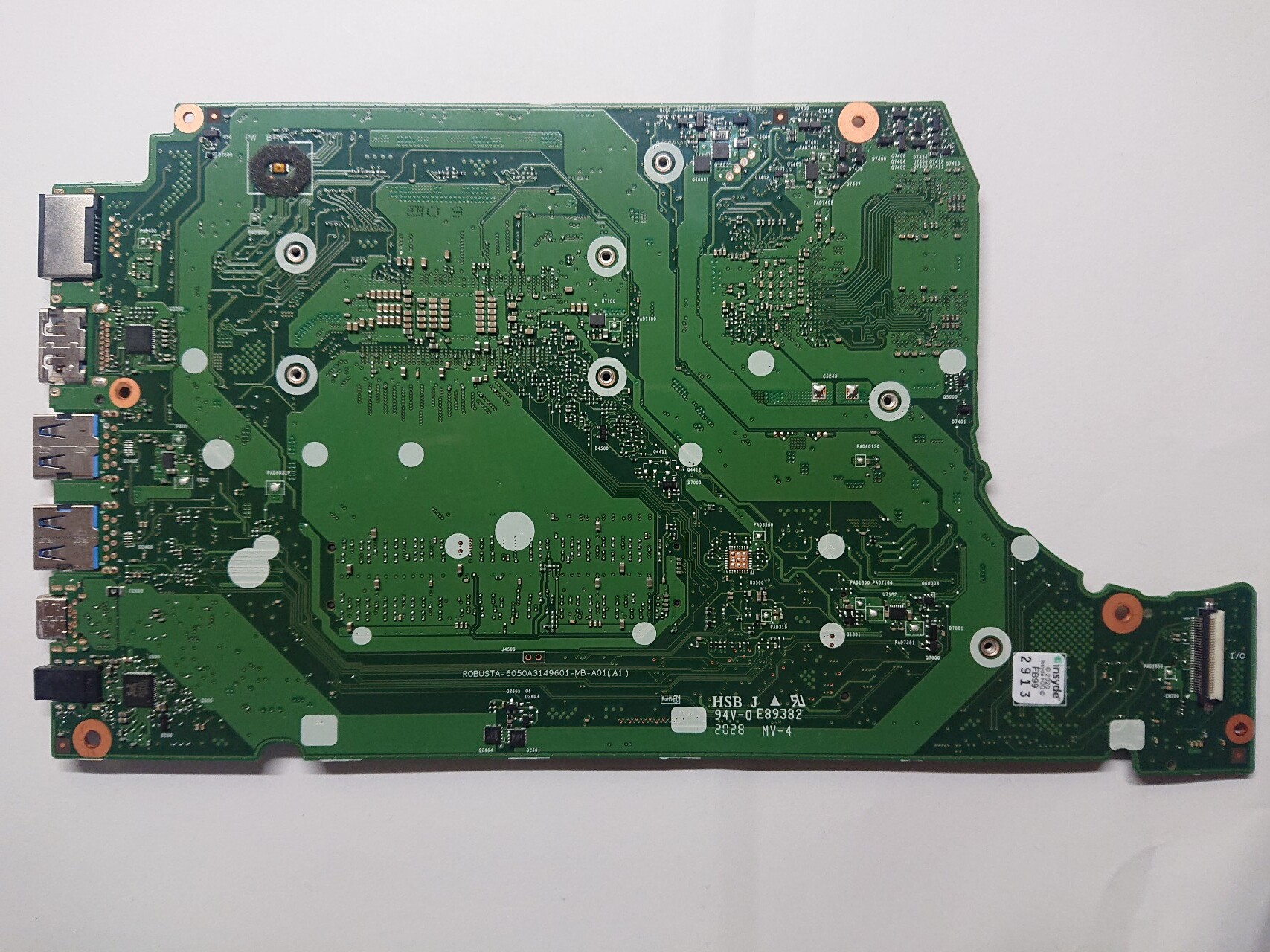

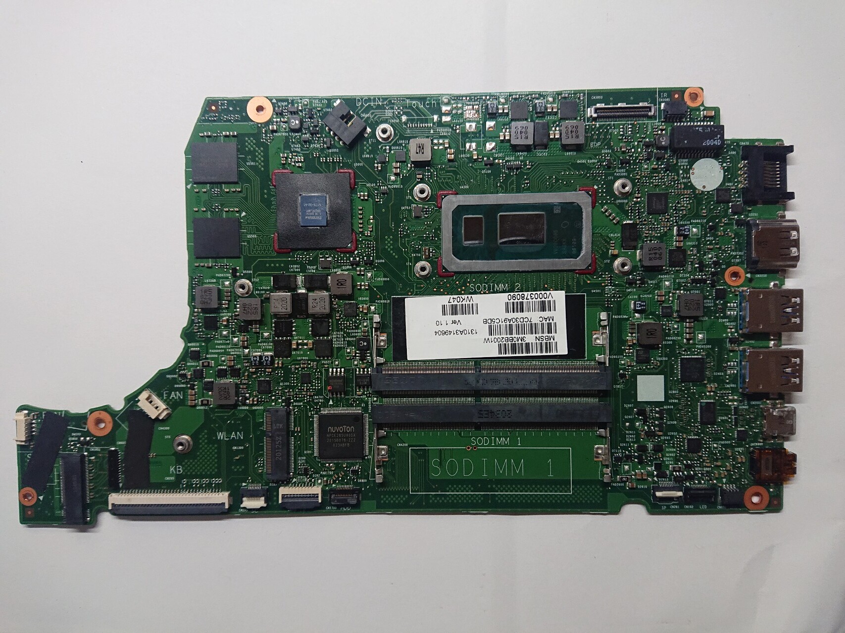

                          I've joined aswell motherboard photo.

                            The EN voltage is too low to enable the switching regulator inside this device. The signal needs to be a logic ‘1’ = ~ 3 volts to enable.

                              If it's too low, it can heat the buck converter?
                              • mon2
                                • Dec 2019
                                • 14737
                                With such a low enable voltage, the switching regulator will not enable. The resistance to ground at the output is not low enough to cause the immense heating of this regulator.
                                The other regulator is the LDO rail which appears to be a fixed ON low current regulator. Such regulators literally burn the high input voltage of 19v down to the target LDO voltage so it will heat up the part in the process. The output of the LDO rail does not appear to be shorted either yet the output LDO voltage is very low. The other thread mentions a short in the RTC (real time clock) but the resistance to ground of this LDO does not show a short condition.
                                The posted pic looks clean with respect to soldering. Do confirm again the resistance to ground of the LDO and the SW rails - with no power to the board.
