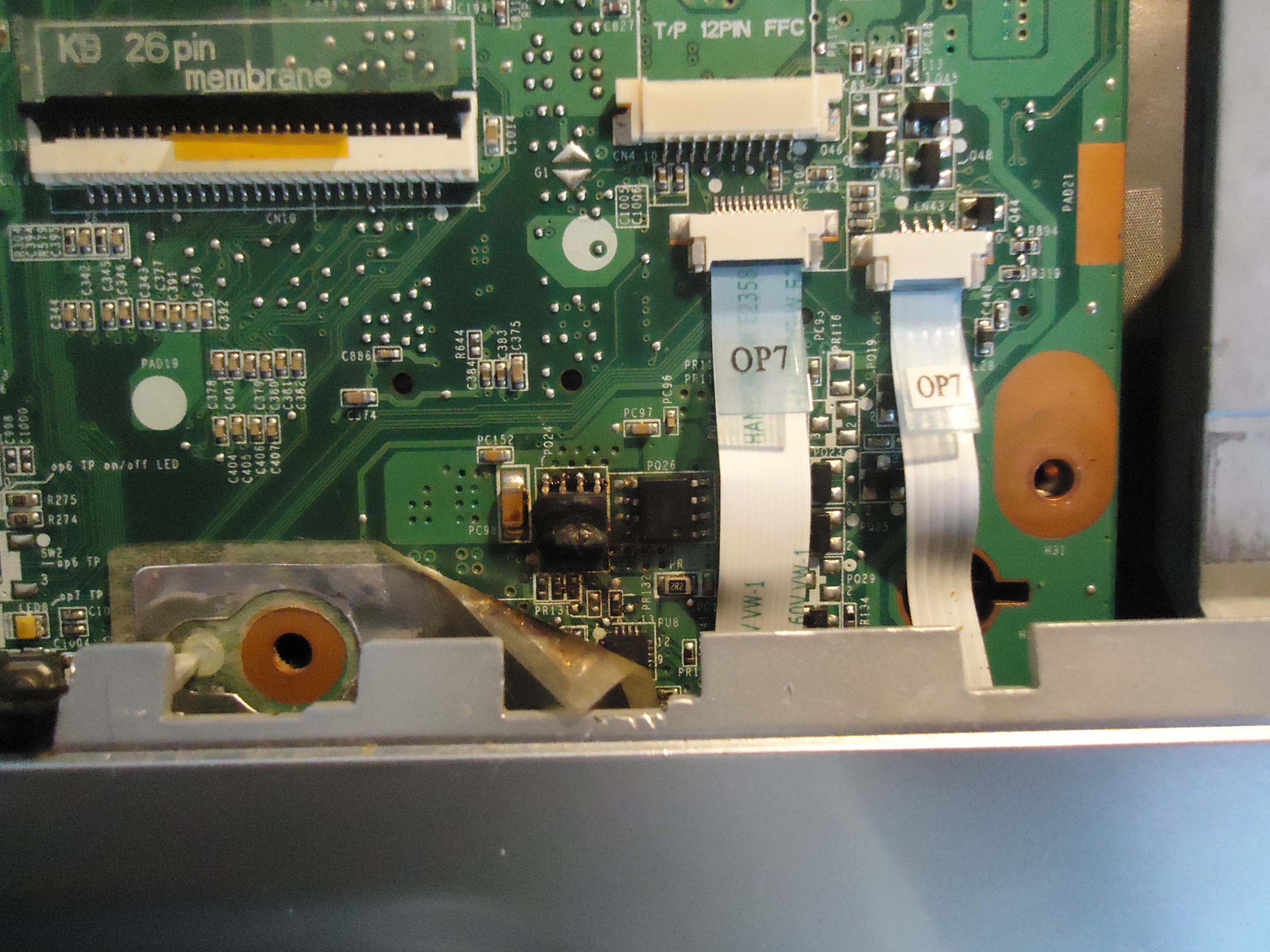

    Re: hp compaq cq71 caps/num lock blinking
    Yep it's the mb alright.
    Any help identifying PQ24?

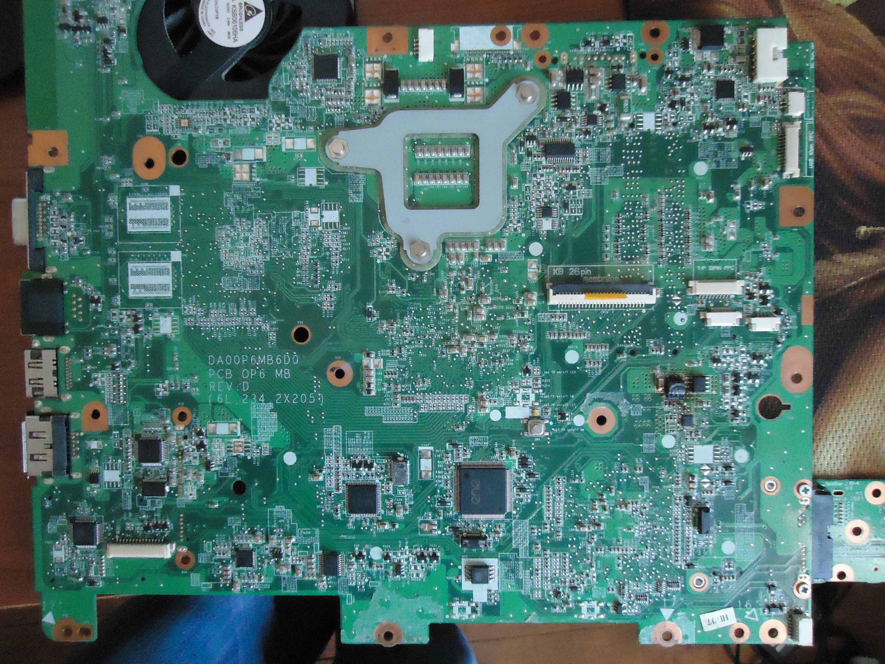

        I have searched but cant find one.
        Here is some pics of the mb.
        Thanks!
        DA00P6MB6D0
        PCB OP6 MB
        REV. D
        (6L. 234 2X205)
          pq24=AO4496
          good luck
            Thank you, much appreciated.
            Looking at the datasheet it's a N-channel mosfet, I do have AO4456 on a scrap mb. but the gate-source voltage is 12V, whereas the AO4496 is 20V.
              look on scrap mb for fds6676as
              (acer 5520 cpu power , asus , fujitsu)
