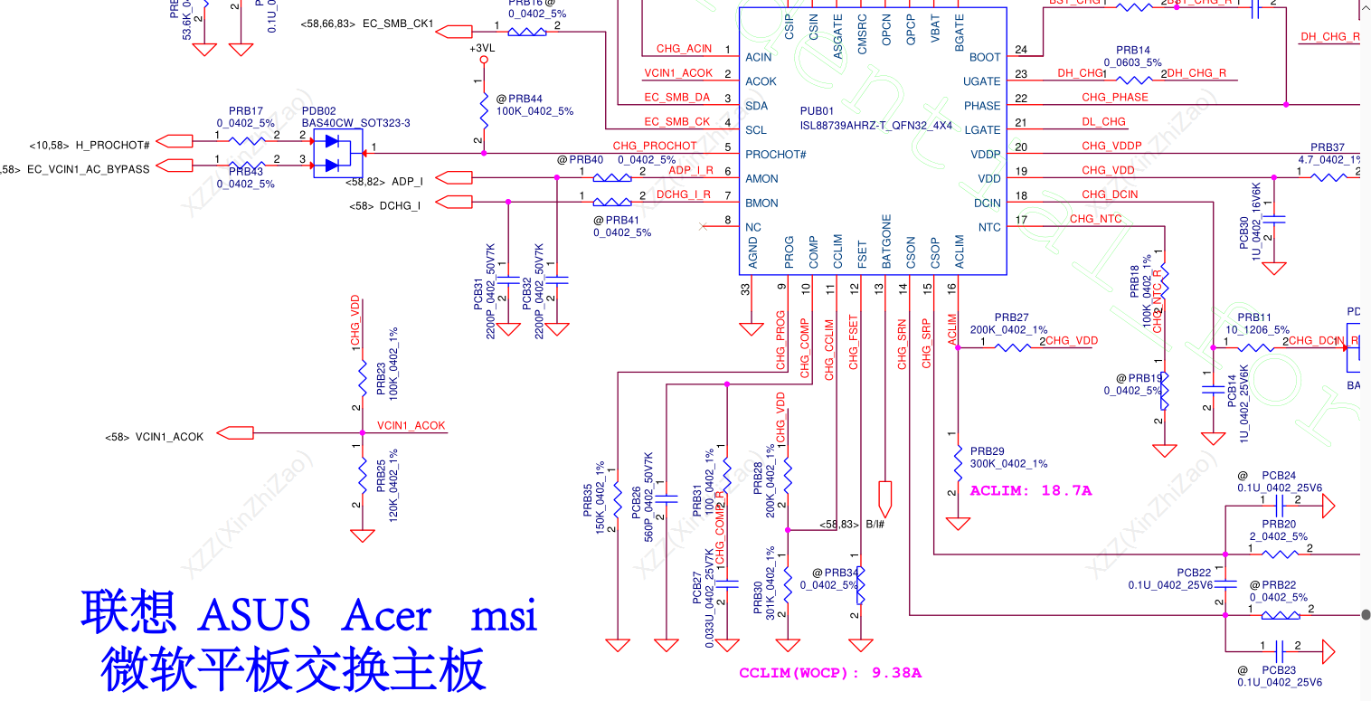

    Have laptop motherboard la-f841p with charging problem in power on mode.the laptop charges in off condition but when powered on it goes on battery mode and stops charging and gate voltages of the first and second MOSFET goes to 0v.
    Here is the link to the boardview plz help https://www.badcaps.net/filedata/fetch?id=2132131 as I can't find the schematic anywhere.

    Hi is your adapter recognised in bios?
    • mcplslg123
      • Jun 2015
      • 7262
      • india
      ADAPTER rating as per specs? If you use a underrated adapter,it wont work.
      Voltage on ADAPTER_ID?
      • tomodachi
        • Apr 2012
        • 610
        • Turkey
        Had exact same issue yesterday. Turned out to be a broken DC input jack pins were shorted inside(ID and 19V)
        Replaced it and problem solved.

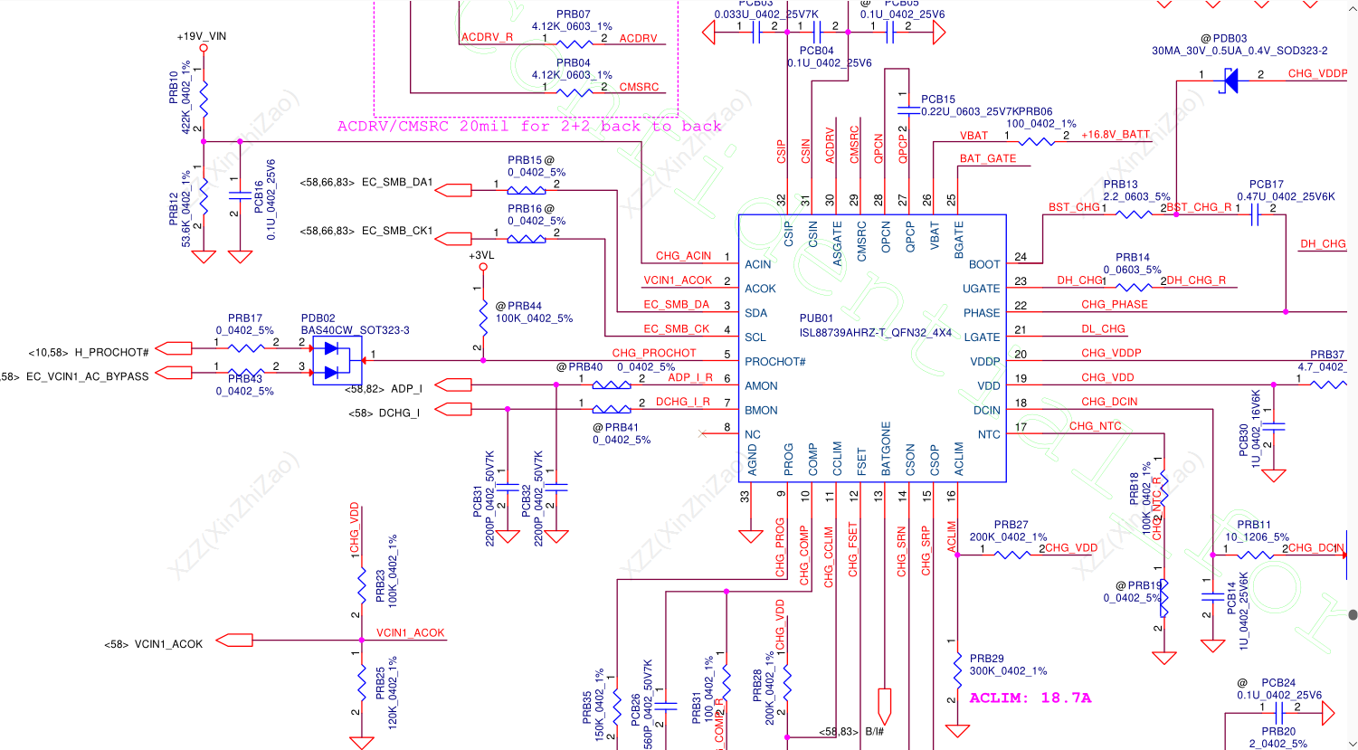

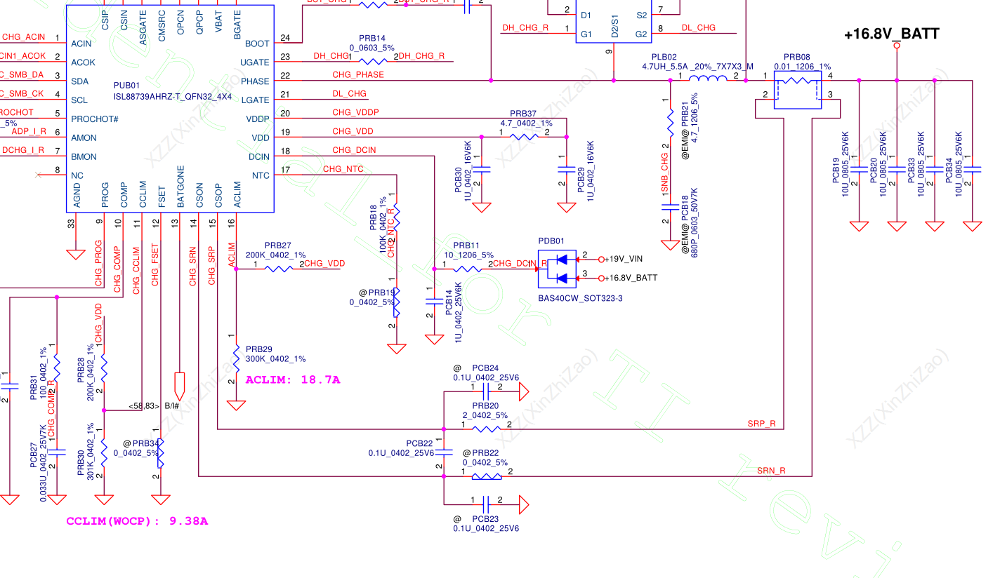

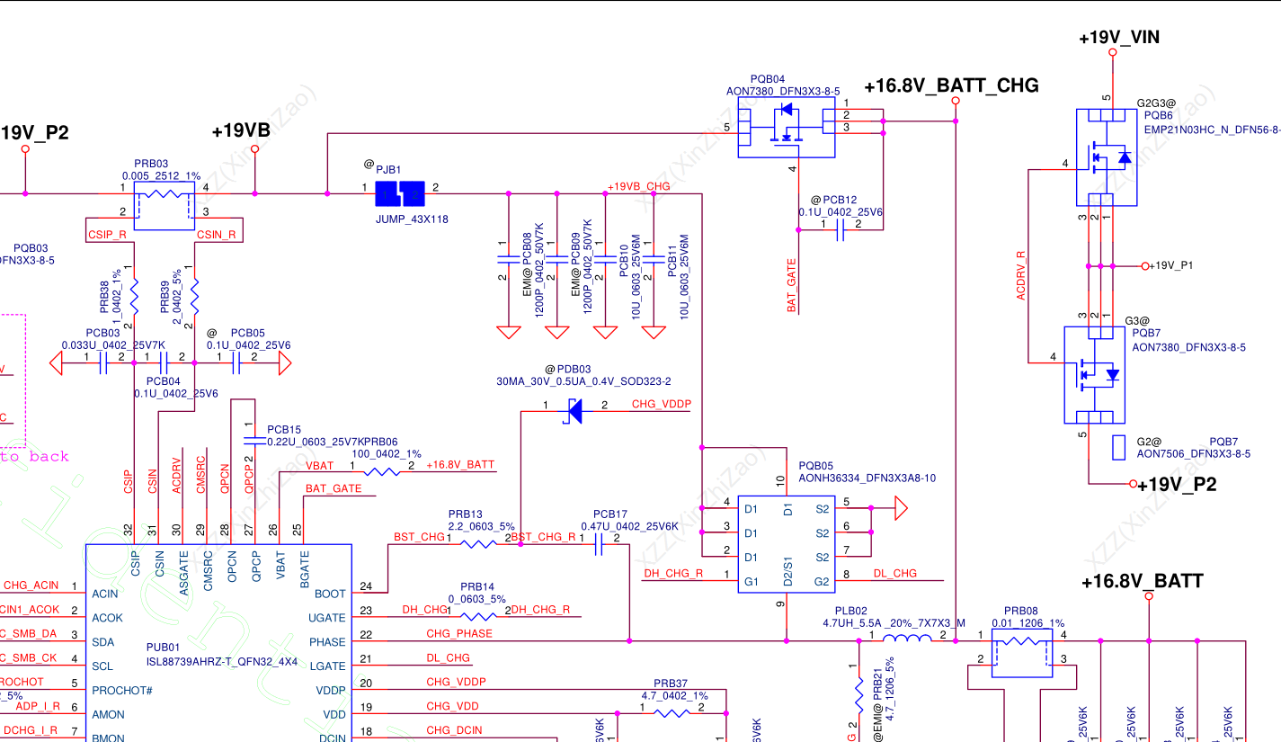

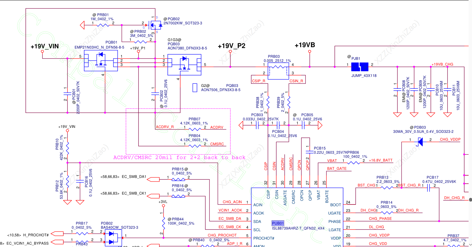

        • mon2
          • Dec 2019
          • 14662
          Attached.

          • ahmarzo
            • Mar 2015
            • 173
            • india
            thank you very much my problem got solved it as indeed adapter id problem i changed two 10k resistor on adapter id line and the laptop s charging fine now .thanks everybody
