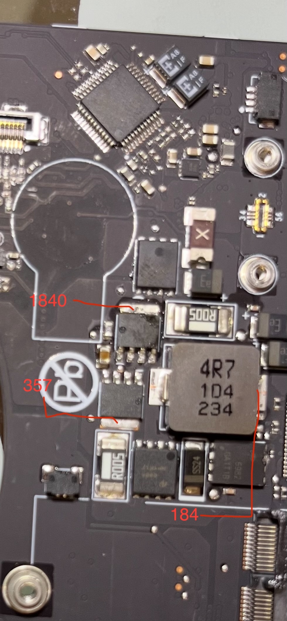

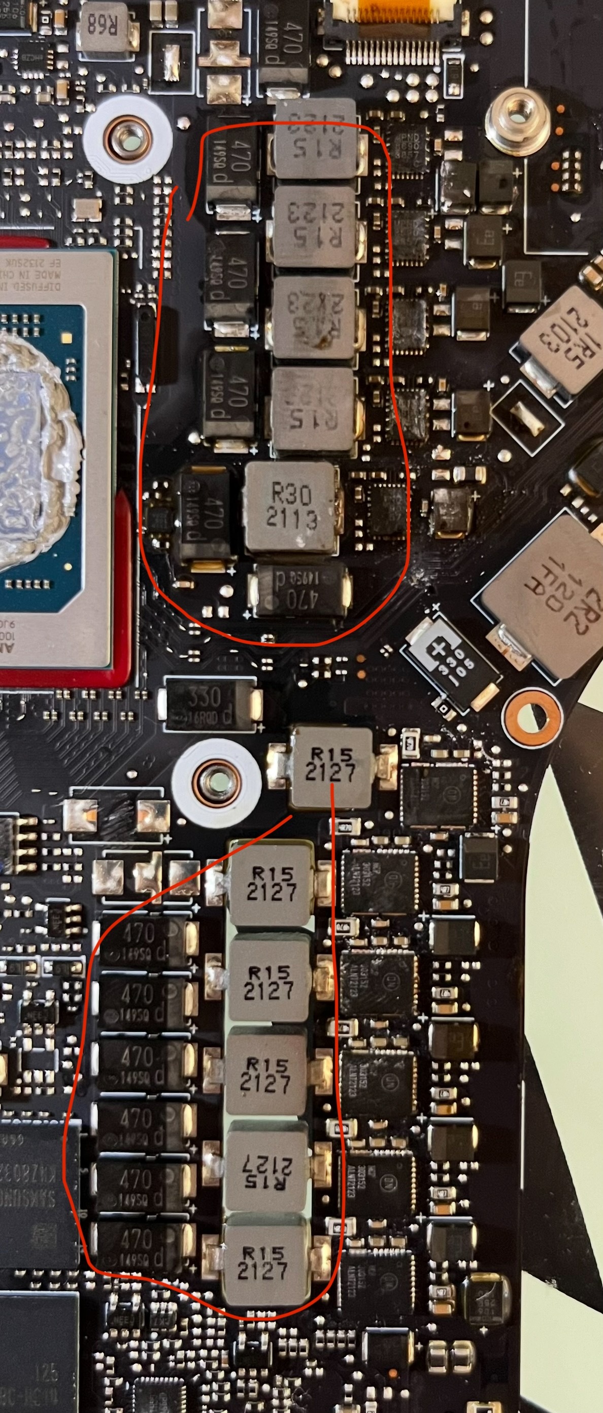

    Hello everyone, I got a razer blade from 2021 that had some liquid damage. As there is not board view or schematic available I'll need your help please.
    Here is what I saw :
    There is not much corrosion visible on the board.
    Measurements seems ok for power supply I got the 19V. I'll provide diode measurements for the mosfets and fuses near power supply.
    All the components outlined in red are short-circuited (R30, R15 and inductances)
    What should I look next ?
