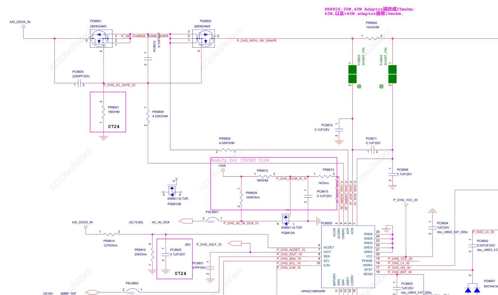

    Hi, I have this Asus F555L that suddenly died. No charging led when connected to a working charger. Motherboard is X555LD rev. 3.3. I already tested the input voltage and all looks good, 19v is present. Any hint? I'm also looking for schematics and boardview. Thanks in advance.
    See attached. Measure the voltage to ground on each of the DCin mosfets PQ8801 / PQ8802.
    Confirm the charger IC has a voltage of 6 volts on REGN.

      PQ8801
      pin 1-2-3 19v
      pin 4 no reading
      pin 5-6-7-8 19v
      PQ8802
      pin 1-2-3 19v
      pin 4 no reading
      pin 5-6-7-8 19v

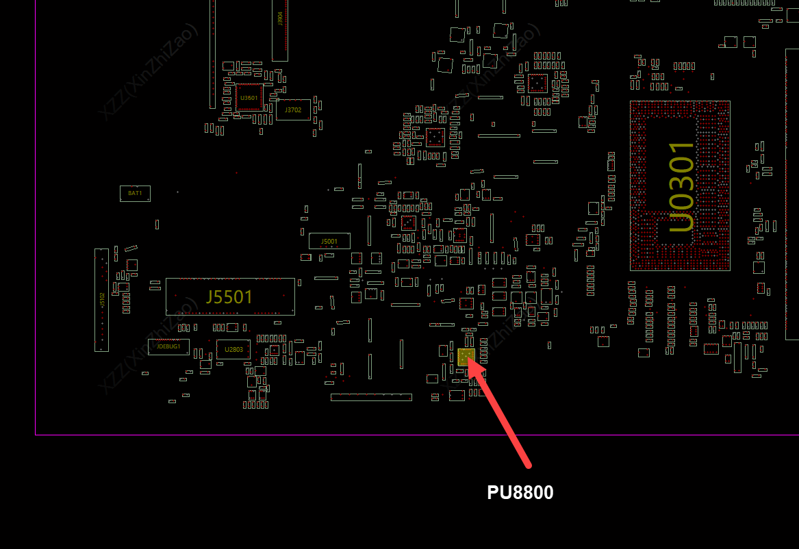

      where is charger ic located?

        maybe it's helpful information:
        while connected to the original charger,the ic I marked with an arrow is burning hot, I almost hurt myself.
        the capacitors near this ic are not shorted.

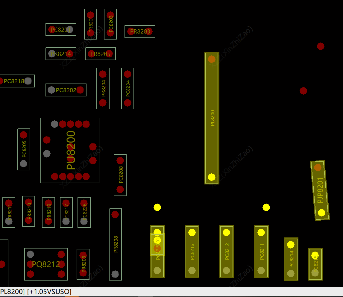

          Attached. Measure the resistance to ground of the large power inductor PL8200.
          Click image for larger version  Name:	PL8200.png Views:	0 Size:	57.8 KB ID:	3315673
          Click image for larger version  Name:	charger_ic.png Views:	0 Size:	62.0 KB ID:	3315664
            [QUOTE=mon2;n3315663]Attached. Measure the resistance to ground of the large power inductor PL8200.
            1,37 kohm on both sides
              [QUOTE=mon2;n3315631]See attached. Measure the voltage to ground on each of the DCin mosfets PQ8801 / PQ8802.
              2,5 volt
                [QUOTE=vpower;n3315681]
                2,5 volt
                sorry, pin 16 of PU8800 is 6volts
