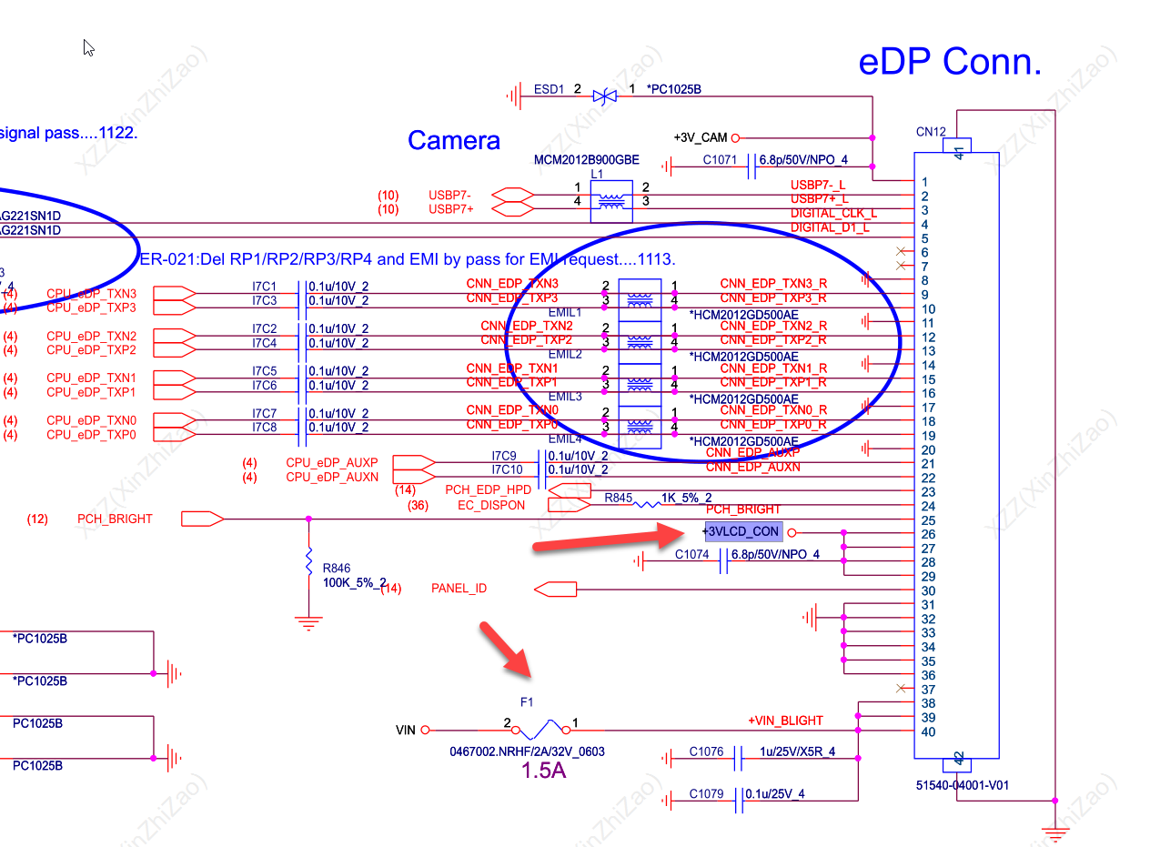

    We've got Asus FX506L no display, laptop previously has been in other repair store, problem was with cracked screen however we believe som1 didn't disconnect battery or connected incorrect screen. Since then there is no display, only on the HDMI.
    Board model DABKXDMB8F0 REV:F
    There are no signs of backlight

    Check the voltage to the LCD; check the fuse voltage for the backlight.
