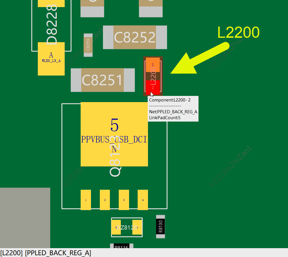

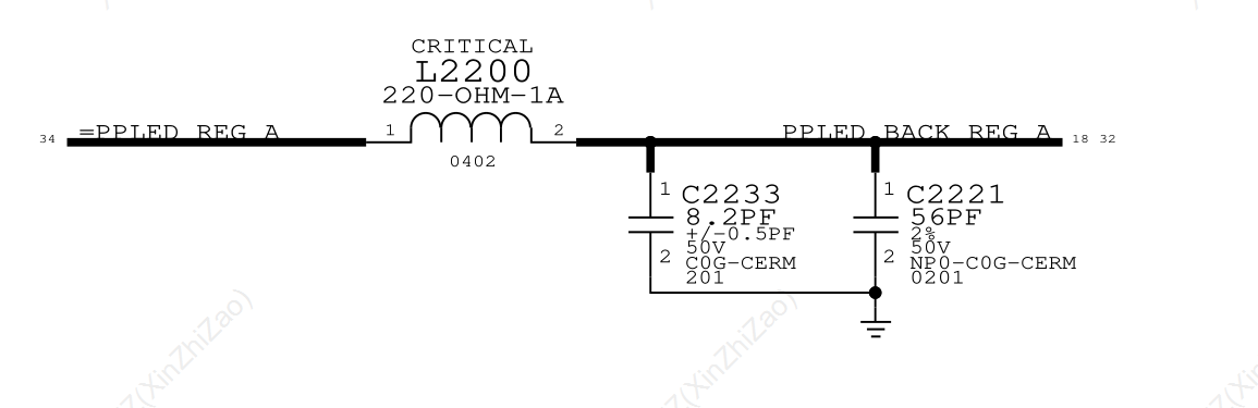

    Can anybody pinpoint the backlight filter for me on this board. Thanks Michael
  • mon2
    • Dec 2019
    • 14340
    L2200 - see attached.

      What that bites, that one looks good. When iPad plugged into amp meter I get 5v at .95amps. Must have something else going on.

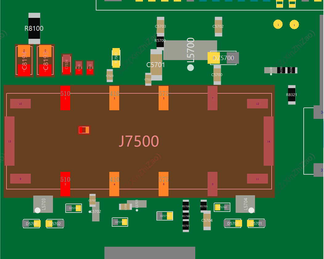

          I am getting 4.3v at 1.4a as soon as plug in. Should I have some components to the right of the battery connector. There are two spots empty. Click image for larger version  Name:	IMG_2974.jpg Views:	0 Size:	4.59 MB ID:	3299973
          • mon2
            • Dec 2019
            • 14340
            Not at my desk so will check against board view tomorrow but a hefty immediate current draw often means a shorted part. Remove all power. Check the resistance to ground of the power rails starting at the input lightning connector.

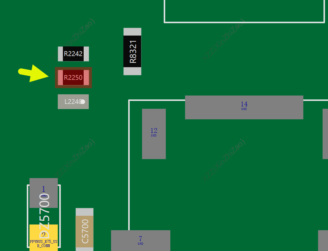

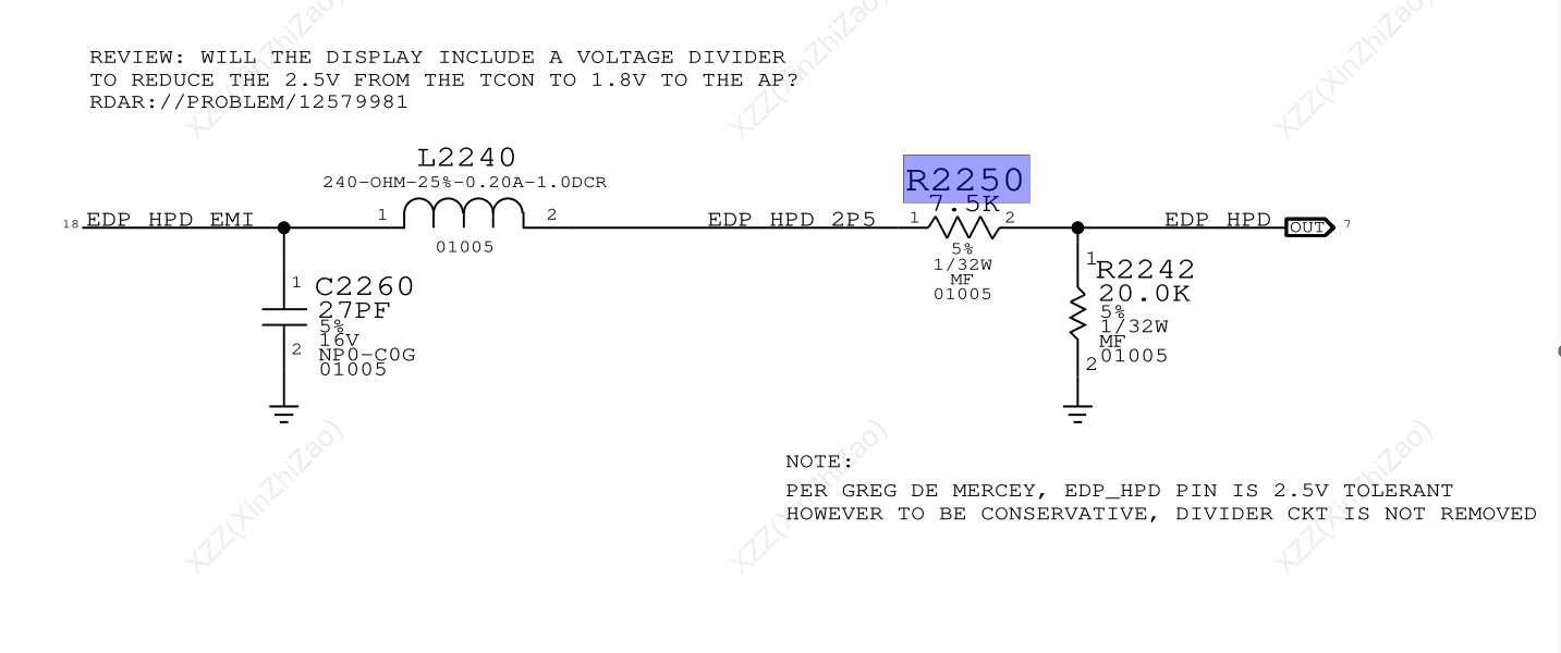

              See attached. Is the parts placement similar to this bv? Can you identify the missing parts references?
              • Hornnumb2
                • Feb 2011
                • 210
                Yeah looks like its the resistor just to the right top tip of the battery connector. They are just turned the other orientation R2250, that missing resistor should effect anything. Right. Will do some short checking. Thanks

                  See attached. NB: This is the WIFI only version of the iPAD.
                  Click image for larger version  Name:	R2250_bv1.png Views:	0 Size:	31.5 KB ID:	3300352
                  Click image for larger versionName:	R2250_schematic.pngViews:	0Size:	92.3 KBID:	3300351
