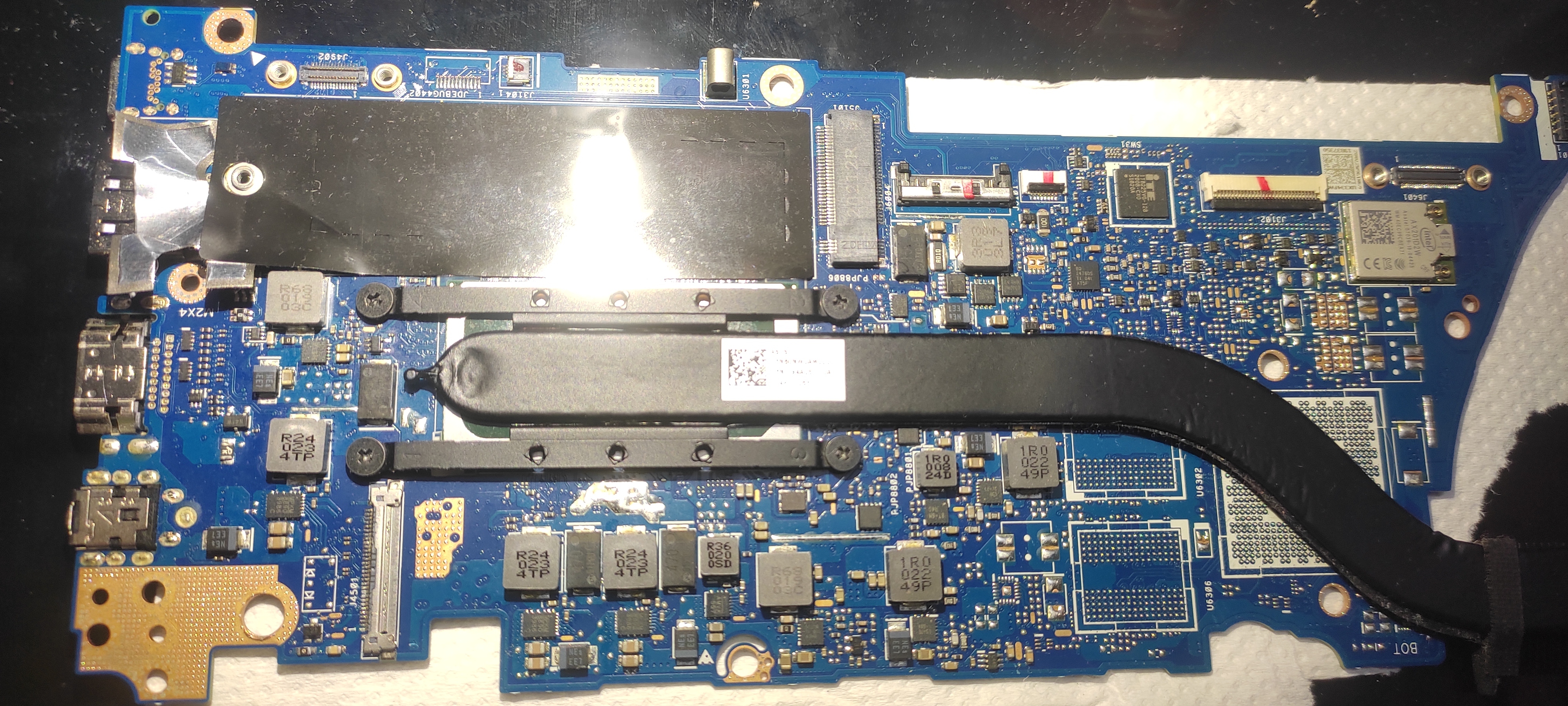

    -Laptop fell from the table.
    -Motherboard -seems- intact.
    -It turns on kinda normal but NO DISPLAY, NO BACKLIGHT.

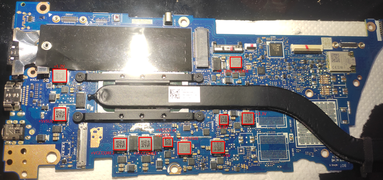

    I'm not too familiar with ASUS laptops yet. I'm using a similar laptop model Boardview. (UX333FN REV2.0)
    I feel there might be something wrong with these coil impedance values yet the voltage values go normal.
    COIL = VOLTAGES (adapter powered) = IMPEDANCE TO GND (off and unplugged)
    +VCCSA = 1.0V = 22ohm
    +VCCCORE1 = 0.8V = 3.5ohm
    +VCCCORE2 = 0.8V = 3.5ohm
    +1.05VSUS = 1.05V = 59.ohm
    +1.2V = 1.2V = High-fast fluctuations (weird)?
    +1.8VSUS = 1.8V = 27.3k ohm
    +3VA_DSW = 3.3V = 31.5k ohm
    +5V = 5.1V = 22k ohm
    +5VSUS = 0V = 6ohm
    P_CHG_RSENS_SHAPE = 0.28v = 500k ohm
    +VCCGT = NC = NC
    +1.3VSG = NC = NC
    +1.2V seems to have a -stable-voltage-value meassuring with multimeter but in resistance mode it just goes crazy.
    +5VSUS missing.
    Boardview seems to be in some $ites. If anyone has it would appreciate if can share. Thanks in advance!

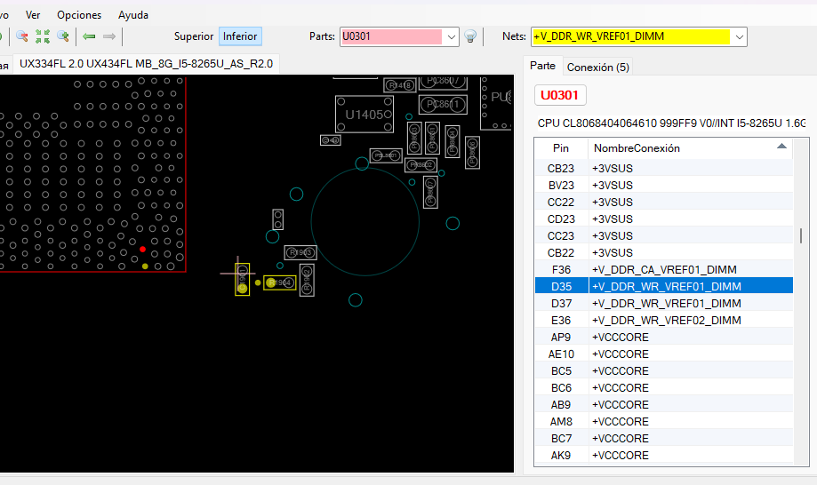

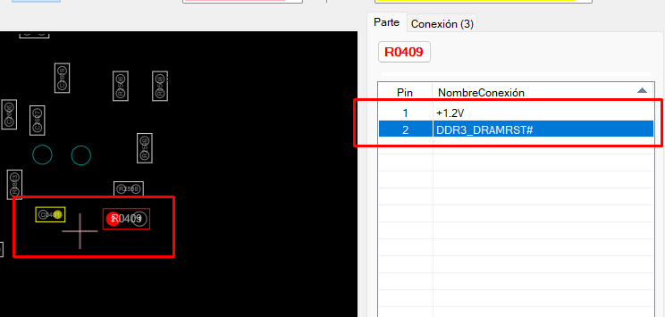

                            In this post about UX330UAR rev 2.1 no DISPLAY, DRAMRST# is missing. I tracked the line and it comes from the +1.2V through a Resistor which I don't know the value because the BV doesn't show.
                            My DRAMRST# could be similar. I'm using this BV UX334FL 2.0.
                            • gjgib
                              • Nov 2022
                              • 70
                              • Venezuela
                              Here I found something with different name that looks just like the line I've shown above.
                              ​Line +V_DDR_WR_VREF01_DIMM has 0.6V.

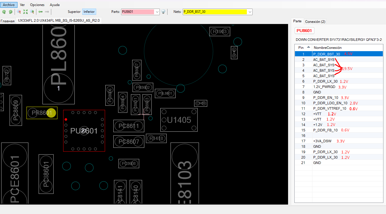

                                Also meassured the RAM IC, don't seem to have any wrong values but the pin10-(P_DDR_LDO_EN_10) seems weird to me, maybe I'm wrong since it's a LDO Voltage. (Voltages in image, also)
                                • gjgib
                                  • Nov 2022
                                  • 70
                                  • Venezuela

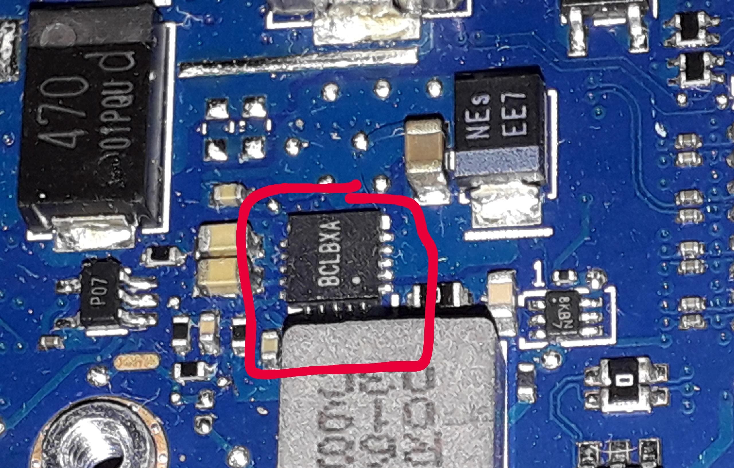

                                  Couldn't find the RAM-IC anywhere. This is its inscription.
                                  Click image for larger version  Name:	Sin título.jpg Views:	0 Size:	557.3 KB ID:	3302606
                                  Marks: BCLBXA.
                                  Boardview calls it: DOWN CONVERTER SYV731RAC//SILERGY QFN3*3-20
                                  Btw, I know it kinda varies from IC to IC, but are these rails voltages usually around these values?
                                  'BST' (4.5V)?
                                  'P_DDR_LDO_EN_10' (2.8V)? Is this LDO ENable enough to be enabled/enabling?
                                  'P_DDR_VTTREF_10' (0.6V)?
                                  'P_DDR_FB_10' (0.6)?
                                  I started seeing these voltages recent ago with some Charger ICs. Yet to fully understand them.
                                  Are REFerence and FeedBack voltages half of the ouput value of the IC?
                                  • mcplslg123
                                    • Jun 2015
                                    • 7262
                                    • india
                                    These voltages seems ok to me. Feedback,EN LDO voltages dependes on the resistor value and pull up value.
