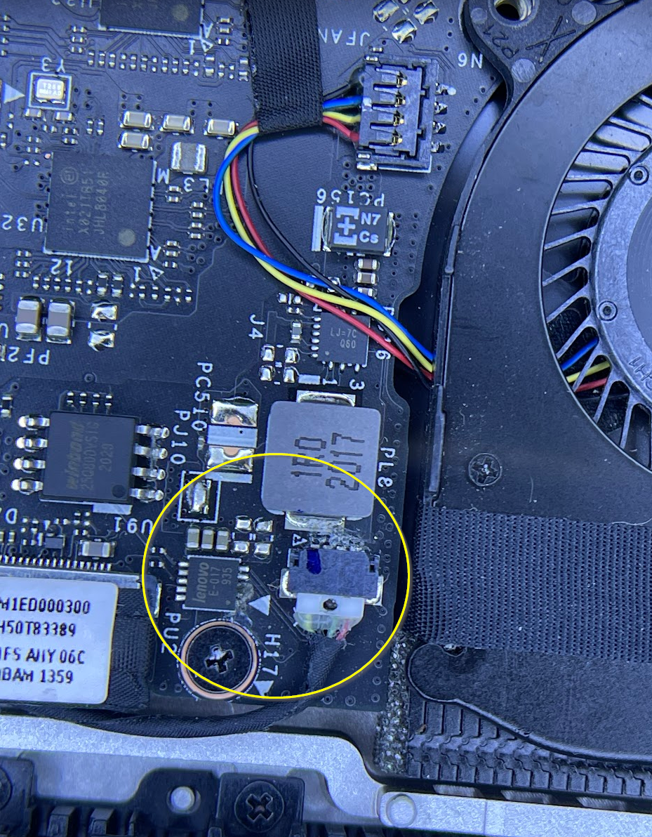

    I've got this laptop here which is presenting very odd behavior. It works perfectly fine except every morning, it won't power up. Power button does nothing. Reset button on bottom also doesn't seem to have any effect, but if I disconnect the battery, hold the power button for a few seconds to drain capacitance, when I connect the battery back, I can power on. It will go through RAM training as normal, and eventually boot into Windows. The laptop will work fine all day long, but the next morning - the problem is there again.

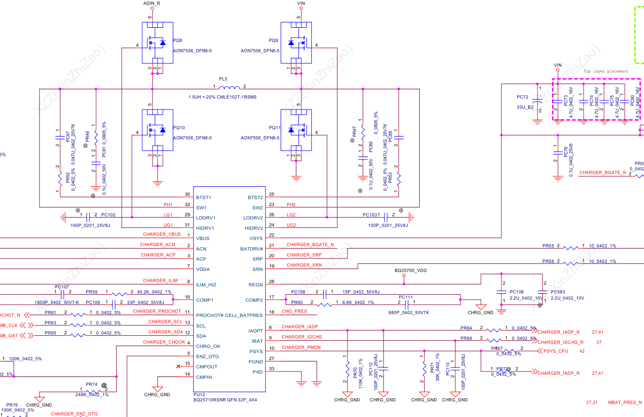

        Carefully measure the voltage to ground of CHARGER_CHGOK (pin # 4) on the charger IC @ PU12 with the power adapter connected (no battery).

              You wouldn't happen to have a boardview or schematic for this board would you? I'm trying to locate PU12. While I was looking for PU12, I noticed this @ PU2 (see attached) Also, liquid damage @ U17.

                No BV. Yup, always always always start with a visual inspection. That is rule #1 on Rossmann videos. That cat puke / urine needs to be cleaned up with IPA.
                PU12 = BQ25710RSNR QFN 32P_4X4​

                  Hey, thank you so much! So, to update you, after I repaired the liquid damage and re-flowed a couple of components, the laptop is working correctly and the fault has gone. Cheers!
