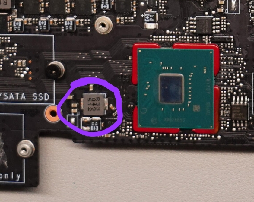

                  • Sephir0th
                    • Oct 2020
                    • 1283
                    The actual +1.05V supply is more likely located here.

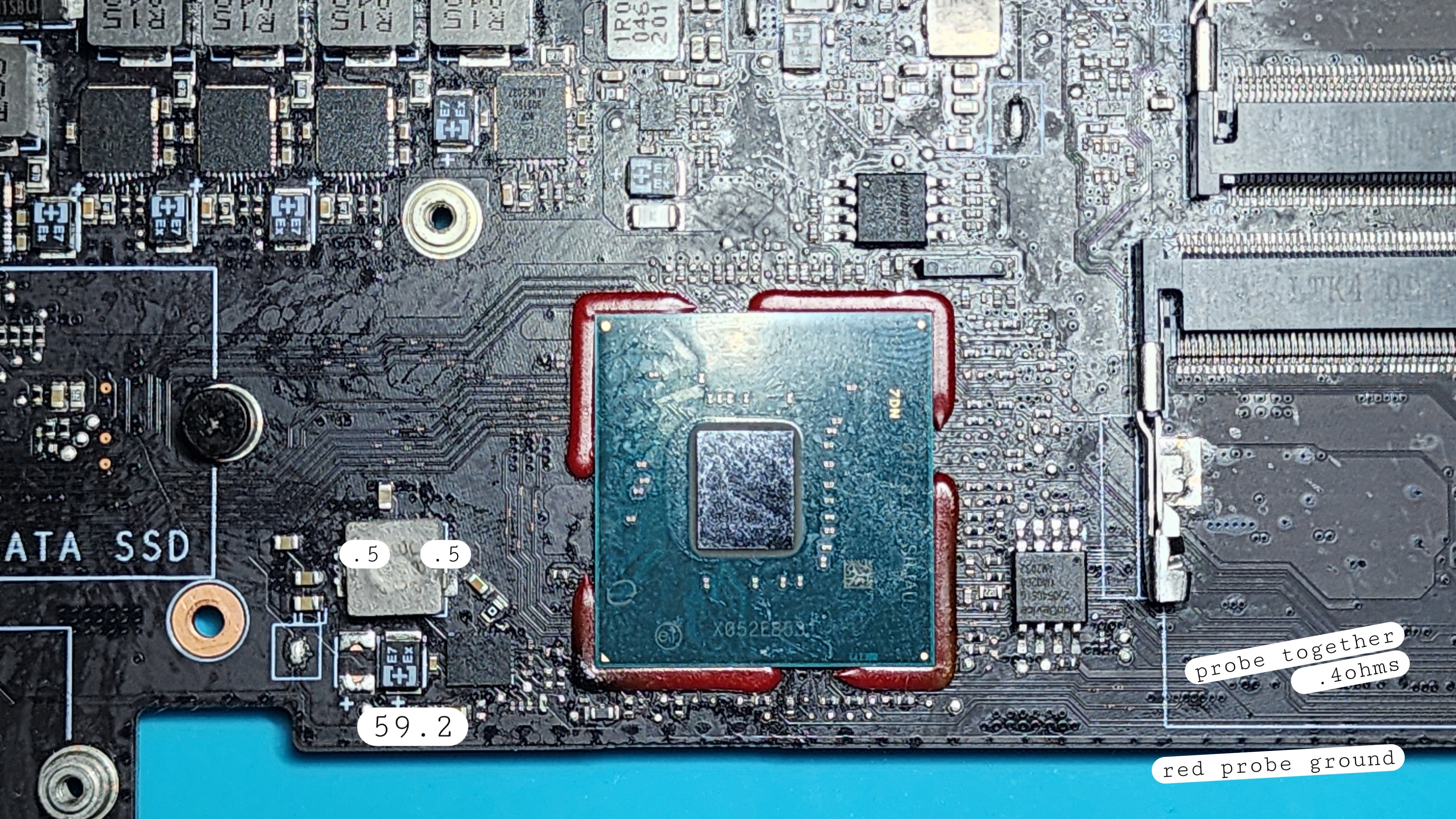

                      I do believe i was getting 19v there when the laptop was working with one bad memory module slot. I measure what kind of volt on the other spots where i got my readings and that where i got the 19v , 5v , 3v and 1v . But yeah i understand why thats the power supply for pch vcore , like all the caps by the gpu and cpu v cores.
                      I did some more digging and a few more chips were bad - Parade PS8461E (diplay) , P13DPX (display mux switch). I order these chips and will get here in few weeks from China.
                      Resistance read red on gnd
                      19v - 3.4k and climb slow
                      5v - 990 ohm
                      3v - 310 ohm
                      1v - 362 ohm
                      Cap by pch - 3.4k and climb slow

                        • Sephir0th
                          • Oct 2020
                          • 1283
                          Originally posted by chickenhawk88
                          I tried looking at your YouTube link and dosent work, what happened ? Thanks again, i hope i can get this working somehow.
                          Thanks for heads-up. Link is fixed. Unfortunately 310 Ohms is still to low for 3VALW.

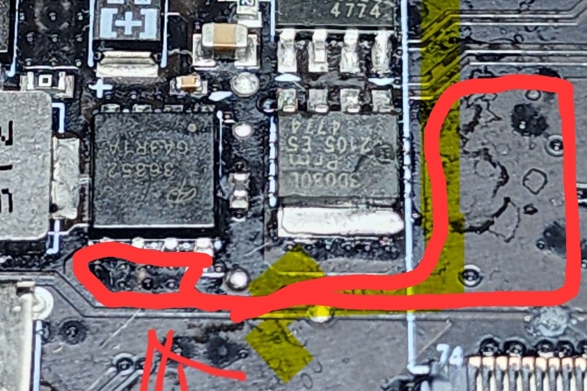

                              • Sephir0th
                                • Oct 2020
                                • 1283
                                This is likely not the Main Power Rail in what you're injecting, but the Dual-Mosfet related battery charging rail. So in worst case, you are injecting into the GND plane. Surprise, surprise, the board will take the whole 1 Amp then.
                                The DC-IN Mosfets are located on the right. The current sense resistor for main power rail is on the back. Next time you use your multimeter to proof please before blindly injecting somewhere what you might regret afterwards.
                                Either way, the observation after you remlved the Dual-Mosfet makes no sense, since at least the GND pads would take the current. So i assume you have additionally issues to get proper GND for your PSU.
                                Also I think I've spottrd that you lost already a important resistor at the bottom of this Mosfet.

                                  Is the way the dual mosfet work is if there was something wrong with the circuit that it would sink it to ground thus protecting the circuit? So when I remove the mosfet and I checked each leg and none had a direct short to ground. I checked my earlier pictures , although kinda hard to see I don't see the missing resistor.
                                  What do you mean proper GND for my PSU ? My bench power supply is plugged into a power strip, and that is into outlet. None of the ground pins are broken off. I'll look around to see if anyone has picture of the motherboard area.

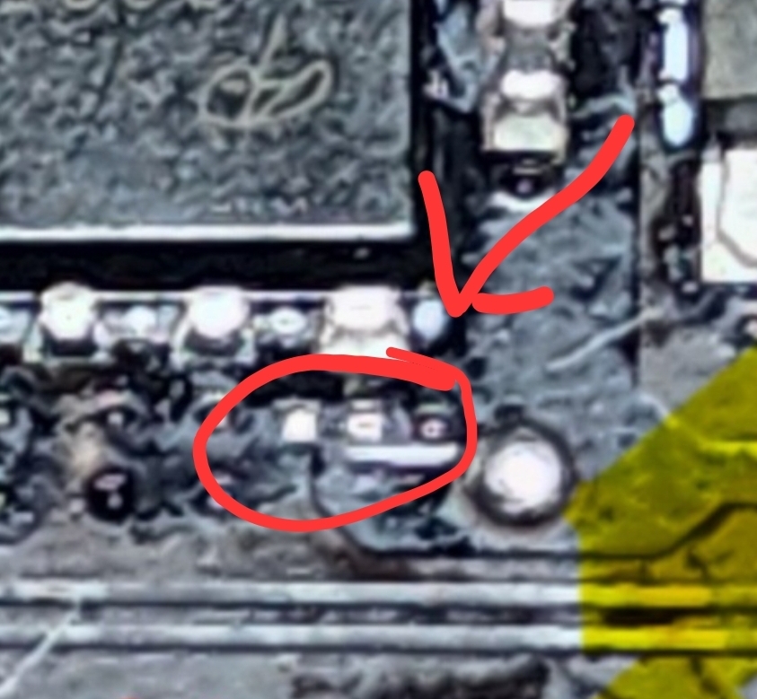

                                  • Sephir0th
                                    • Oct 2020
                                    • 1283
                                    You don't need to be rocket scientist to understand that the bottom Pads are the GND plane, so no, it is not the way how the Mosfet behaves in your case. You simply did not connect the GND probe of the PSU properly. A small but serious mistake, especially when you start forming conclusions on this base.
                                    From my understanding there is clearly a small component missing (circled). However we will ignore it for now since you have so much to do, that we will need months to get some sort of final diagnose anyway.
                                    instead and since you're still running in circles caused by doing the wrong things in the wrong sections strongly suggest to start over, especially with the Main power rail and try to bring it backnto life.
                                    But this requires that you take a look to the Charging controller now and in best case, measure voltages and resistance to GND of all pins.
