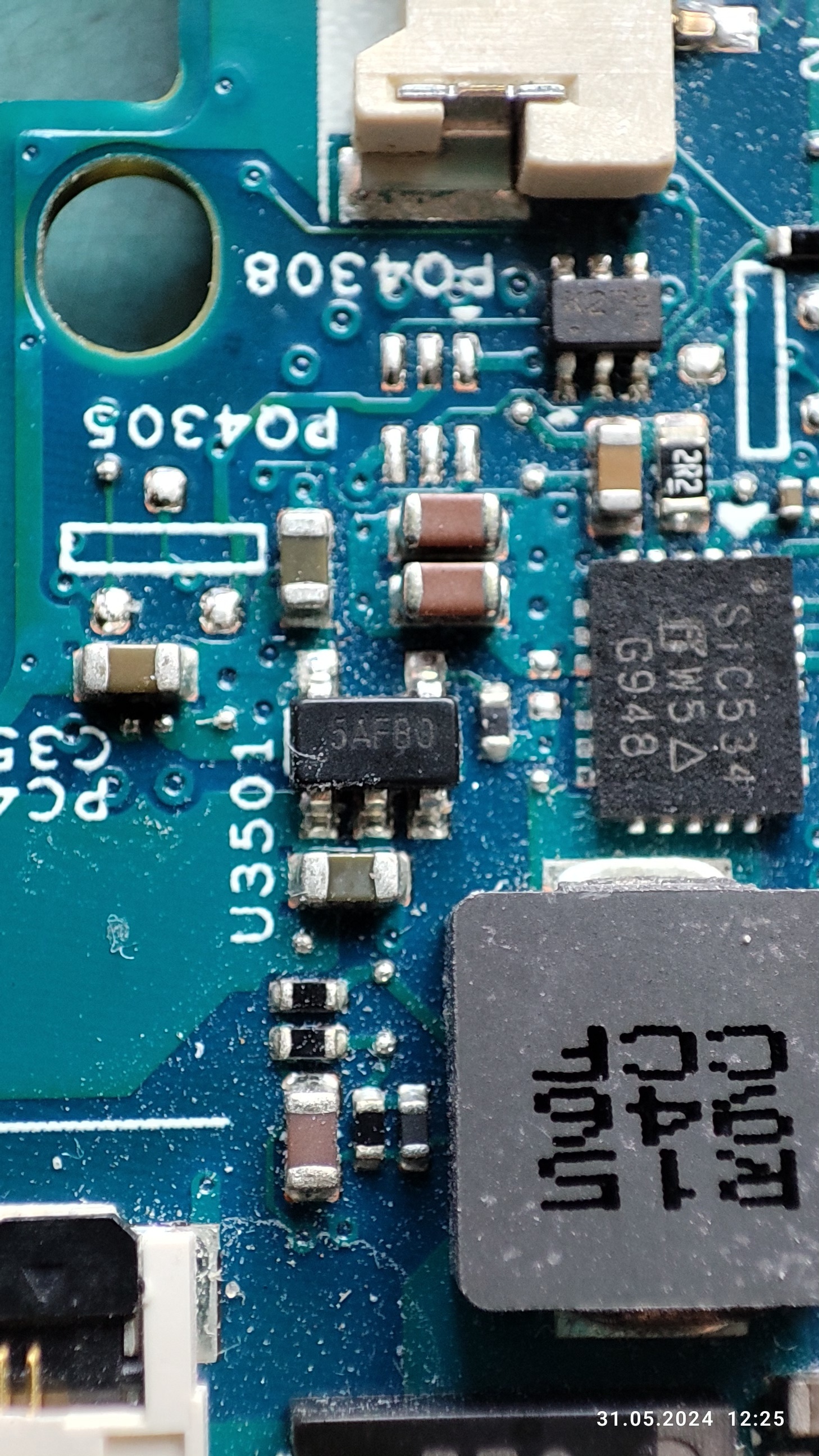

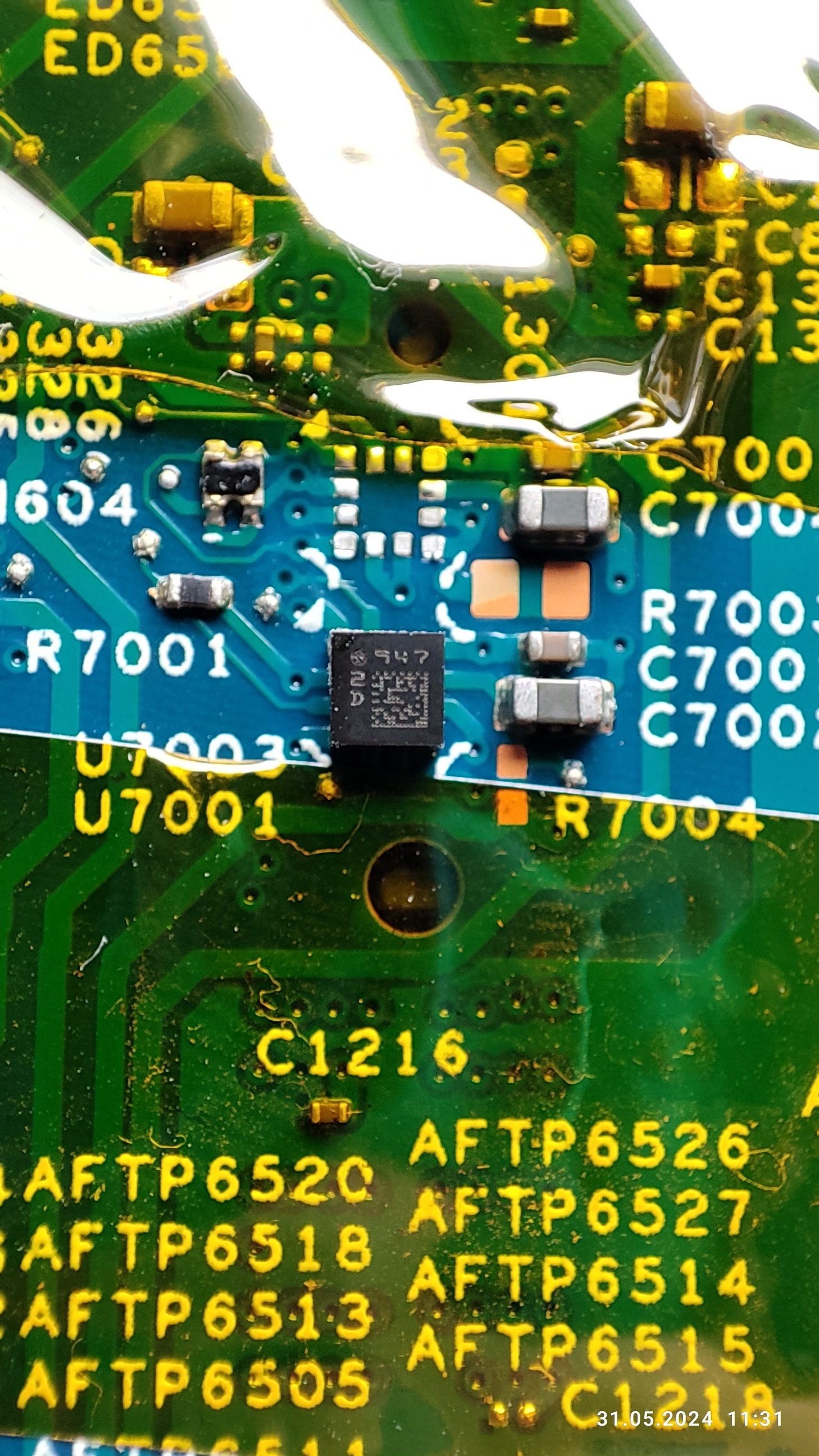

    I am looking for two ics on this mb:
    1st marked 947 and secound sot23-5 marked 5af8b
    thanks and regards

    sot23-5 G517F2T11U

      Originally posted by thunderleg12
      1st marked 947
      It looks like some sort of accelerometer or sensor made by ST Micro .https://www.aliexpress.com/item/1005004420444498.html
      The QR code isn`t recognised by any of the online QR scanners i`ve tried. 947 is the year and week code afaik,so 2019 week 47 ,don`t know what the 2D is.
      If you look at some of the newest HP schematics you might be able to find out exactly what it is,if any have this same part.​

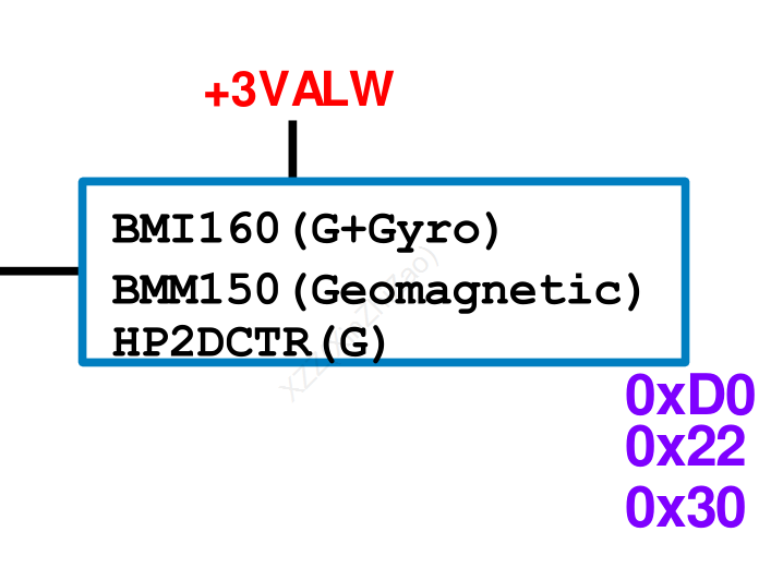

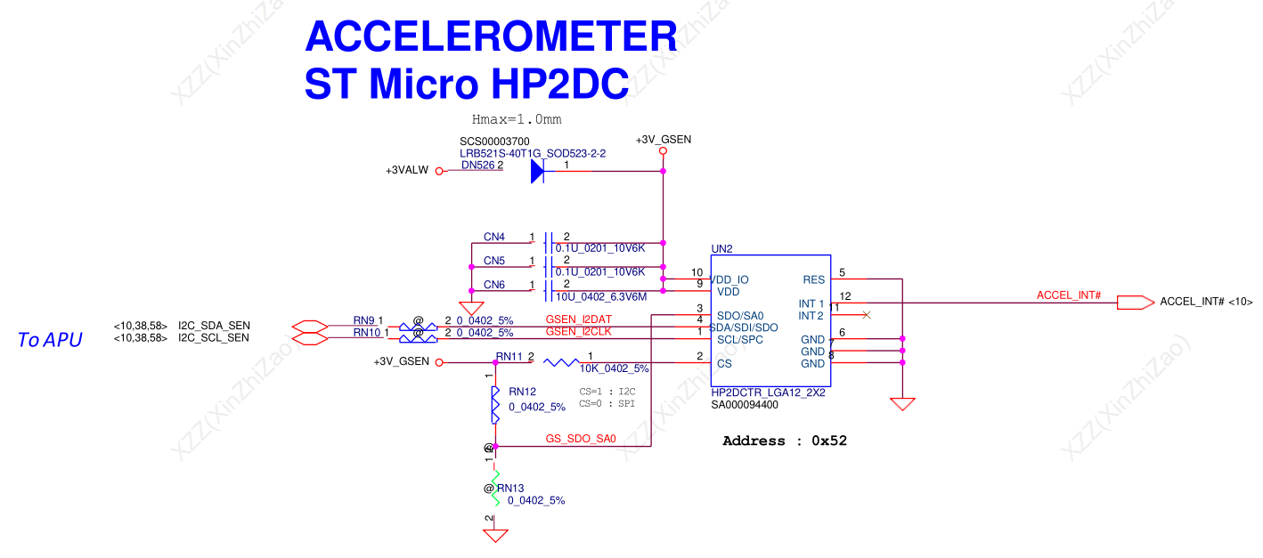

        Brilliant finds guys!!
        LGA12 package; ST Micro part # HP2DCTR
        NEW HP2DCTR 2D GS2984-INTE3 GS2984 SCH5327B-NS MX25L12865EMI-10G ISL95862IIZ-T ISL862 SIRA60DP-T1-GE3 SIRA60 RA60 - AliExpress

          I'm seeing lots of images with the LIS2DH12TR number as well, supplied by lots of china suppliers
