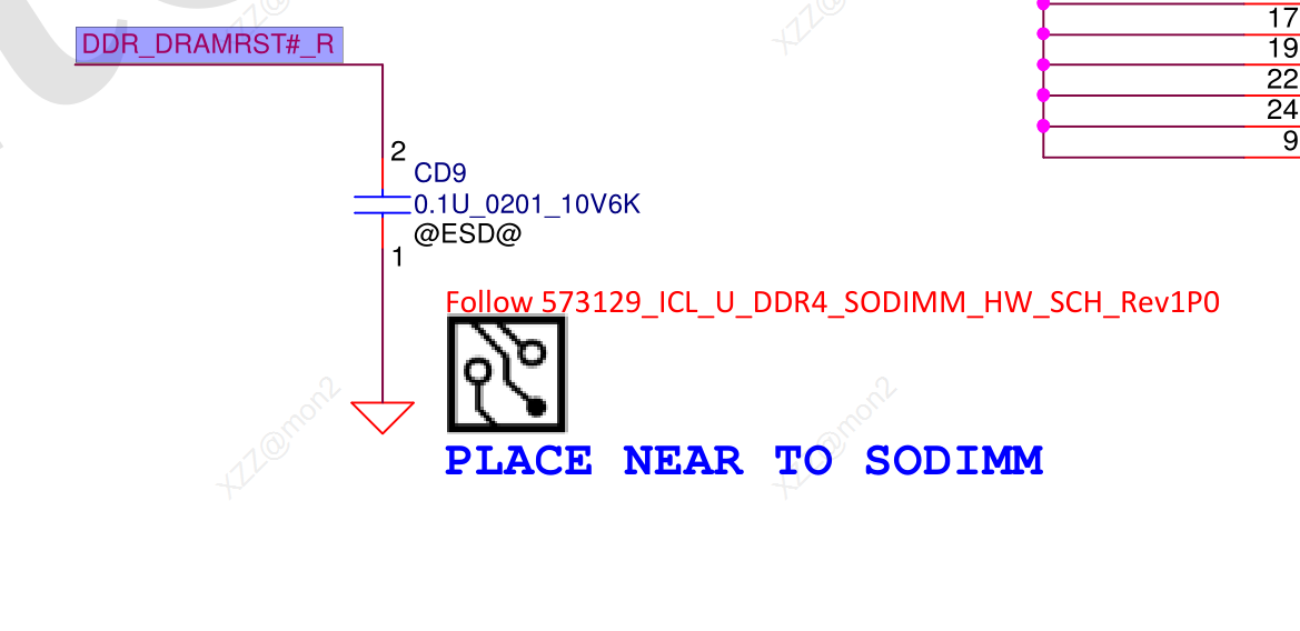

      • mon2
        • Dec 2019
        • 14659
        Check if you have CD9 cap onboard. If yes, flux and remove this cap and test again.

          • FZG
            • Sep 2022
            • 117
            mon2 I tried beeping it out and I guess I found the locations of CD3 and CD9 underneath the RAM slots. They´re not populated.
            mcplslg123 Funny thing is I was able to revive the machine earlier by flashing a virgin bios but the fault came back after a day. I´m gonna try again but not sure what I should think about such quick "re-corruption" of the bios.
