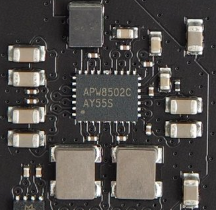

    Help identifying this Asus Zephyrus G15 danjpmb2aa0 component.
    Hello!
    I´m kinda stuck here cause i cant find any schematics or bd.
    And i need help id this component or IC but it´s burnt so i cant se the component Id.
    Board: danjpmb2aa0
    Asus Zephyrus G15
    Thanks in advance!

    APW = ANPEC Electronics in Taiwan
    ANPEC Electronics
    Found a better pic of this part which is used by other vendors:

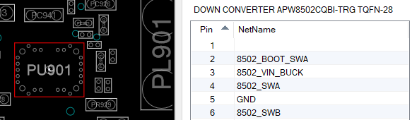

      Here`s a boardview - https://www.badcaps.net/forum/troubl...-2-0-boardview

        Post more pix of your logic board - the boardview does not match the 1st pic. Have the same in my database and it is the same as post # 2.

          It seems to be this one, but i cant find the IC in aliexpress or any where
          APW8502CQBI-TRG TQFN-28

              So the part # is indeed APW8502C and is by ANPEC. This part is used on some recent DDR5 highend modules. Very new to the market.
              My suggestion is for you to reach out to vendors on Aliexpress that support the ANPEC brand of PMICs and request this part APW8502C. PS: This part is not labelled correctly as a QFN28 package.
              The above shared PIC from a DDR5 module matches the pic shared in your first post.
              Suggest to contact this vendor whom we have used in the past - if you search for 'APW' in the Aliexpress seach bar, you will find other ANPEC parts and suppliers. Sort by the # of orders and contact anyone you feel comfortable with. Do update this thread but you should be able to source a replacement PMIC from ANPEC.

                Sorry I never answered, took the IC from a ADATA DD5 for desktop this one in particular https://www.techpowerup.com/review/a...x-16-gb/3.html in the pictures u can see it has the same IC
                Took it from there and installed in the mobo, it worked!!!
                Thanks smdflea and mon2 for all the help!
