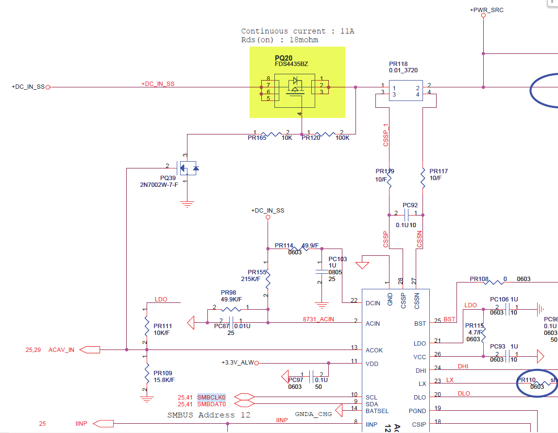

                  Carefully, measure the voltage to ground on each pin of the mosfet @ PQ20 (DCin mosfet).
                  Interested in the source (1-2-3); gate (4) and also the drain (5-6-7-8) voltage to ground measurements.

                    Idk if my measure method is correct: I DC jack unplugged, the black wire is touching the CMOS battery, the red wire is touching the pins
                    Pin 4: 2,2V
                    Pin 1,2,3: 2.5V
                    Pin 5,6,7,8: 3V
                    DOCK_PSID: All the point named DOCK_PSID have 2.7V
                    PS_ID: All pin have 3V
                      These look to be ok at this time.
                      The mosfet readings do not look correct. Be sure the ground is any large metal piece on the board. As a suggestion, remove all power. Meter in DIODE mode. Short your meter probes and you will hear a tone beep.
                      Now connect one meter probe to a metal shield on the board. Other meter probe to a large copper plated hole on the PCB that you suspect to be ground. If you hear a tone beep then very likely, the hole is a ground pad.
                      After the above, configure the meter to DC volts mode (30v or higher since we may have 25V on the gate pin of the mosfet). Then proceed to carefully measure again.
                      If you truly have the above measurements, then the adapter may be defective or the main power rail is shorted. Let us check the main power rail.
                      Remove all power -> meter in resistance mode -> check the resistance to ground of the source pins (1-2-3). The source pin group is used to power the logic board. If this measurement is of a low resistance, then there is a short on the main power rail and this is likely causing the massive voltage drop from the adapter's ~19v to what you are measuring.
                      Post each measurement.​

                        Pin 1,2,3 have 20M Ohms so I dont think the MOSFET is shorted to the ground.
                        Pin 1,2,3,5,6,7,8: 19V
                        Pin 4: 1.7V

                                The measurements on PQ20 are ok since this is a P-channel mosfet. With a P-channel mosfet, the GATE voltage (pin # 4) must be LOWER than the voltages being passed between source / drain pins. The voltage divider built by the 2 resistors is enabled and this mosfet is operating correctly to pass through the 19v from the power adapter.
                                Certainly replace the defective part noted earlier and also review the other power rails on the motherboard. Each such (switching) power rail will have an inductor nearby. LDO rails do not usually have such inductors. In either case, with no power to the board, measure their resistance to ground. You are on the hunt for any possible low resistance on a power rail which often means a shorted component = will draw higher current -> the power rail may run for a bit till the parts heat up and then powers down the rail and the cycle may or may not repeat. This is power cycling of the board. Do not rule out that your main bios may be corrupt. The LED blink is by the EC (dedicated controller that handles the keyboard scanning, etc. functions).
