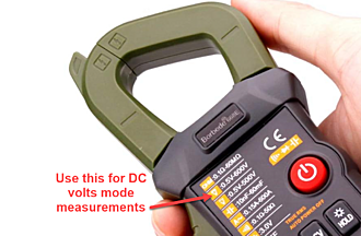

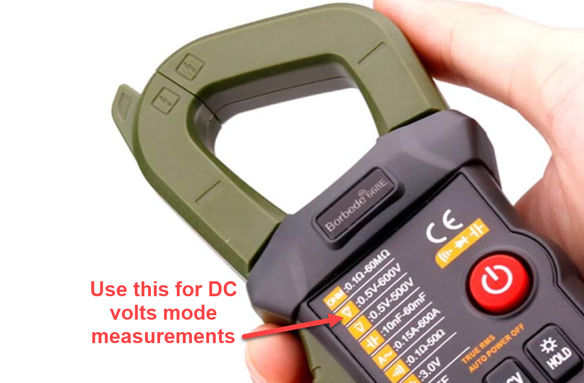

                  Damn, I think I have to get a new multimeter lol, mine is a Borbede 668E, it doesnt let me choose which mode to use though. It's late here in Vietnam so see you tomorrow and see whether I could get my hand on a new multimeter on hand. Good night!
                  • mon2
                    • Dec 2019
                    • 14634
                    #29
                    See attached. The 2nd from the top setting = DC volts mode.

                      Thanks for investing your time into this post, I appreciate it a lot. I assume it auto switch to the mode without any input from the user though, i don't how to manually switch to the DC Voltage mode, the manual is lost.
                      • mon2
                        • Dec 2019
                        • 14634
                        #31
                        Do you switch the modes using the switch where you can see the finger? (LEFT side of the pic and where I drew the arrow)
                        Will download the user manual later and confirm the same.
                        • mon2
                          • Dec 2019
                          • 14634
                          #32
                          3:44 in this video
                          How to use Clamp Meter to test Amp Voltage Resistor Capacitor Diode LED | Borbede 668E (youtube.com)​
