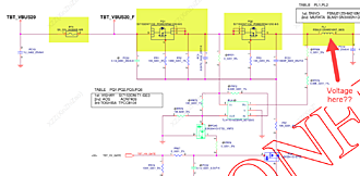

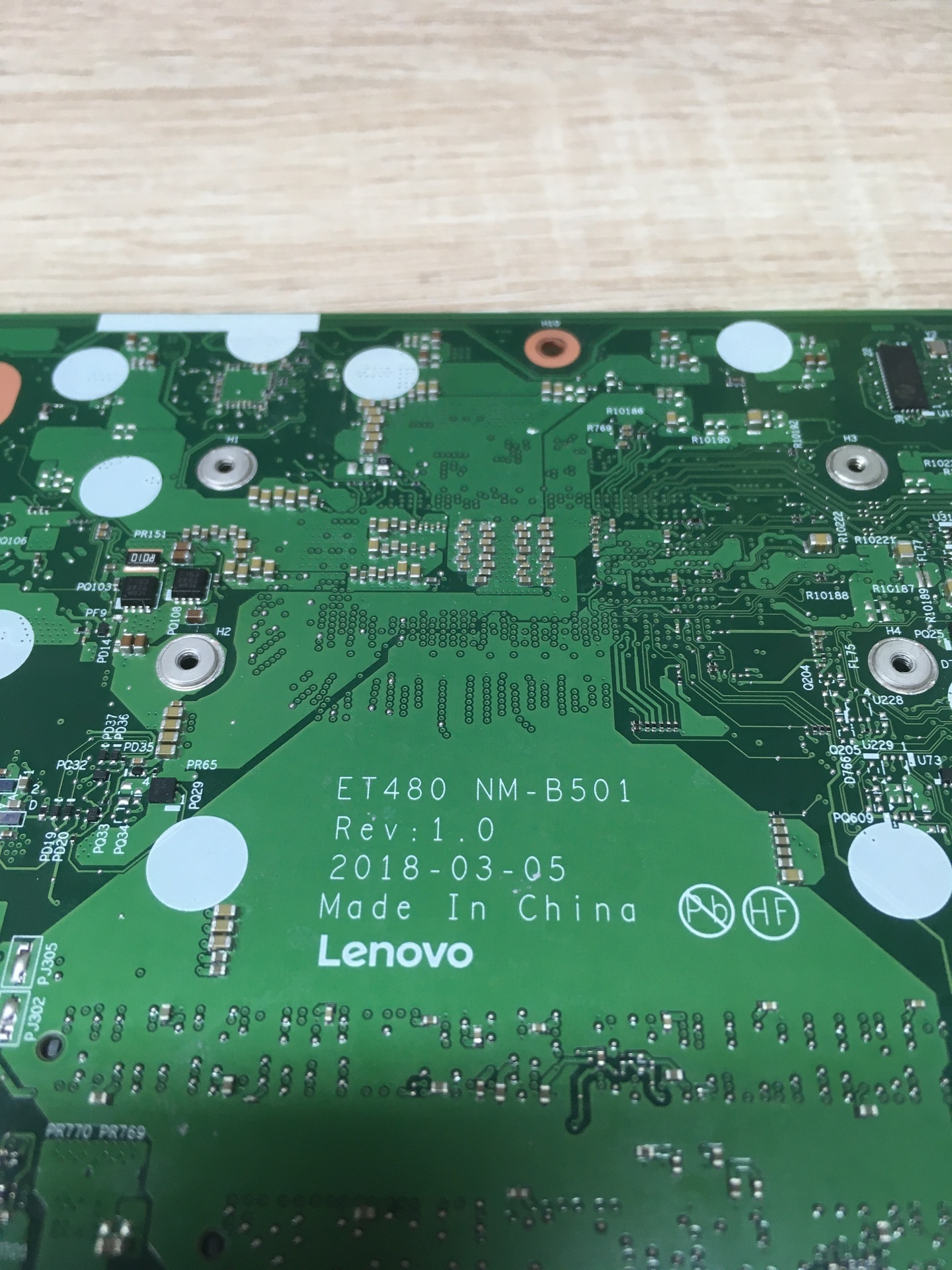

    Hello, I'm not getting anywhere, maybe someone can give me a tip in the right direction.
    About the background Notebook had liquid damage, I removed corrosion with alcohol so far none of the components were burnt out or had burn mark.
    Notebook will not start.
    It doesn't show any LEDs or anything like that when you turn it on and the voltage doesn't change.

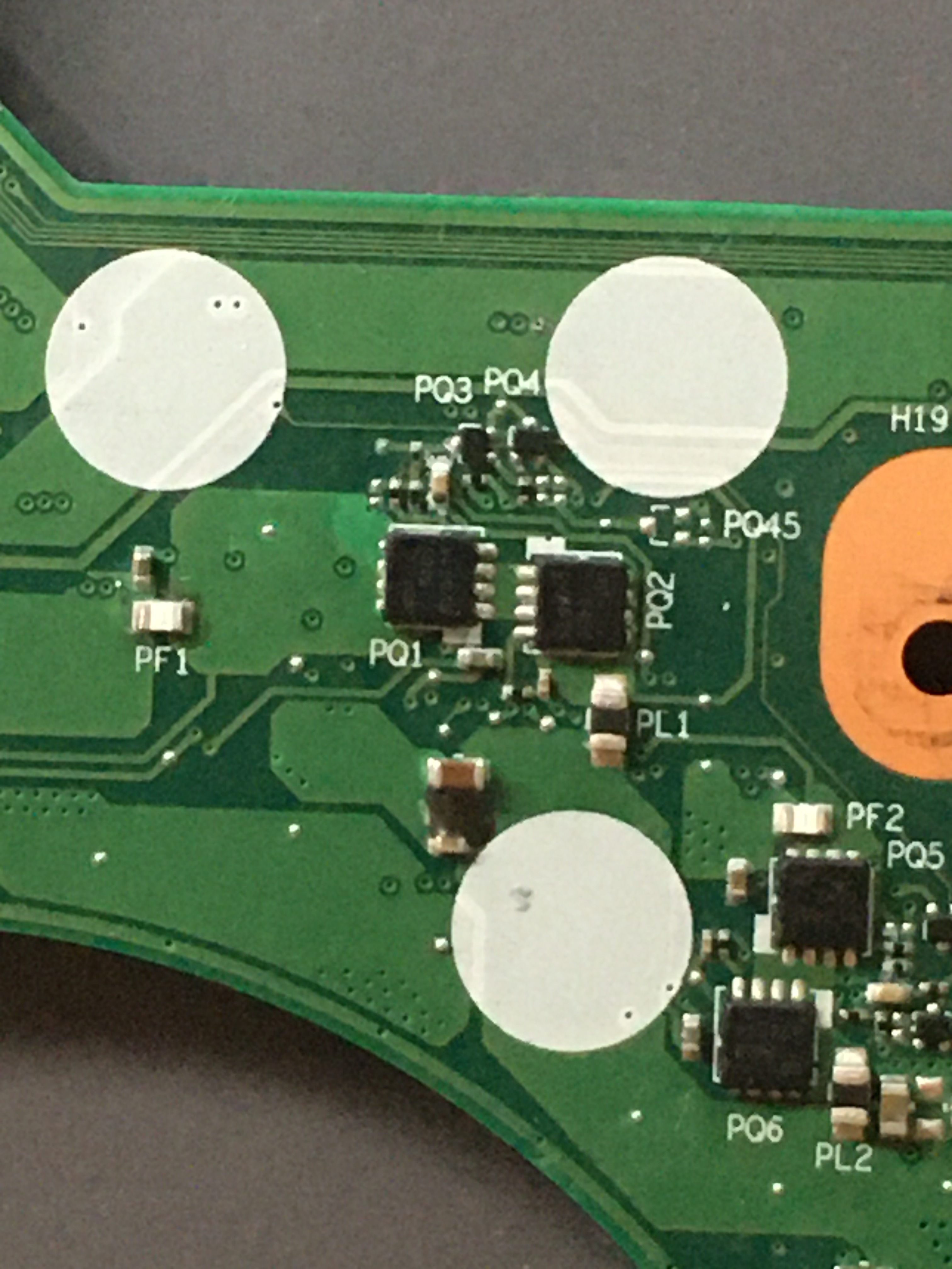

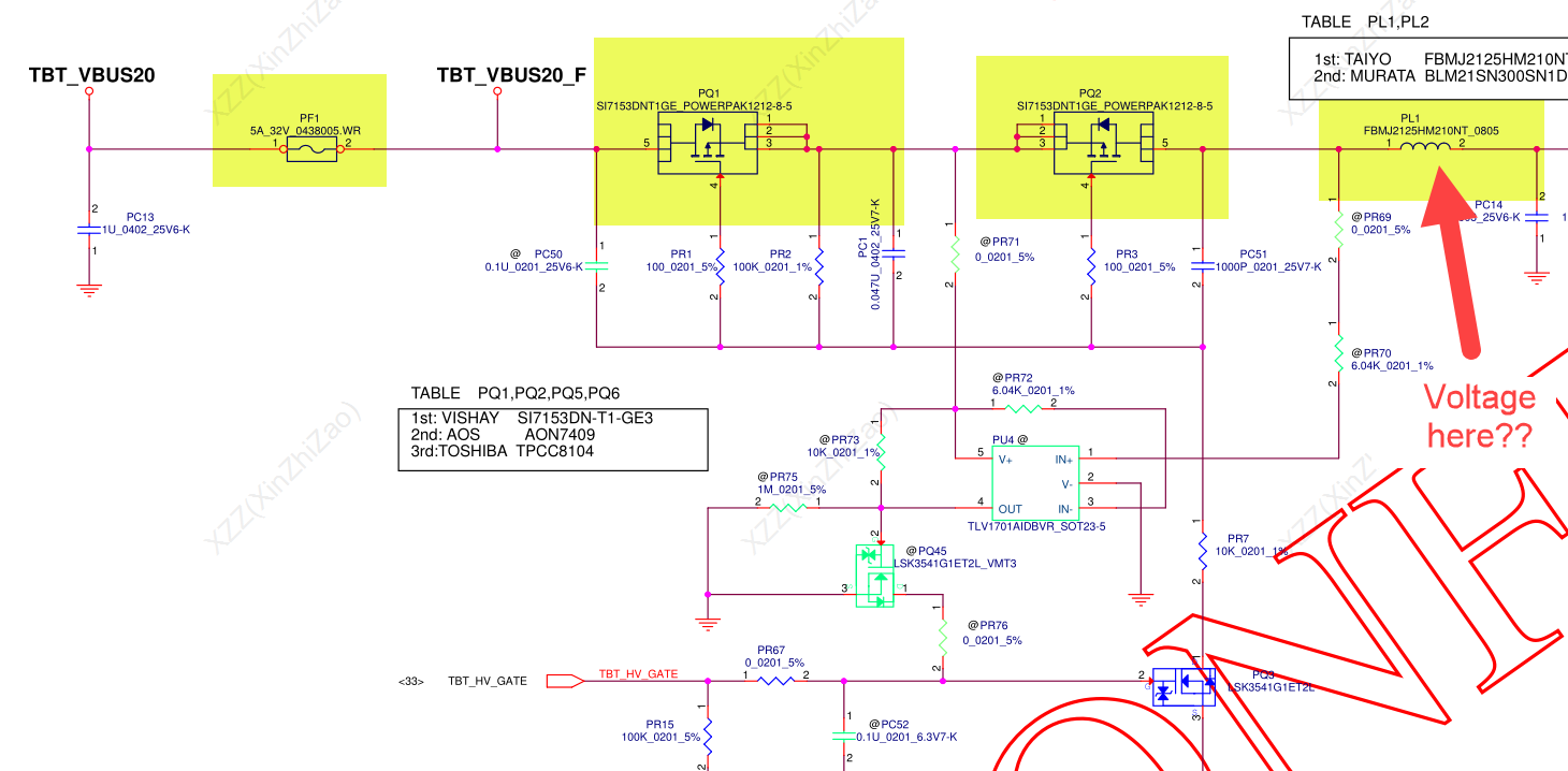

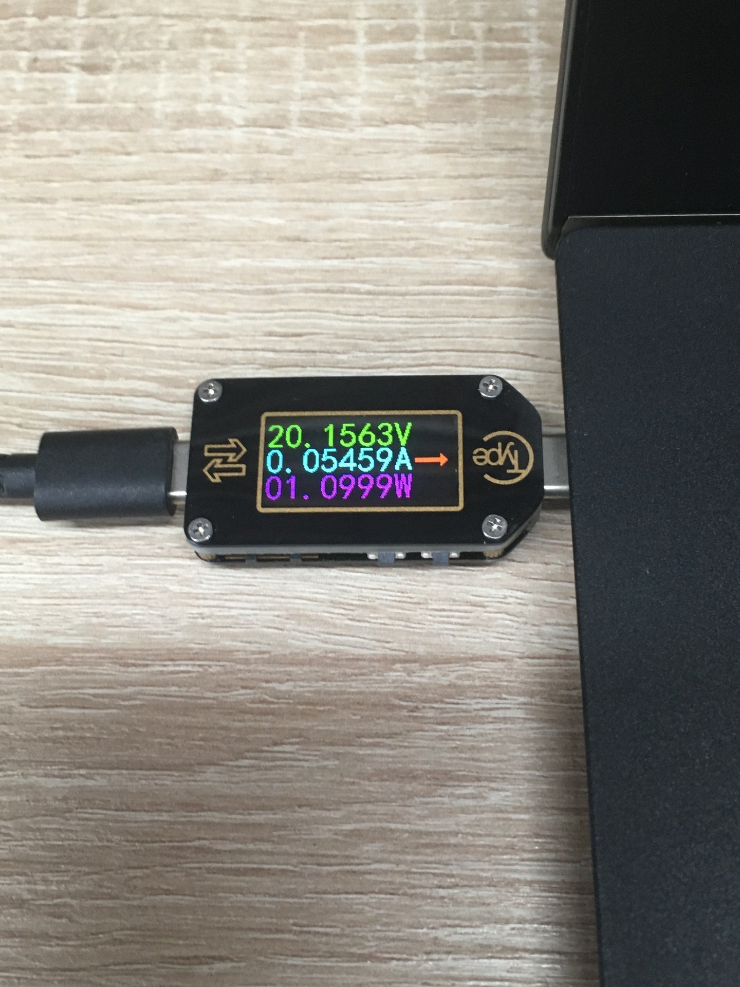

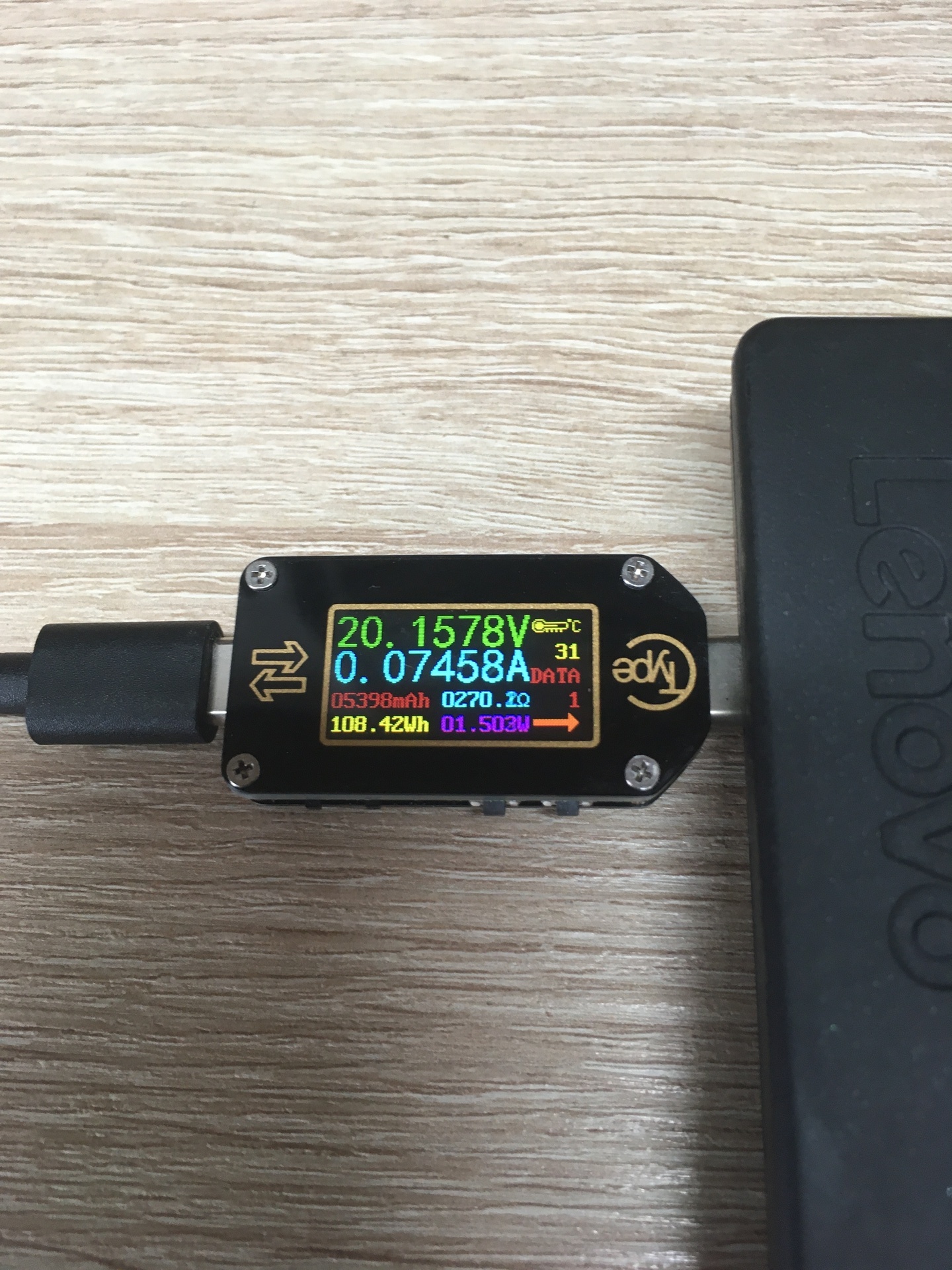

        The 20V on the power delivery meter is a good start. This implies that the PD controller on the logic board is working. This PD controller and the external USB Type C power adapter have properly communicated to dial up the required 20V to power up. However, the current draw is wimpy @ ~50 mA so the logic board's power path is defective.
        Do review:
        PF1 ; fuse onboard - most likely not the fault since you have some current consumption but does not hurt to remove all power and measure the resistance across this fuse. It should be ~0 ohms if the fuse is not defective.
        Next in the power path from the USB Type C connector are:
        PQ1
        PQ2
        Dcin mosfets. Carefully, measure their voltage to ground of the source (1-2-3); gate (4) and drain pins (5-6-7-8).
        As a quick check -> jump over to inductor PL1 and check its voltage to ground. Do you see ~20 volts here? If not, the fault is in the PQ1 / PQ2 Dcin mosfet region or their trigger conditions.

            Thanks for the answer here the values.​
            Fuse PF1 = okay
            PL1 = 20 Volt okay
            PQ2= 20 Volt okay
            PQ1= Gate-Source Voltage 19,7 Volt
            PQ1= Source Voltage 19,7 Volt
            PQ1= Drain-Source Voltage 0,000 Volt not okay
