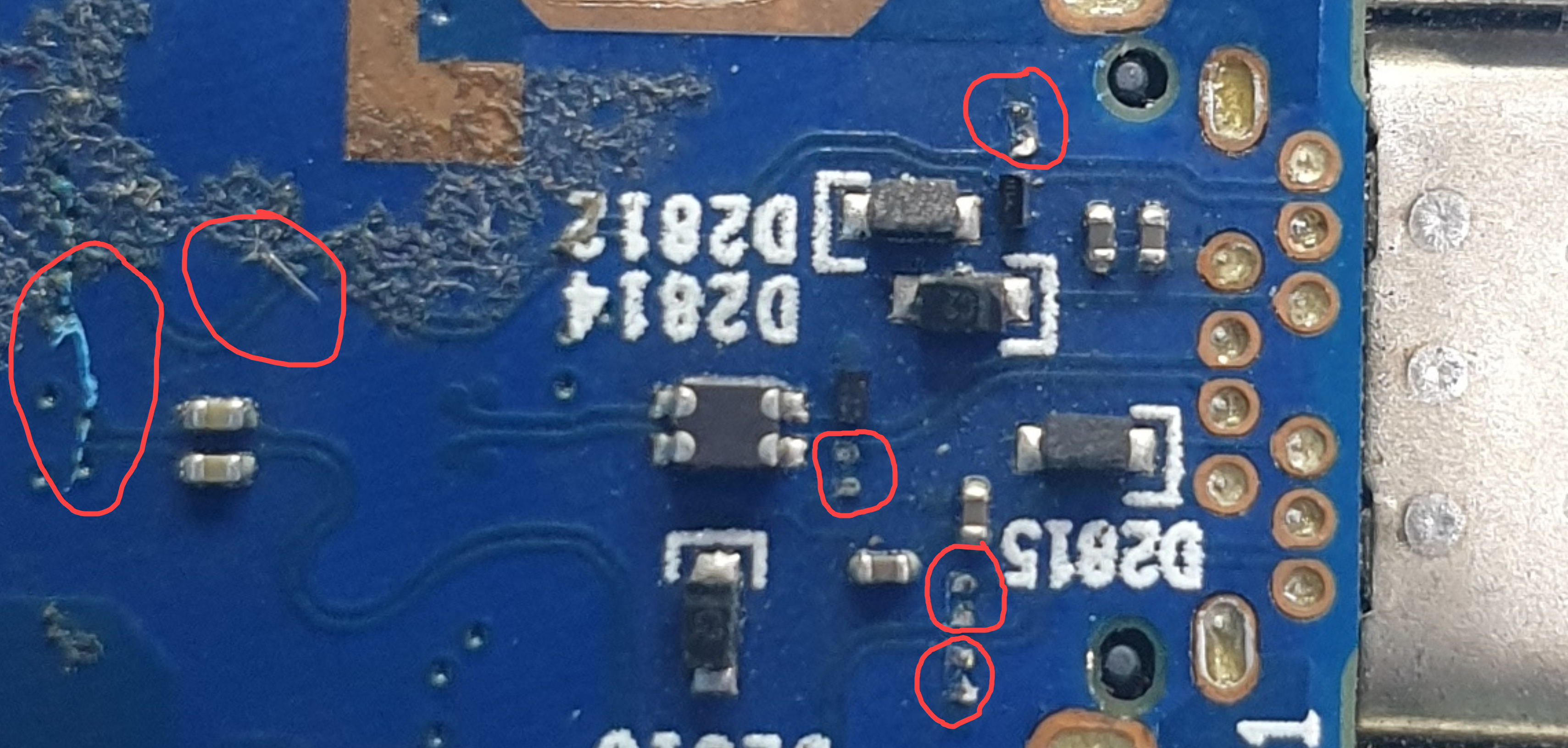

              Concerns about the attached and circled areas.
              You are missing some parts in these PCB pad areas. Be sure the PCB tracks are not broken here.
                Sorry bro, thought you just need to see the pinout.
                The exact pcb pics are attached.
