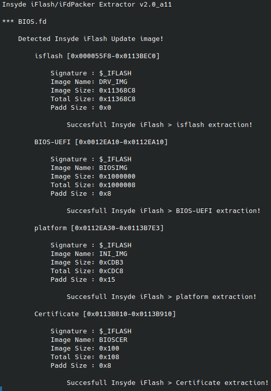

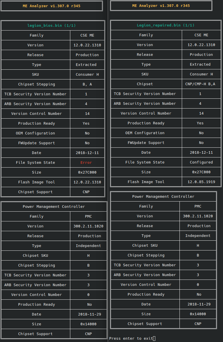

    I then read the BIOS chip and used MEAnalyzer to check. It gave me some checksum errors and under "File System State" it says "Error". Ok, I thought then maybe this is the problem and I proceeded with clearing the ME region as was described on this forum and reflashed it. In the picture attached you can see the original and the cleared image file. Unfortunately this did not work either. So I downloaded a new BIOS from Lenovo (BHCN45WW​) and extracted the firmware using Insyde IFD Extract from https://github.com/platomav/BIOSUtilities
    I then copied the DMI data (632000 - 633FFF) from the original to the downloaded image and flashed it. Again unfortunately it did not work. Maybe the problem is not just the BIOS?
    From the Lenovo BIOS update other files were also extracted like Certificate and Platform.ini etc. Maybe I have done something wrong? I just assumed it is the contents of the Flash chip cause the file size of the extracted .bin file matched. ME Analyizer looked fine and also Intel Image Tool did not report errors when loading it.
