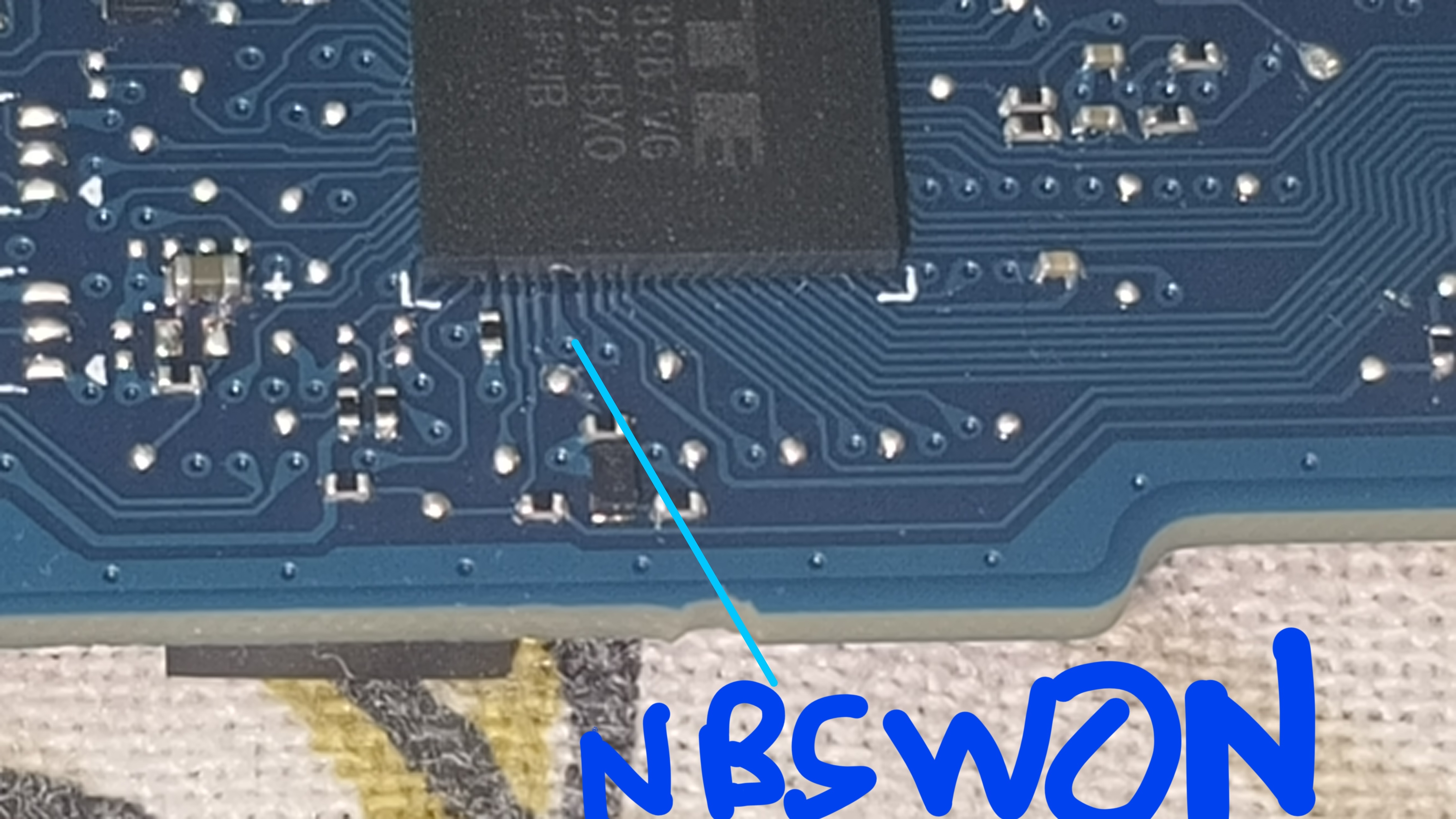

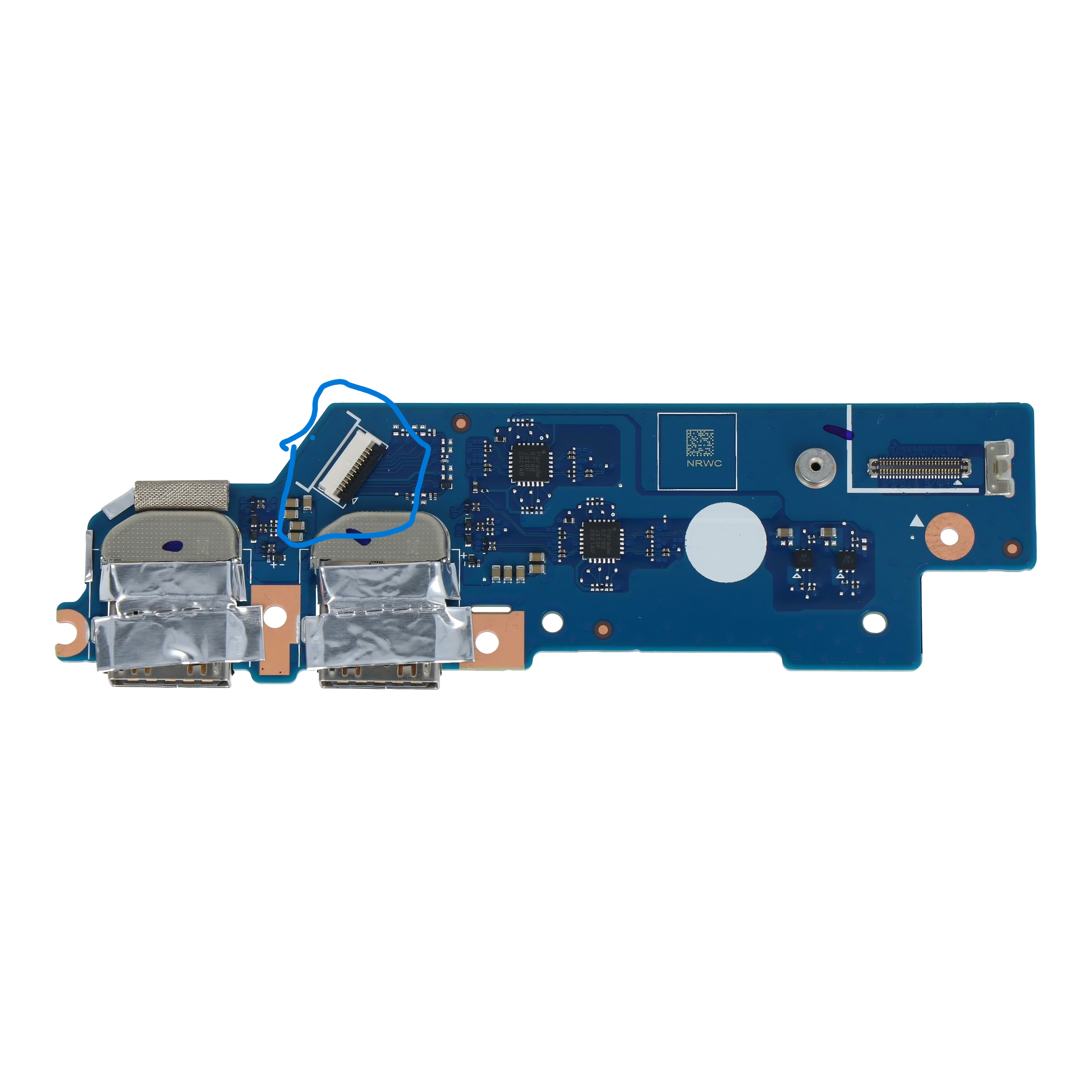

Well I am dumb to buy a faulty water damaged motherboard from ebay and i need help :)
  • Satvik Hardat
    • Mar 2024
    • 38
    • India
ID:	3243694 that and that Click image for larger version
ID:	3243695 kinda look similar i tried shorting the nsbaon#(idk spelling) to ground but no power at cpu vrms

      NBSWON#(correct spelling)
      • dellxps15
        • Feb 2014
        • 1598
        • italy
        voltage on nbswon# ?

          0.4-5 ish cuz of the low battery on multimeter

              Okay now after installing a new battery in my multimeter shows zero volts
              • Satvik Hardat
                • Mar 2024
                • 38
                • India
                0.08v to be very precise
                • dellxps15
                  • Feb 2014
                  • 1598
                  • italy

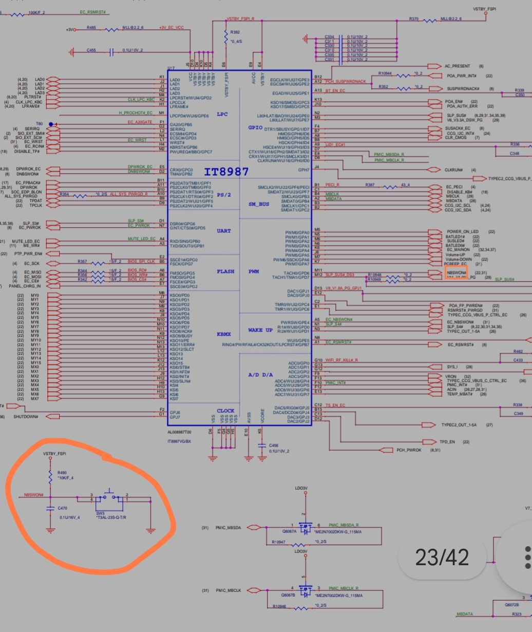

                  are u using lab psu or usb-c psu ? do u have amperomether for usb-c ? just to know how many amp it's drawing.
                  voltage should be 3,3 for nbswon.
                  this is power sequenze for similar notebook.
                  without fan, pc should start at least for few seconds and cpu should get warm. then power off without heatsink.

                    #29
                    Usb-c psu, I don't have a way to know current draw

                      #30
                      Like idk what is the nbswon pin actually is and I am just assuming the thing I circled is

                        #31

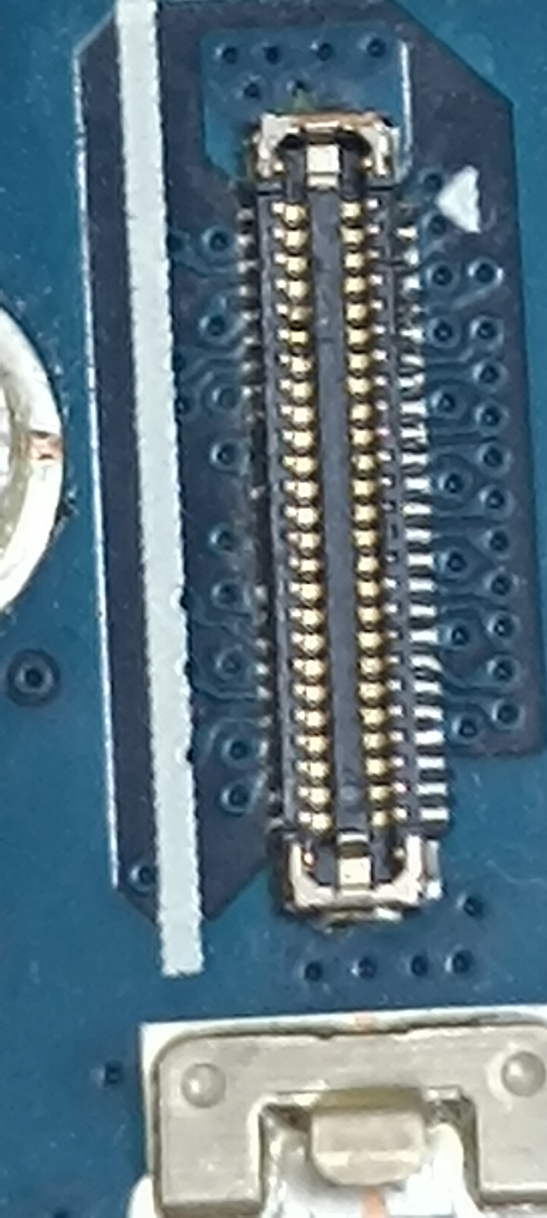

                        this is the image of second board where Click image for larger version
Name:	02353WKX_1-GNIAZDO-lADOWANIA-PlYTKA-USB-HUAWEI-MATEBOOK-14-02353WKX-ORYGINALNE-.png
ID:	3244067 is the power con

                          #32
                          i also checked this is it useful?
ID:	3244071 ​3 pins on the left side are 3.3 v
                          • Satvik Hardat
                            • Mar 2024
                            • 38
                            • India
                            #33
                            i shorted it all still ain't starting (the connector above)
                            ec chip getting 3.3v and 1.8v not getting hot sitting cold while doing something (i was checking all the pads near ec chip there were some weird voltages like 0.4-0.8v bios chip also has 3.3)

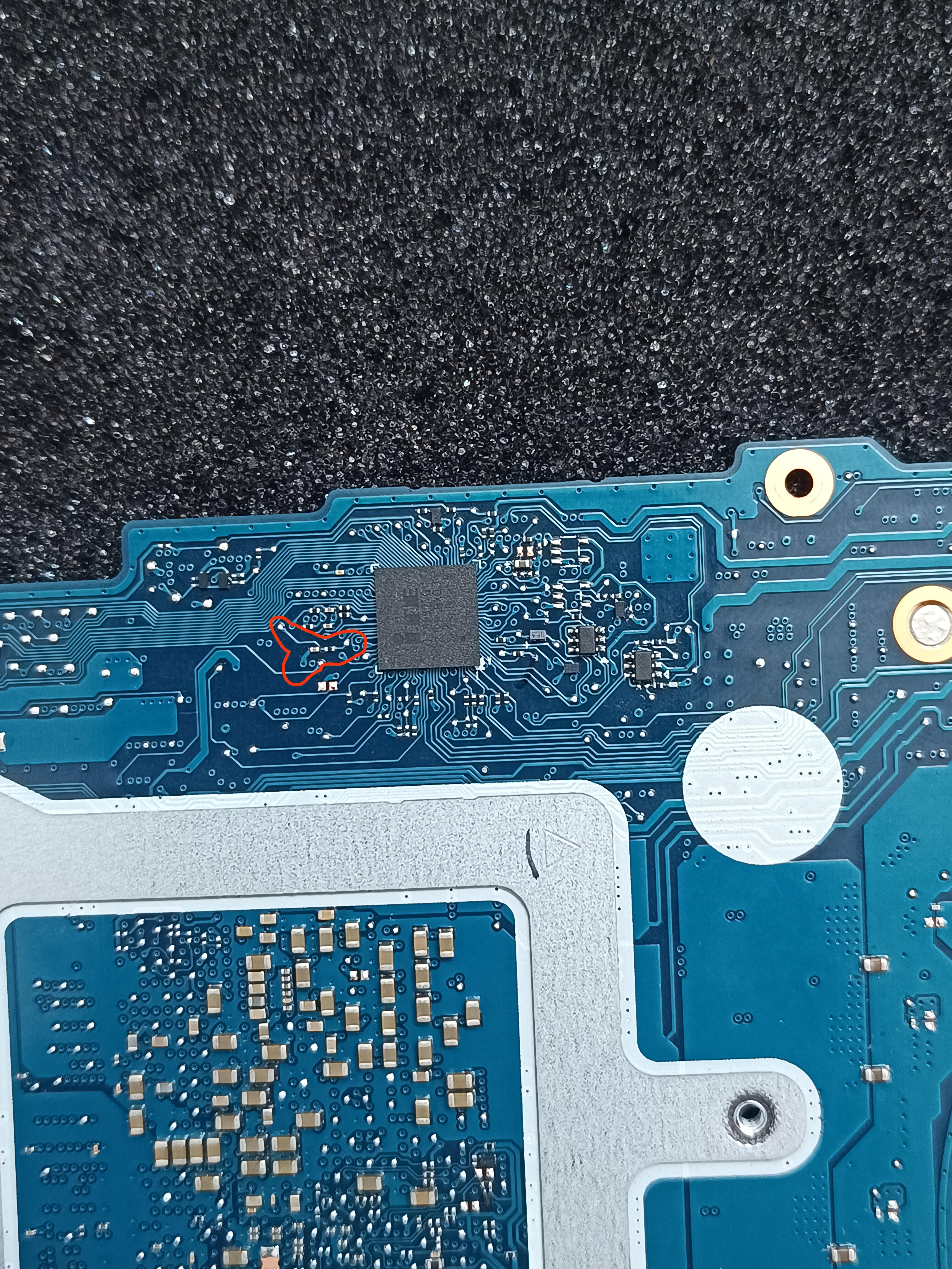

                                one more thing is it possible like i need to replace the caps i removed like i have a other laptop motherboard and take a big ceramic (only 1 of like a higher voltage and current value presumably) capacitor and place there .
                                • Satvik Hardat
                                  • Mar 2024
                                  • 38
                                  • India
                                  #36

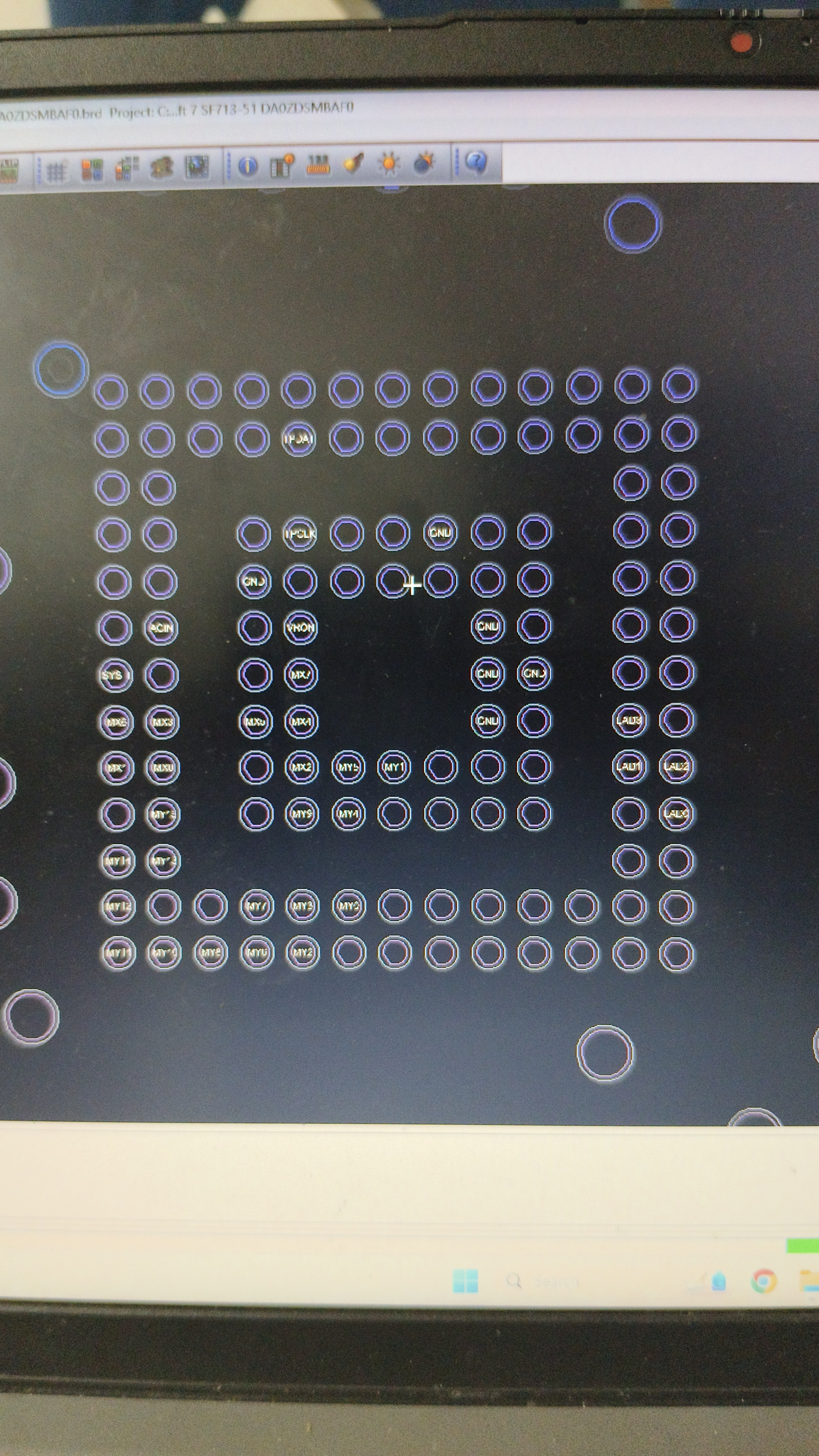

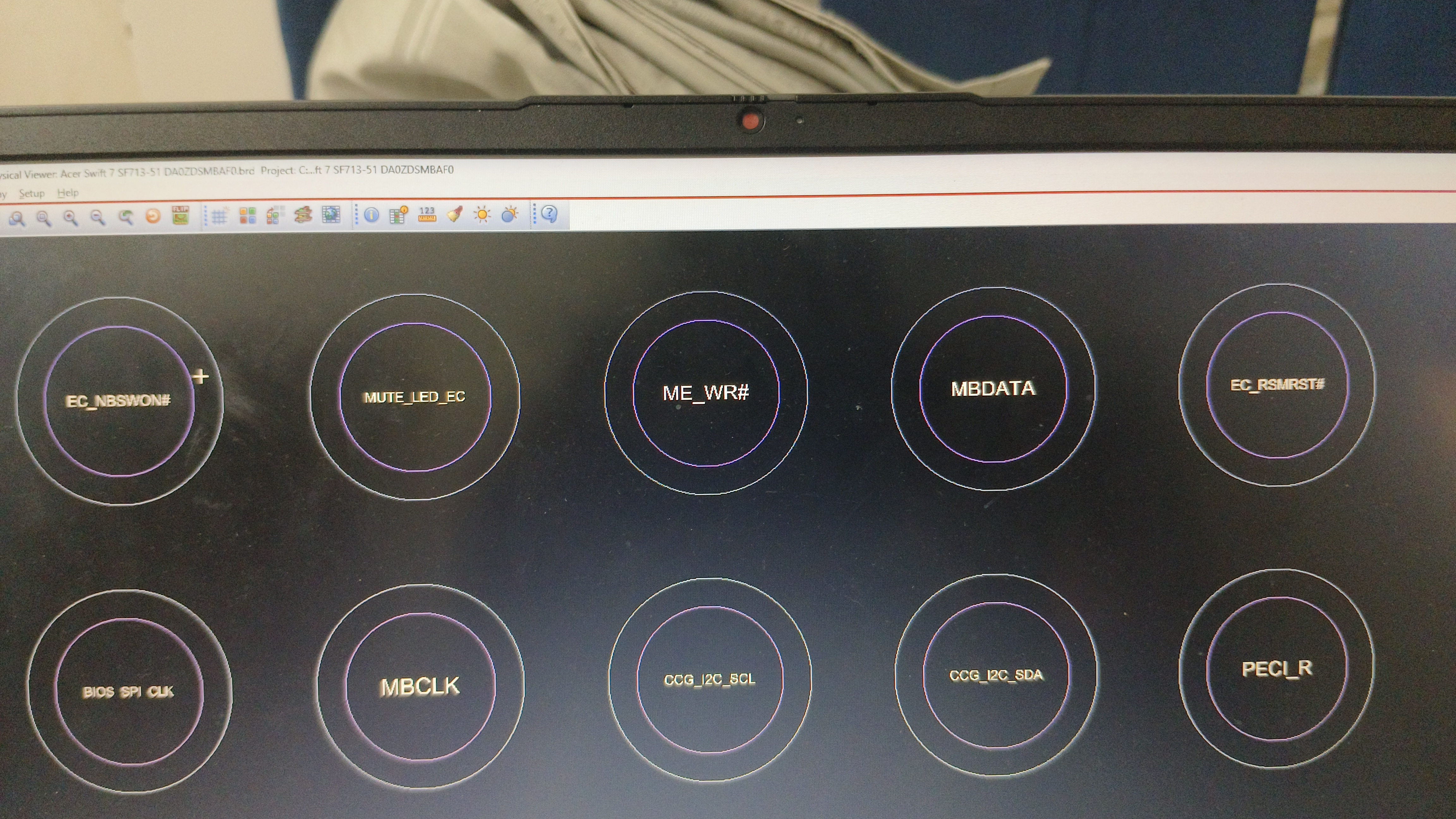

                                  Yep I think that's it Click image for larger version
ID:	3244132 don't ask me how
                                  Saw the board view of some other board with this chip
ID:	3244133 Click image for larger version
ID:	3244134there it is

                                    we need board code to find schematic and boardview.

                                      Some other board with same ec chip with bga package

                                        grazie mille ora funziona
                                        • dellxps15
                                          • Feb 2014
                                          • 1598
                                          • italy
                                          #40
                                          so notebook is powering on and giving picture ?
                                          however is better to get boardview and schematic to replace caps with right value.
