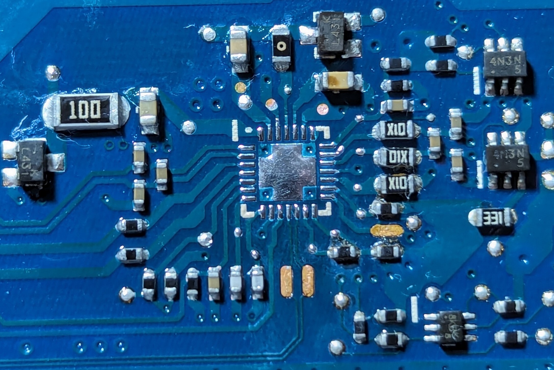

      Based on the very low resistance to ground measurements of SRN / SRP, the charger IC appears to be defective. Suggest to flux it well and remove off the board. Do not replace this part yet. Then still with no power, measure the resistance to ground of each pin on the charger IC. Need to know if the SRN / SRP and other pads are restored to normal values. What is the value of the ACN / ACP pin to ground after the charger IC is removed?
      Be patient so that the charger IC pcb pads are not torn off the board. Use tweezers to slightly nudge the IC to see if the part can be removed.

                Schematic/bdv is not linked-so cant check but its clear that the damage is very likely in high side charging mosfet. Remove the mosfet connected to HG pin of charging ic and check again for short.

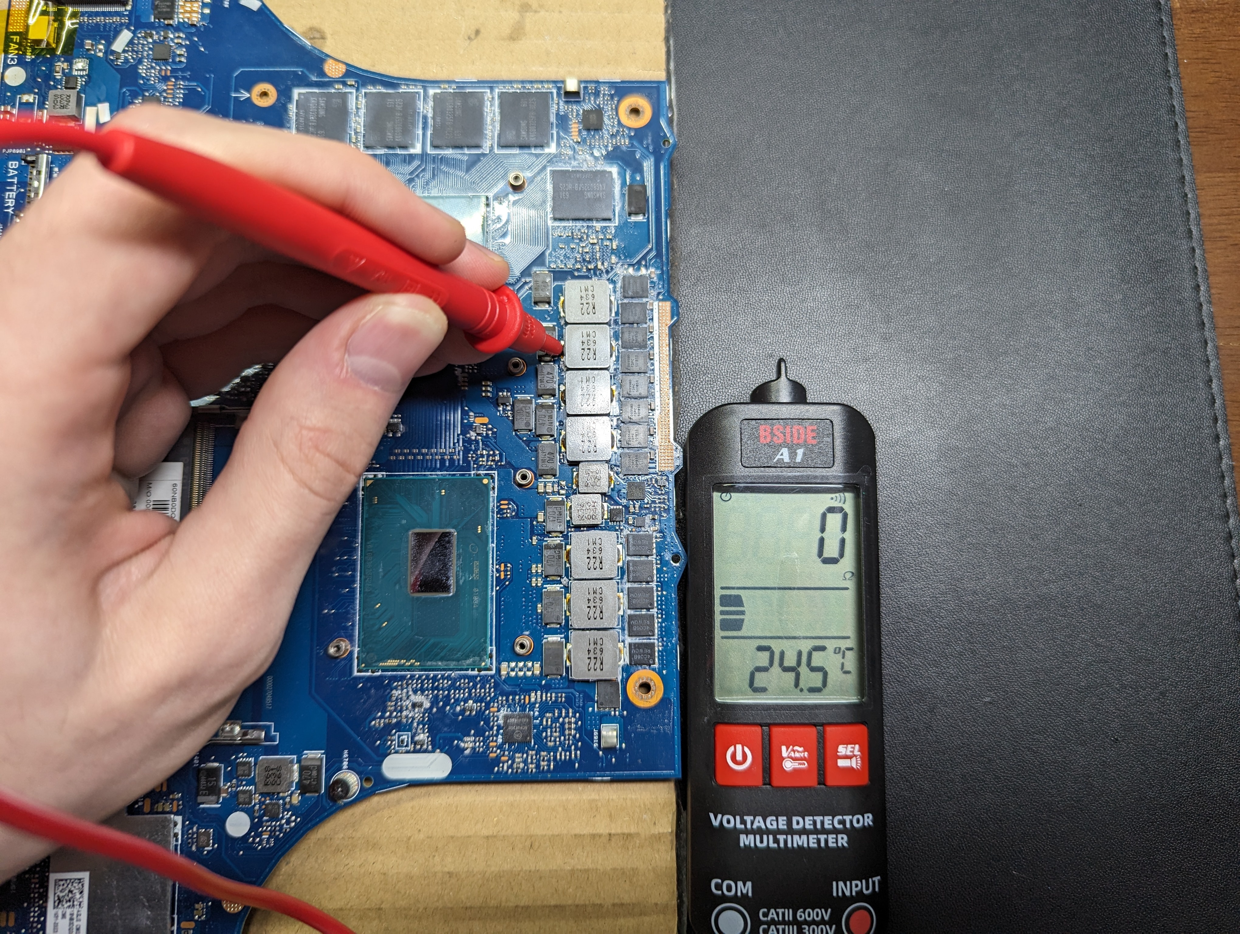

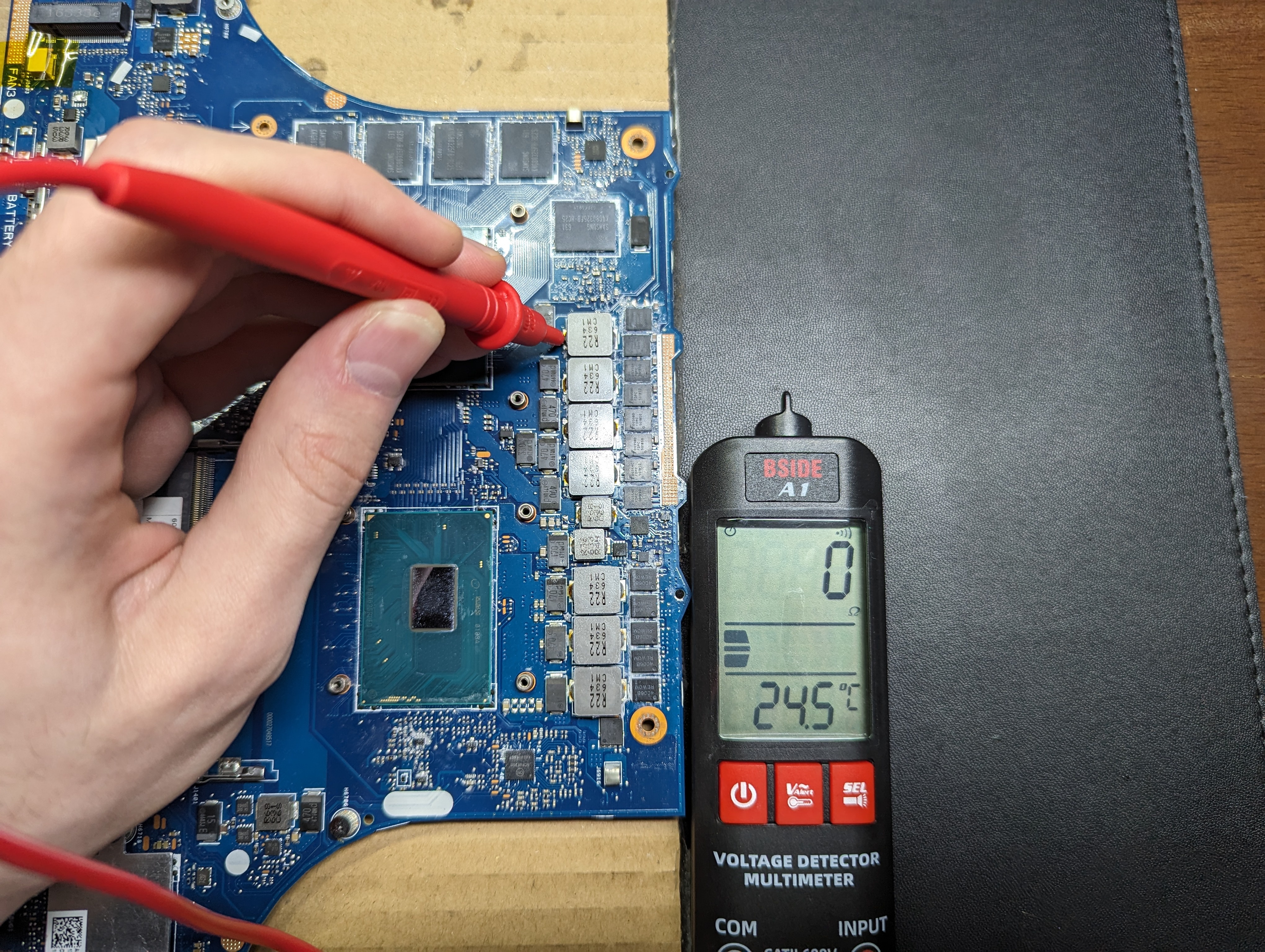

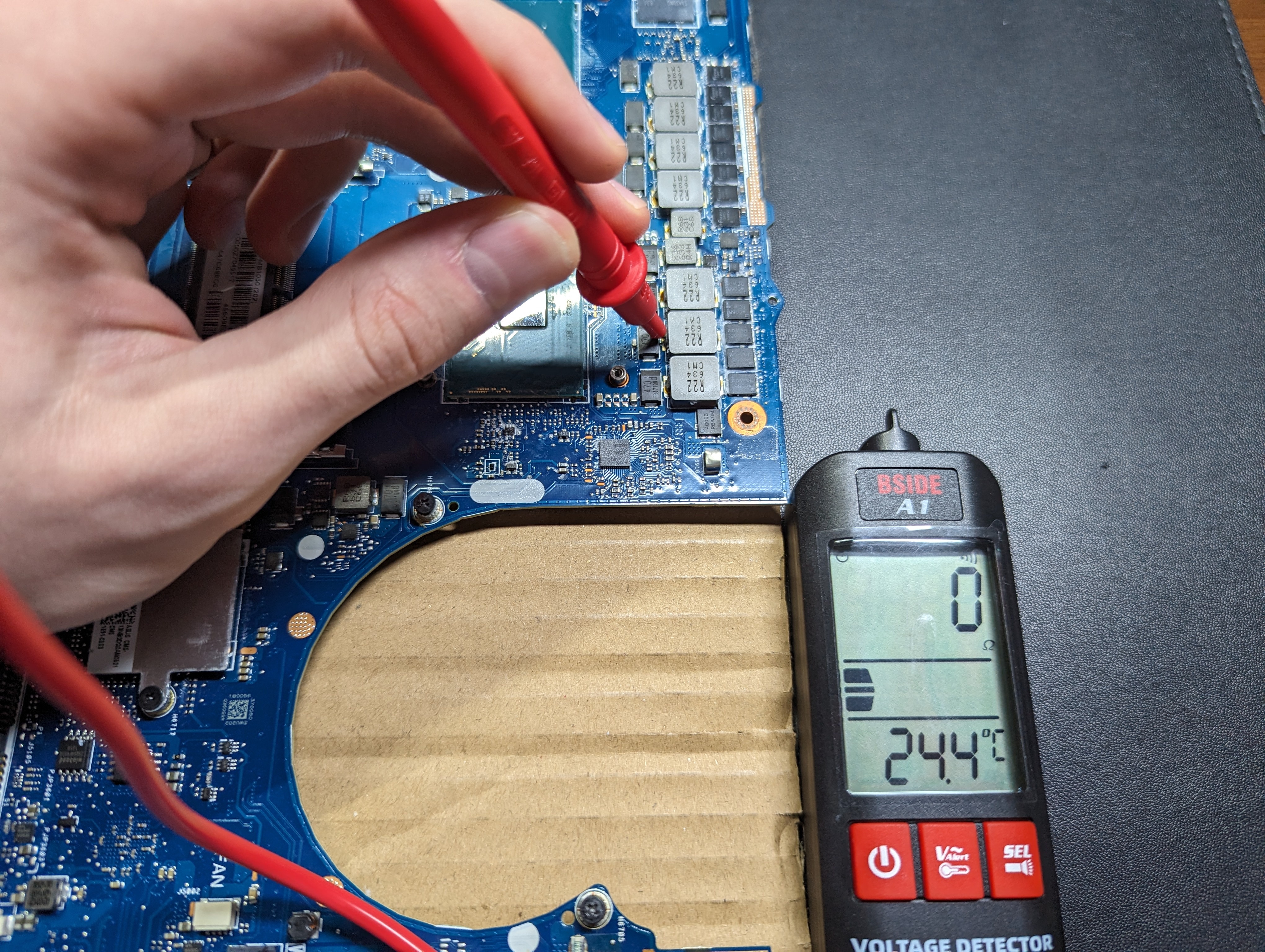

                  I apologize for not replying earlier, I, sadly, don't have a variable power supply for voltage injection. Checked all the inductors, almost all of them gave a resistance of 0 ohms to ground. Should I make a list of one's that have resistance? Or both with resistance and no resistance?
                  Also, removed the mosfet connected to HG, PQH8901. Short to ground on IC HG pin, as well as on AC_BAT_SYS has disappeared. Resistance on AC_BAT is now 3.9mO. Checked the battery connector itself, BAT_CON to ground gives 0 Ohm resistance.

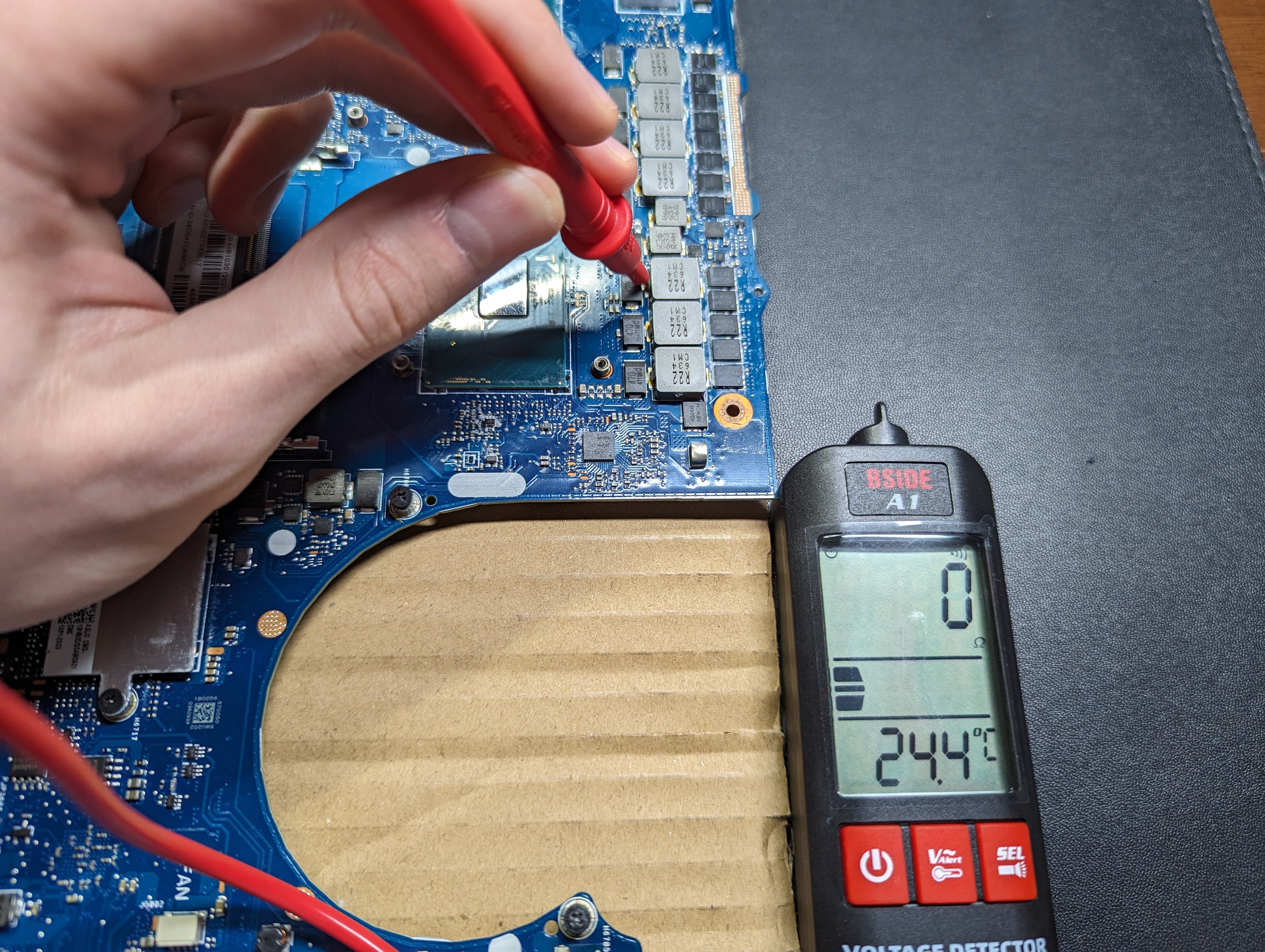

                    #29

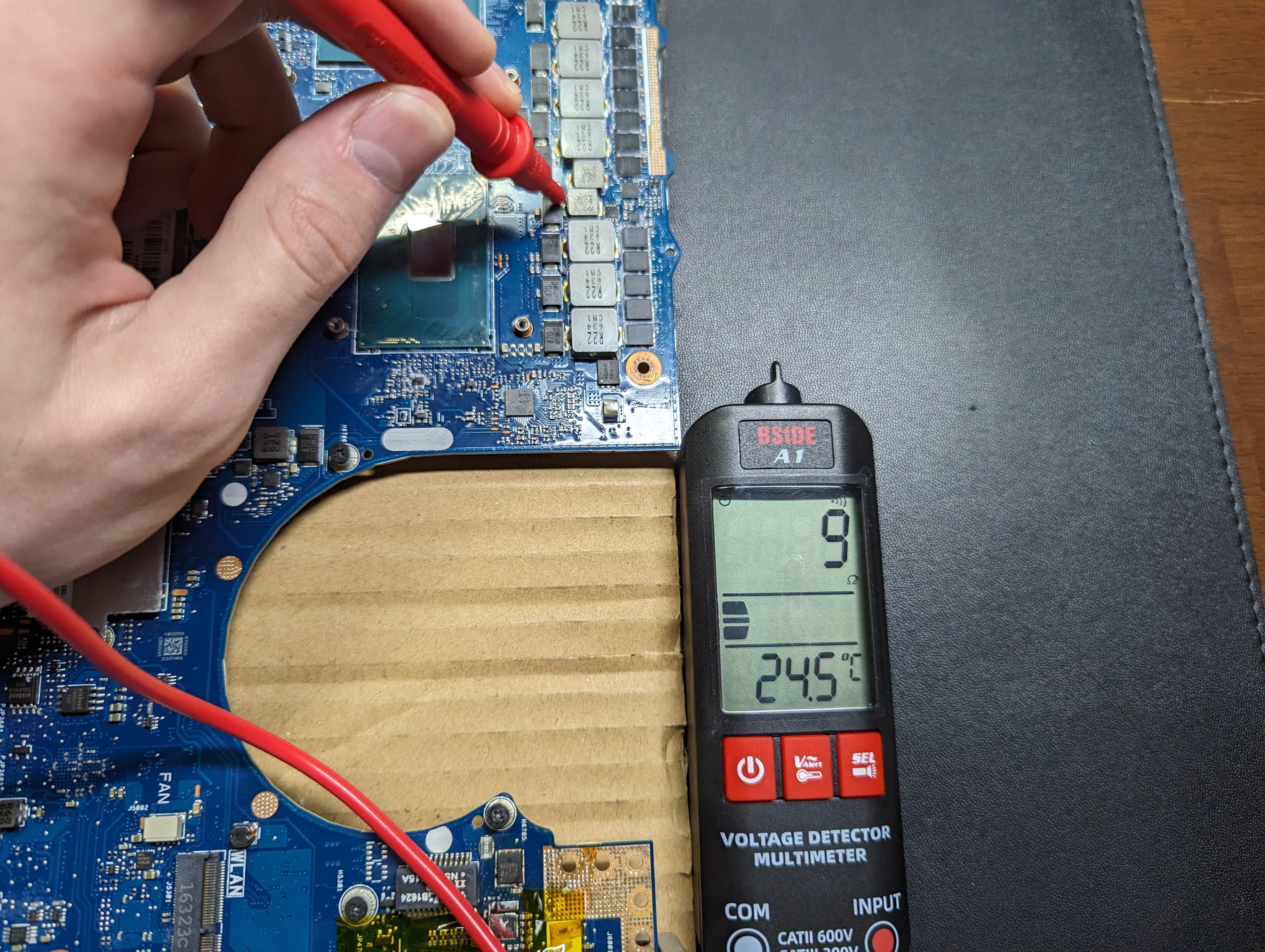

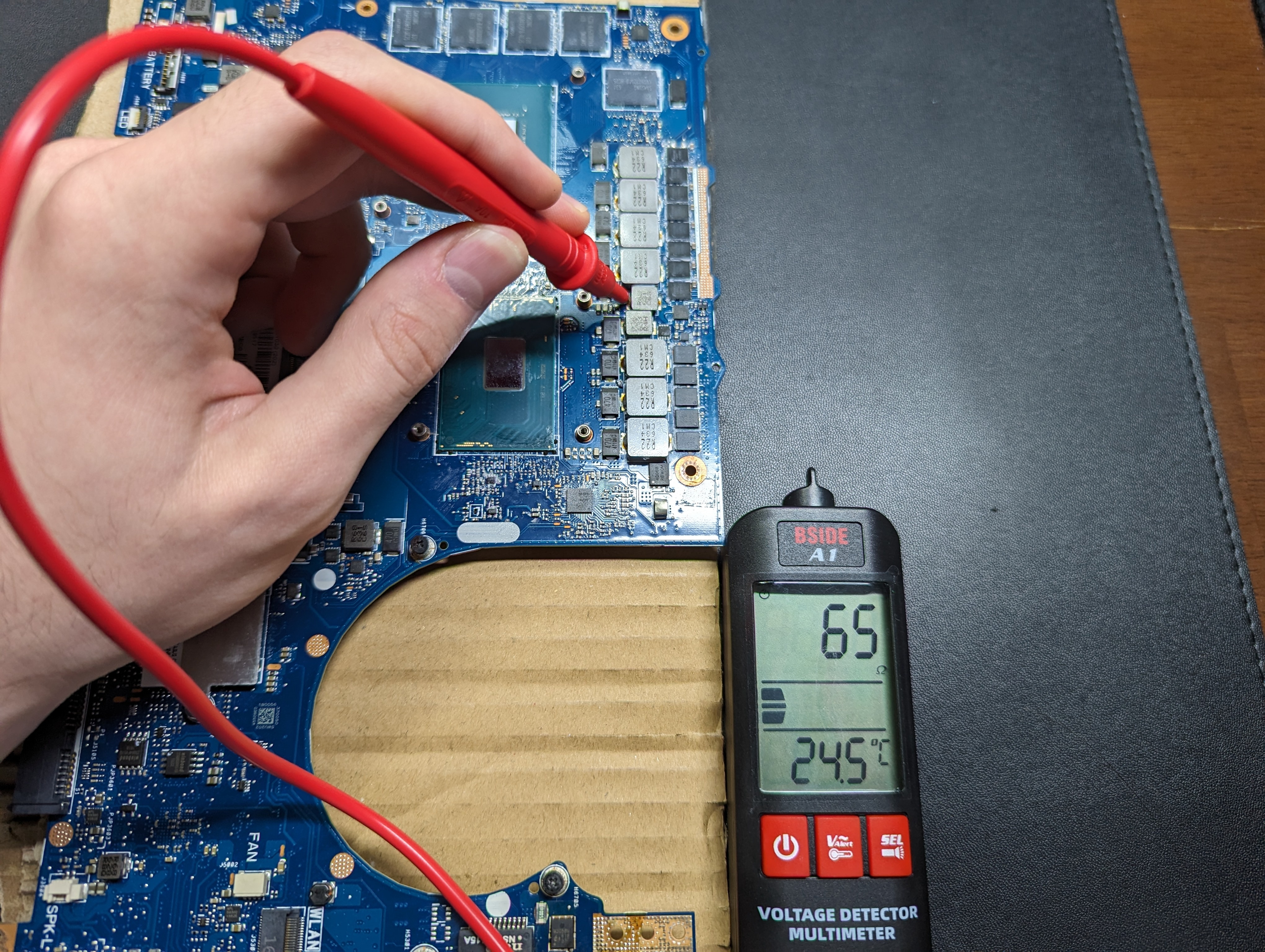

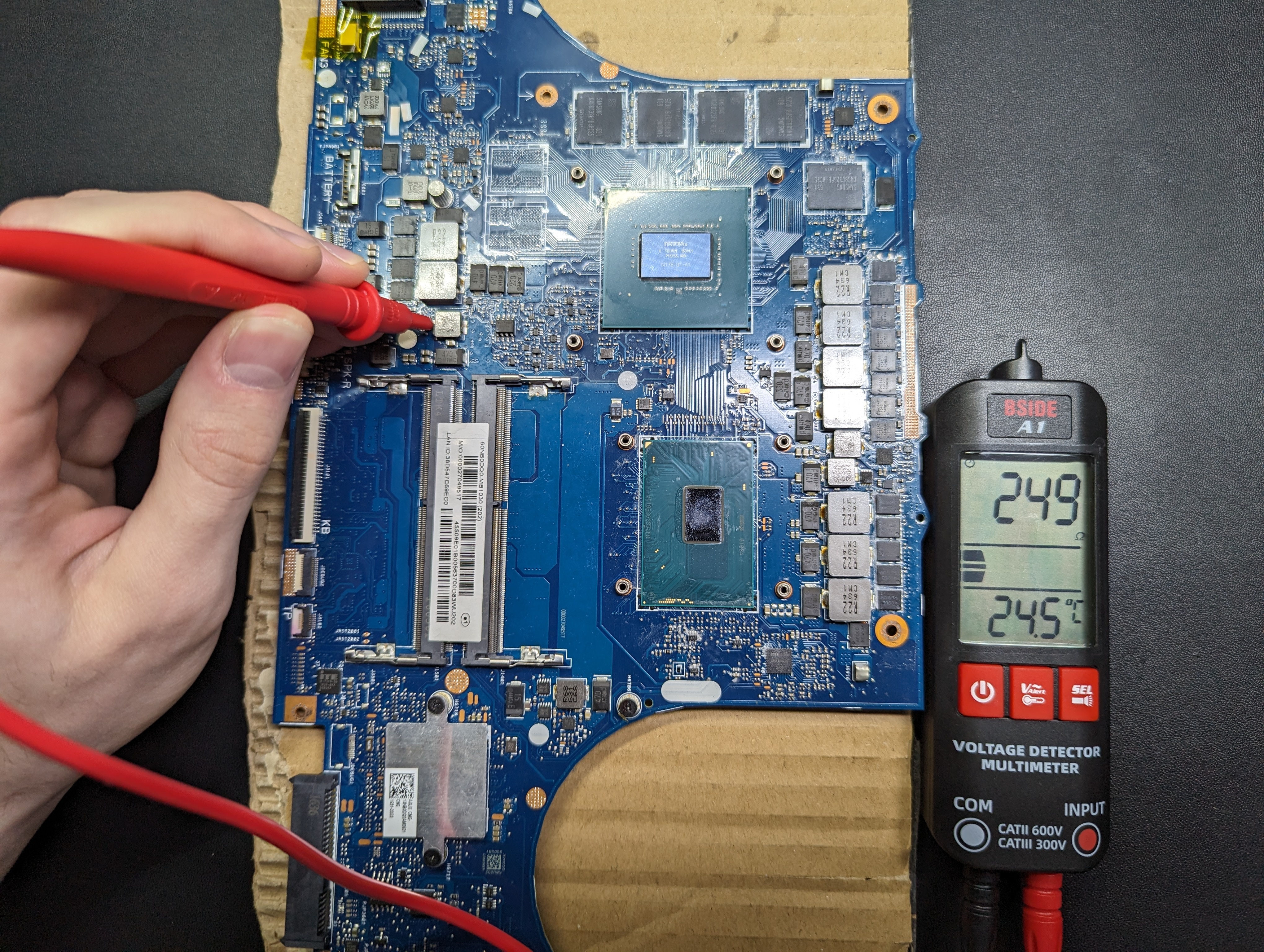

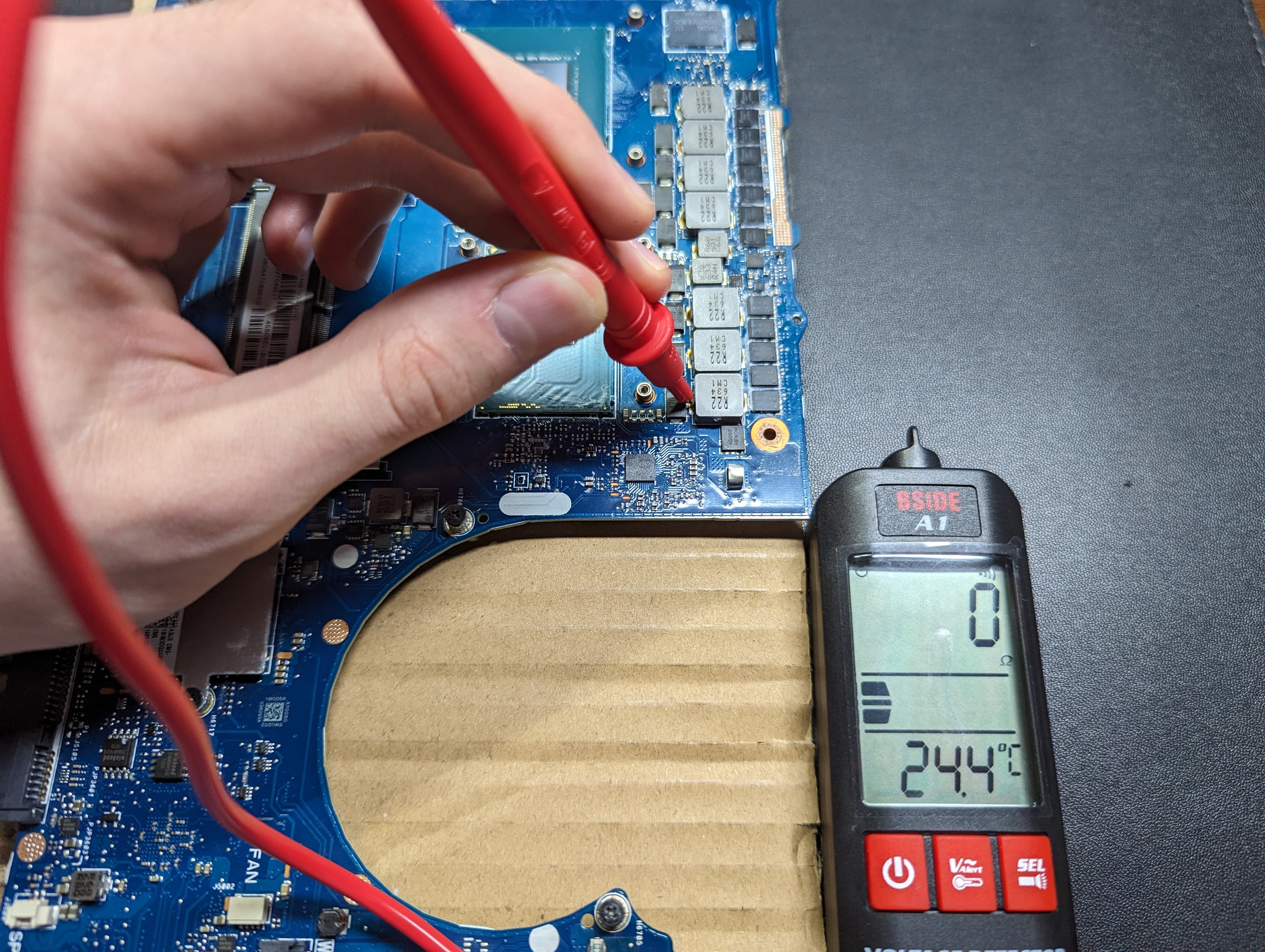

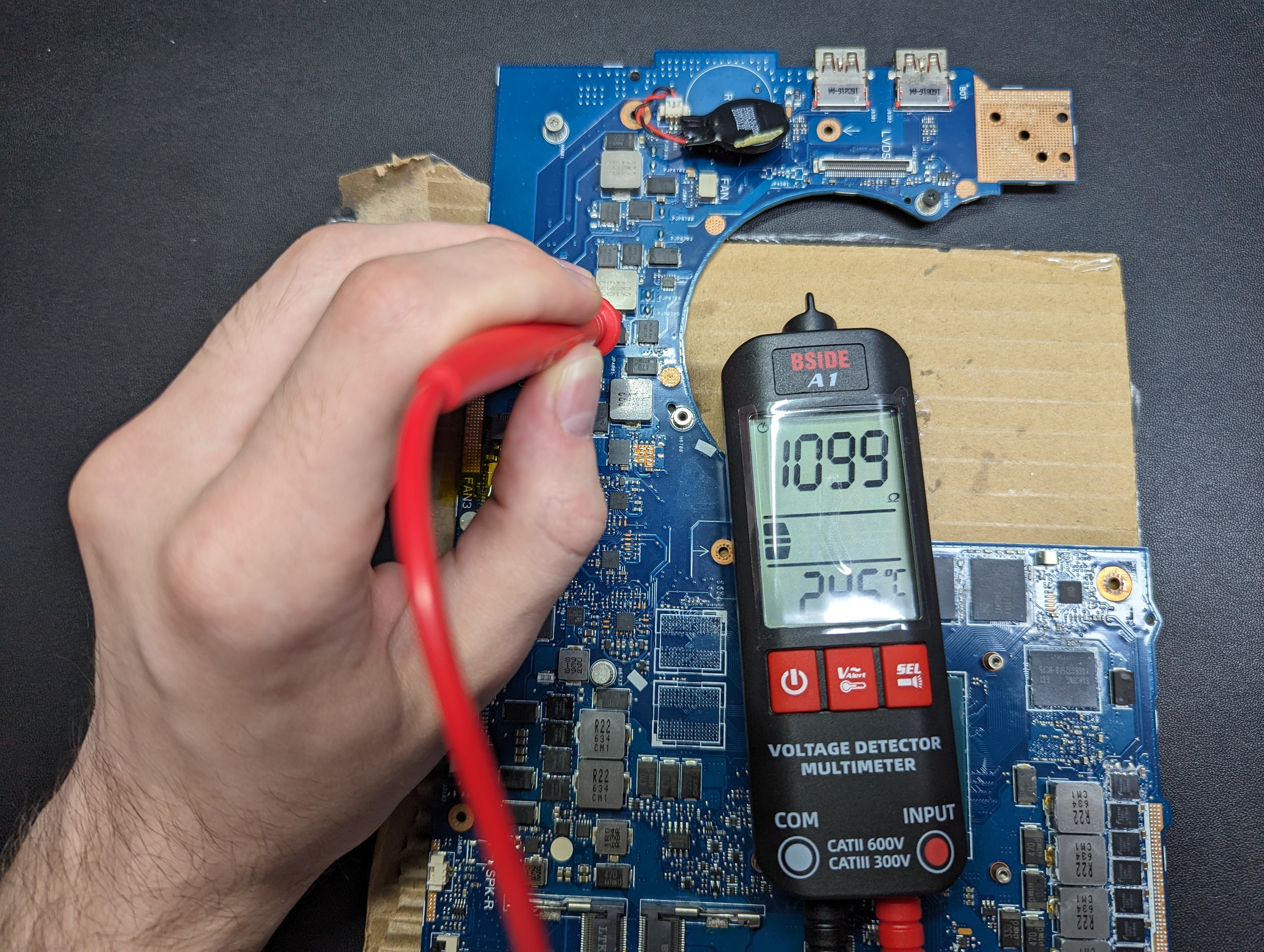

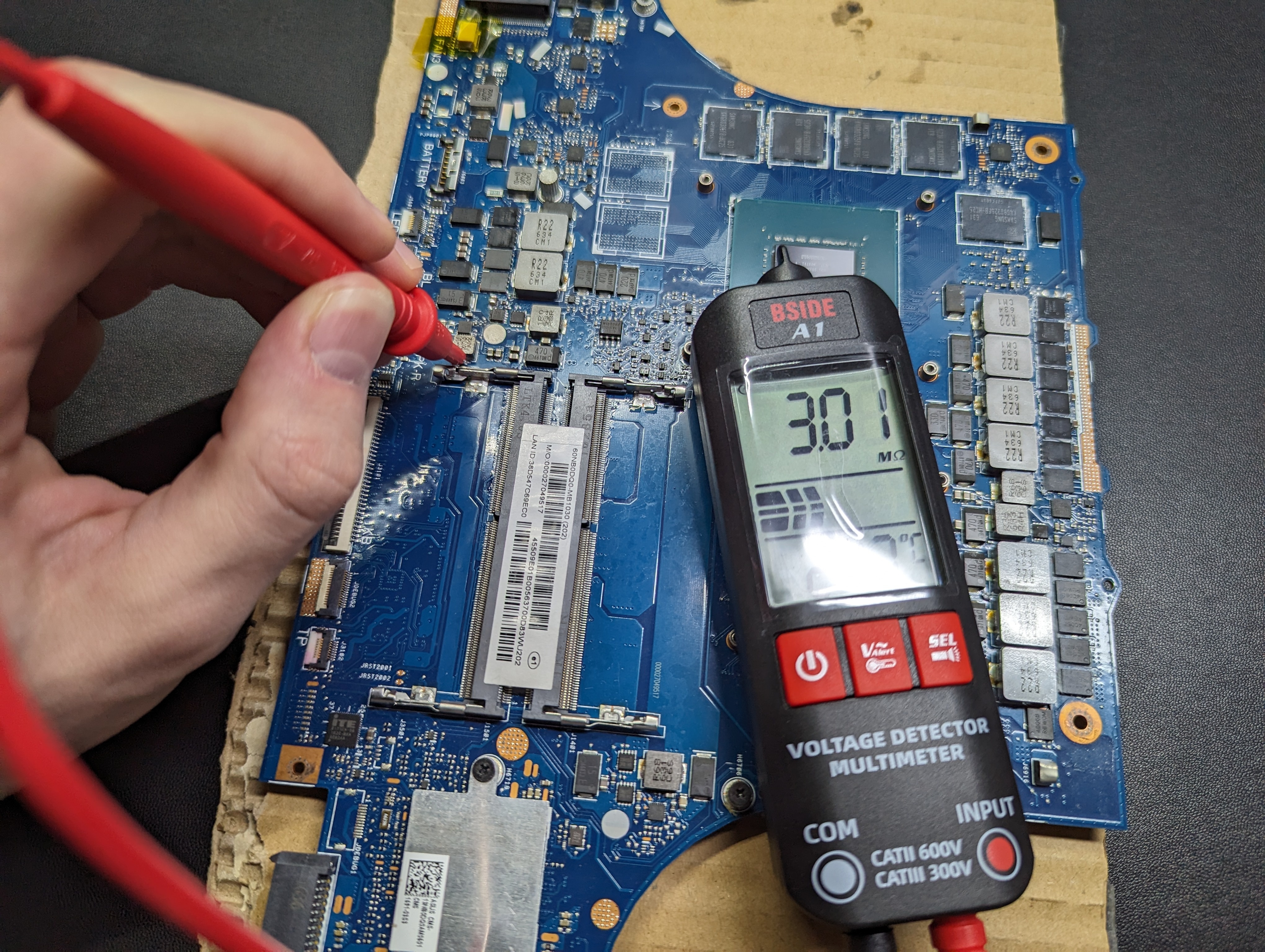

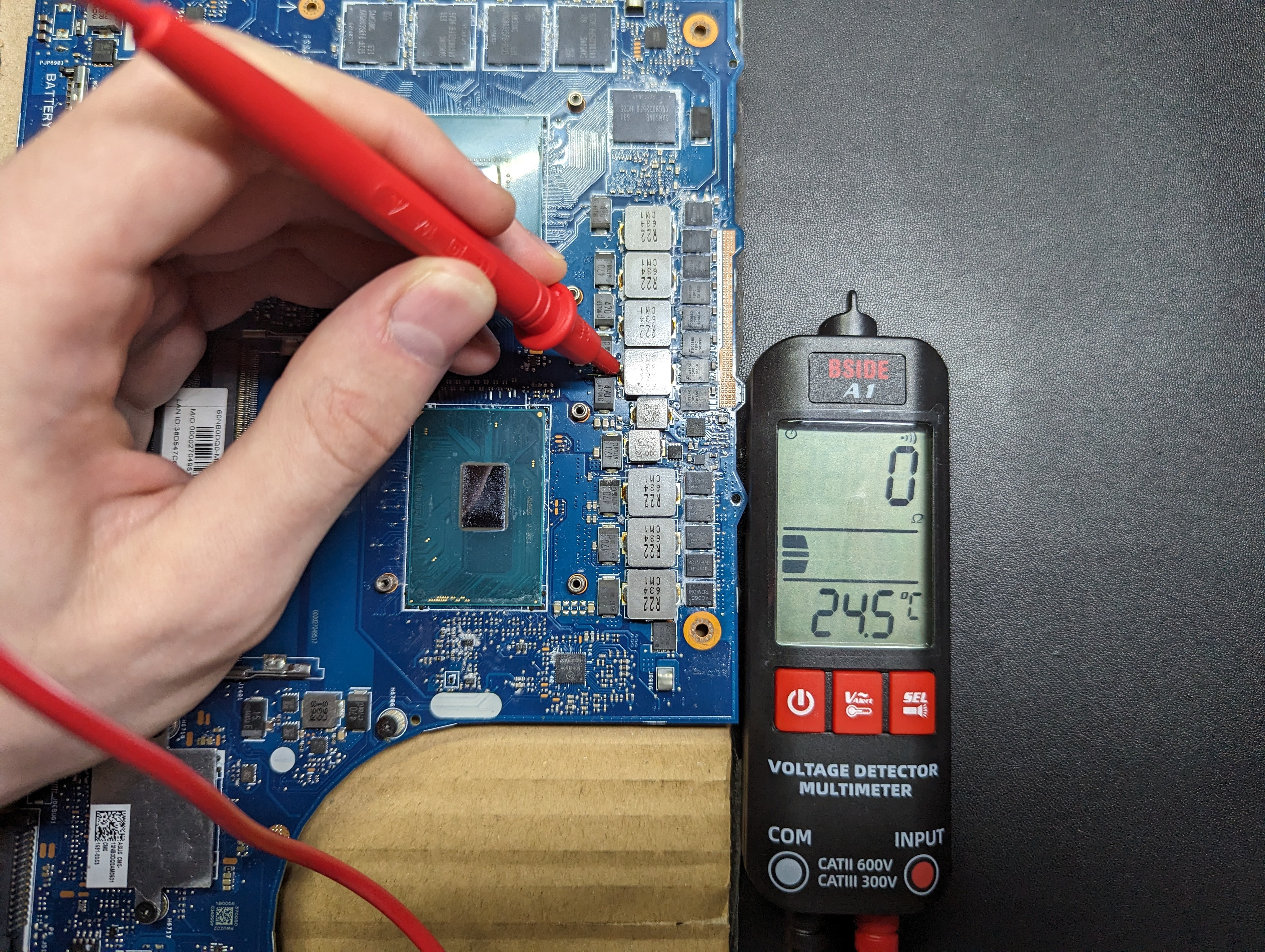

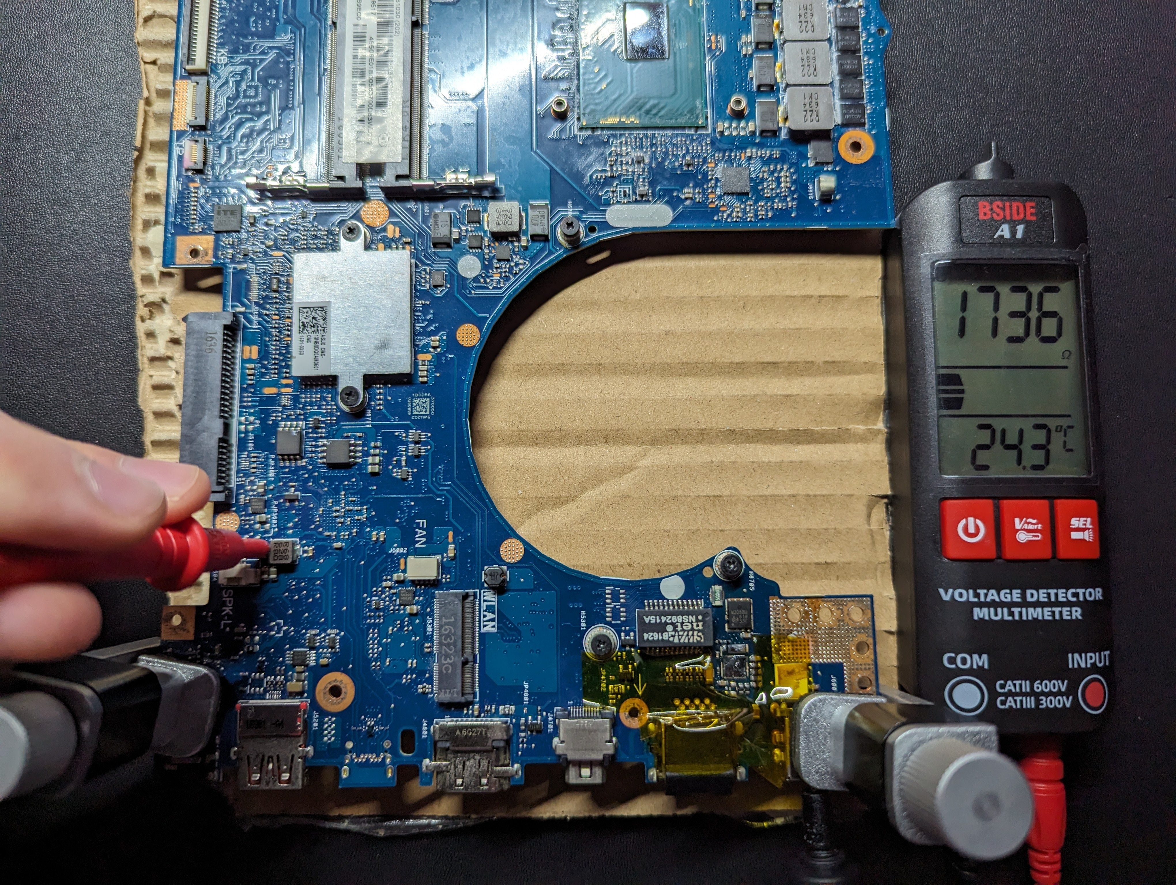

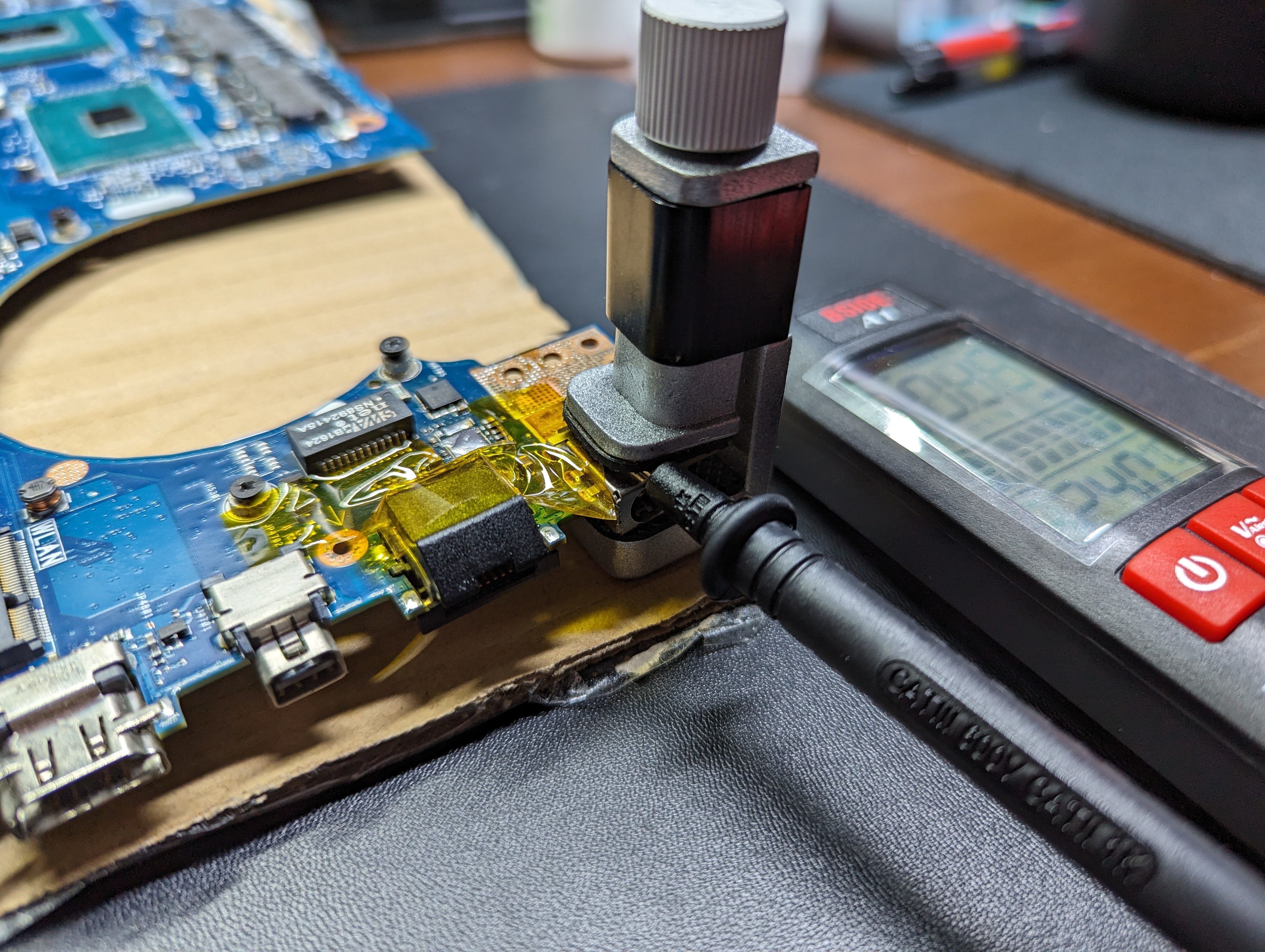

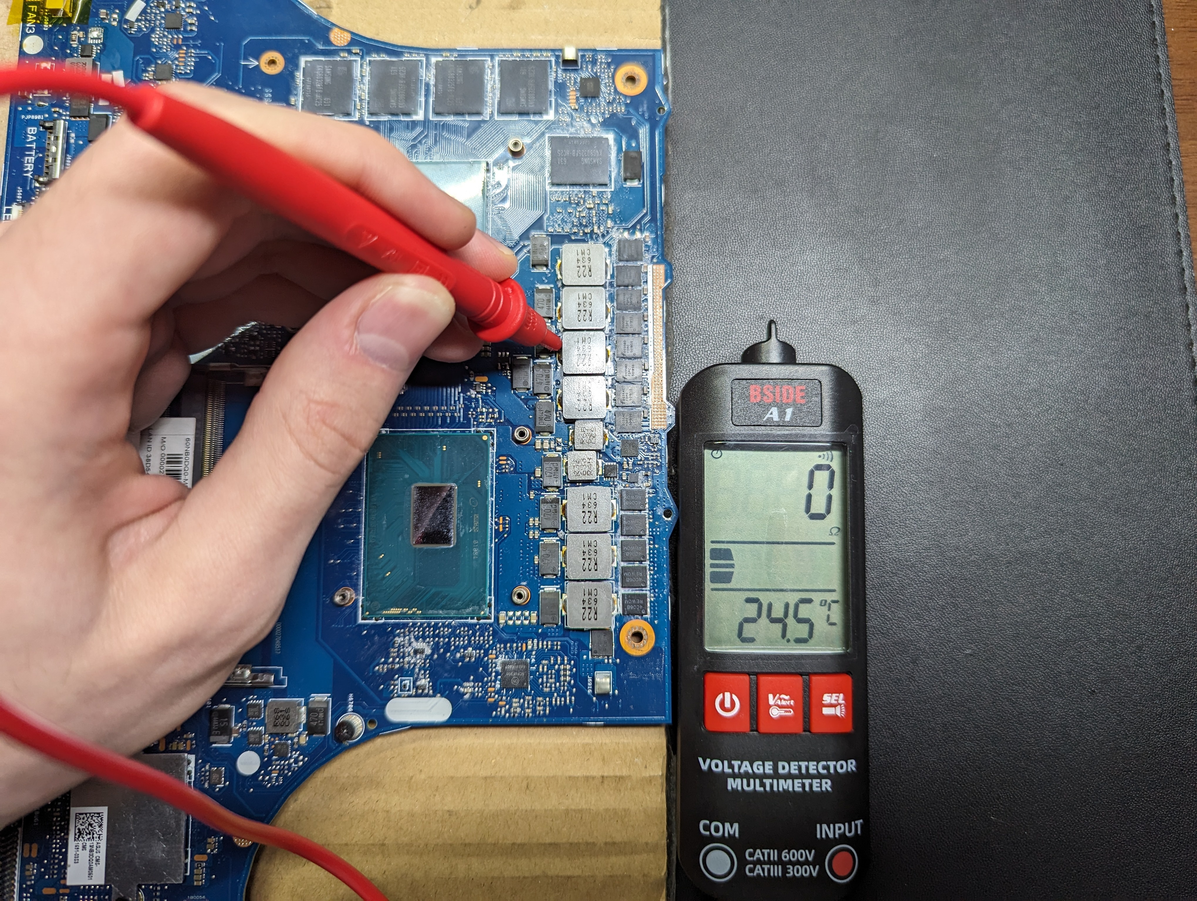

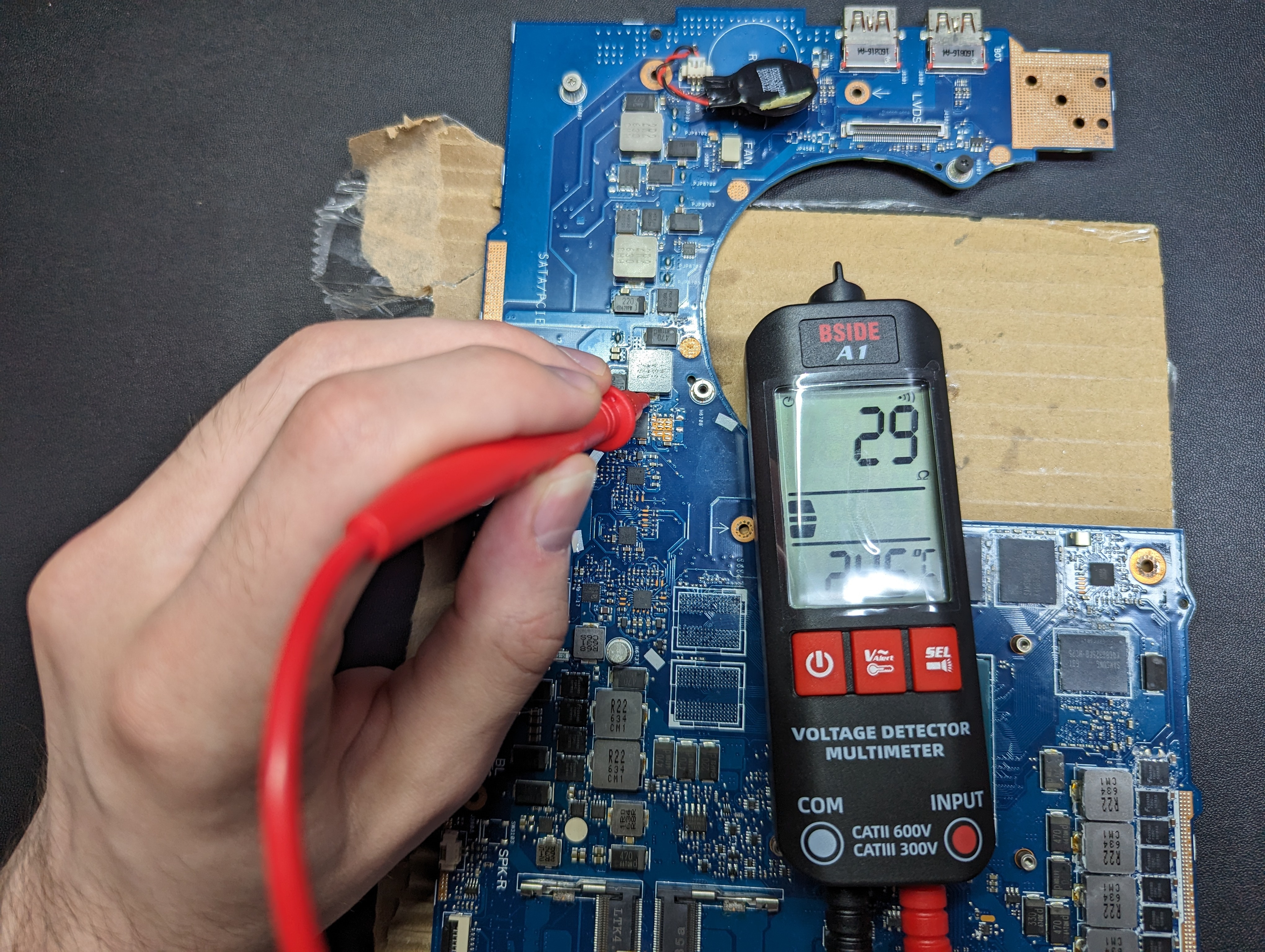

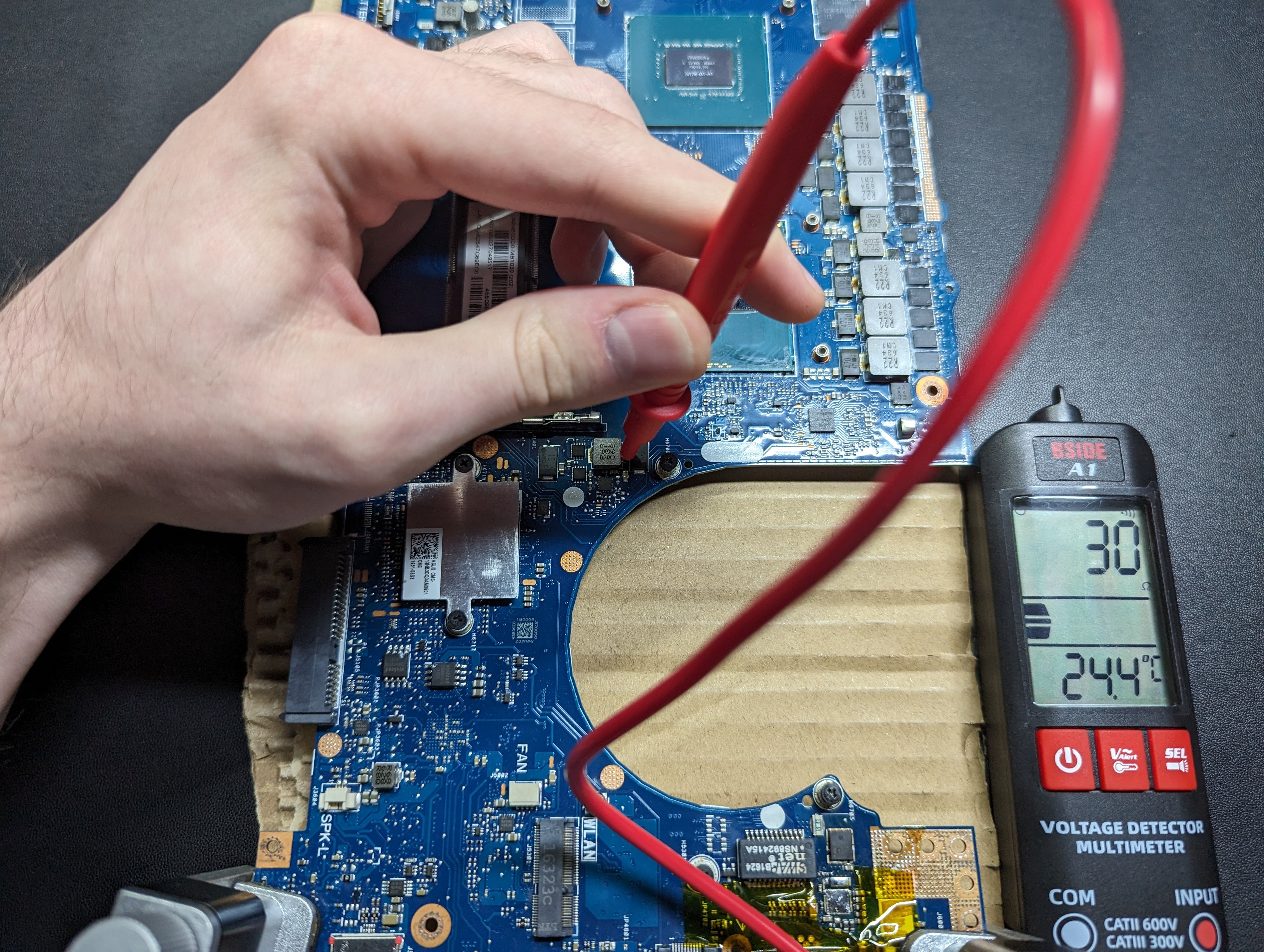

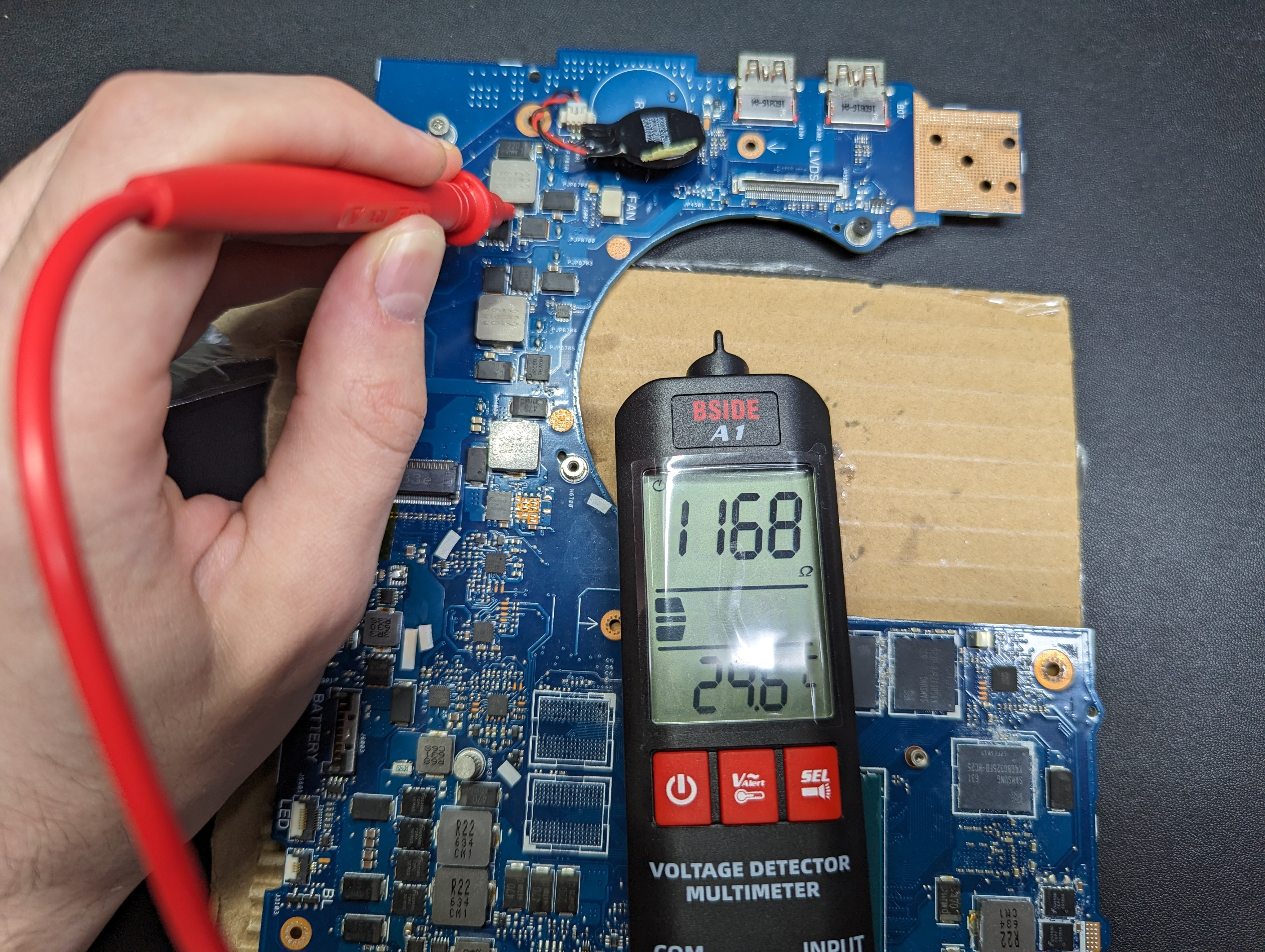

                    Post a pic of the front face of your meter while measuring one of the 0 ohms to ground. Something else may be wrong if you are reading 0 ohms on so many coils.

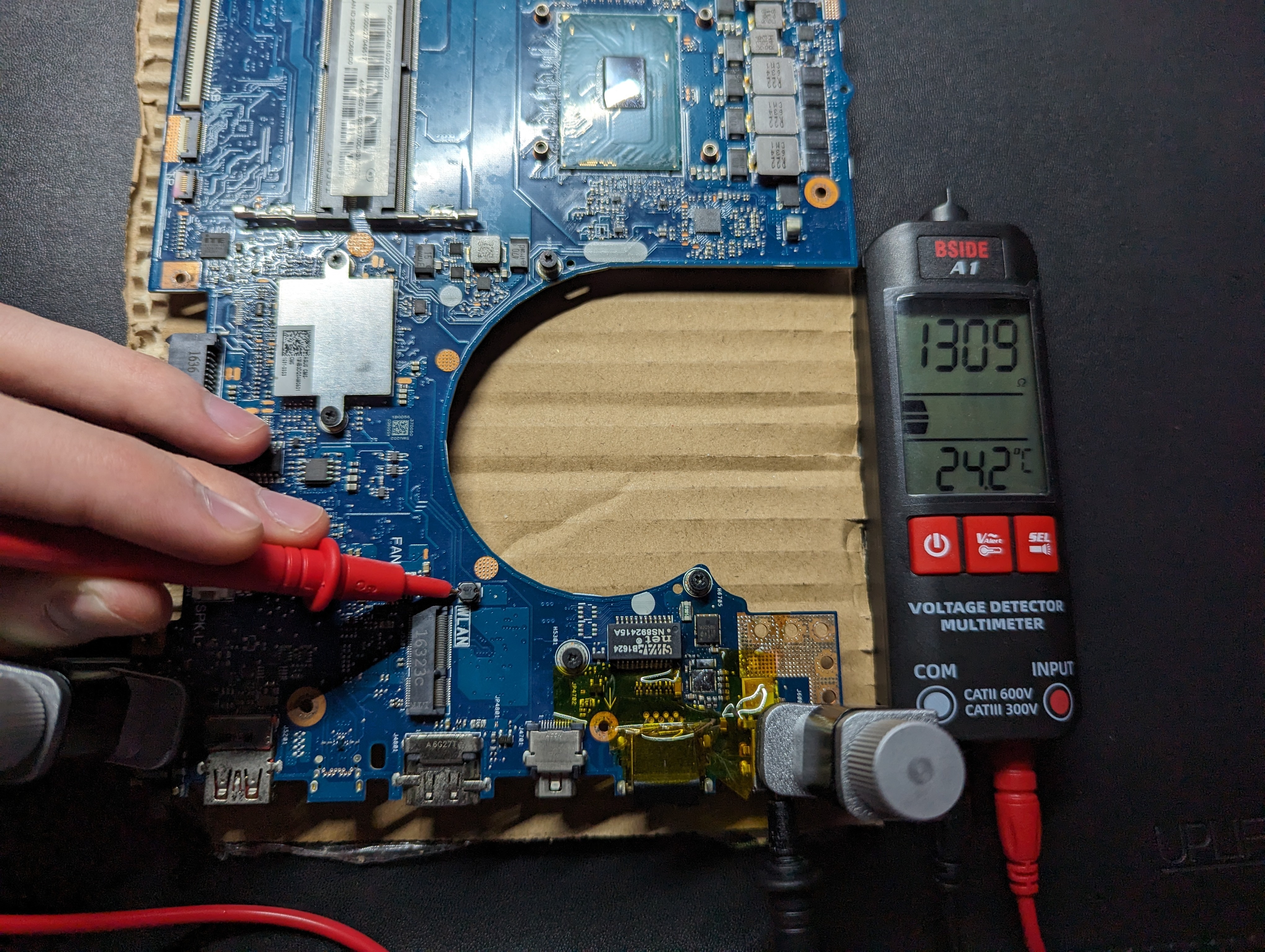

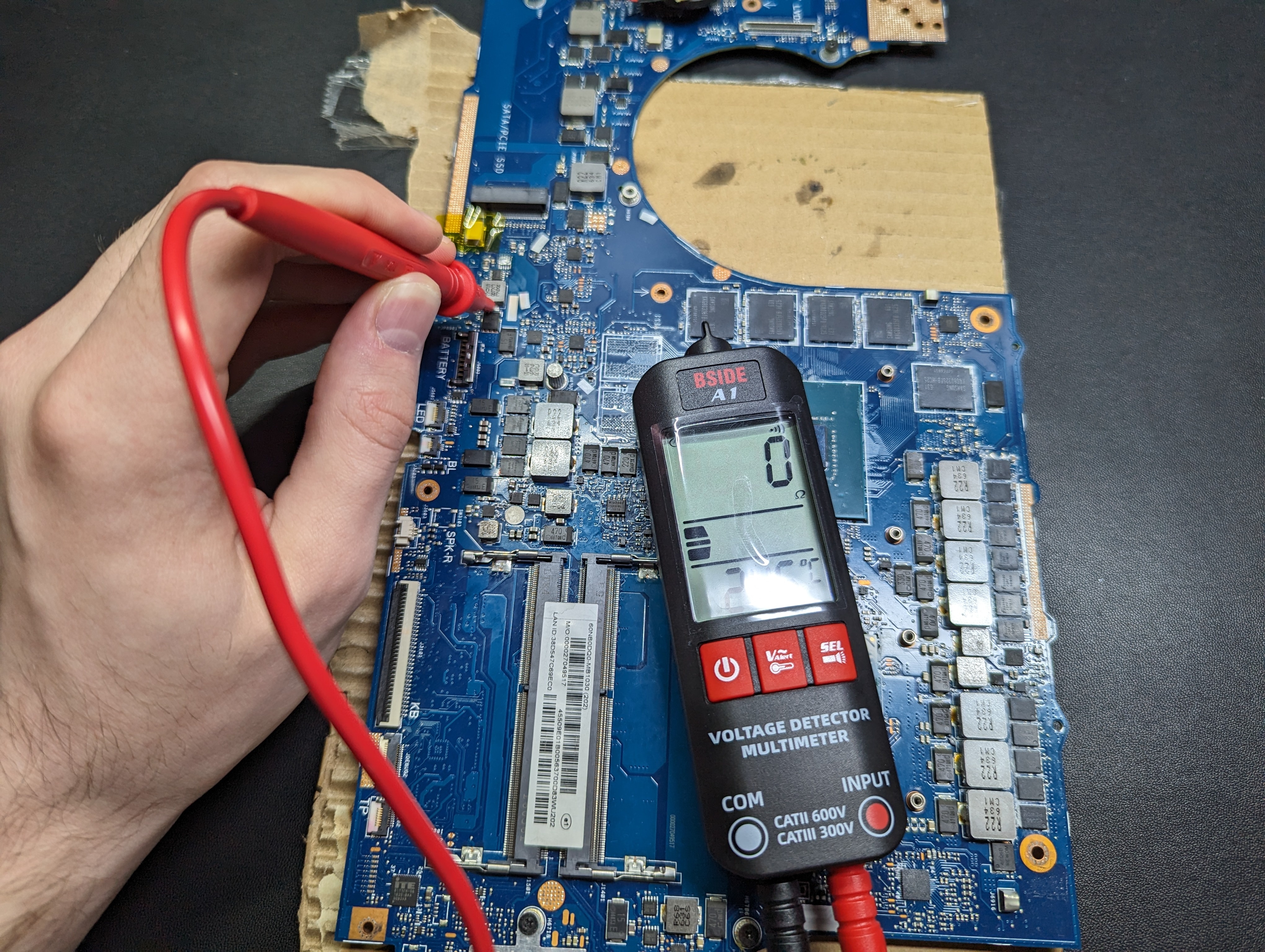

                      Attaching the pictures of resistances from inductors to ground and a boardview.
                        #31
                        CPU Core supply measuring 0 Ohms usually means a dead CPU, except there "just" went something very wrong with your capacitor replacement. But it stongly looks like a typical high-side short.
                        Charging rail measuring 0 Ohms explains the not charging battery. However, from my understanding there is no point to proceed with the repair attempt. Even of you fix the problem in the charging circuit, you can't do anything for the CPU anymore.
