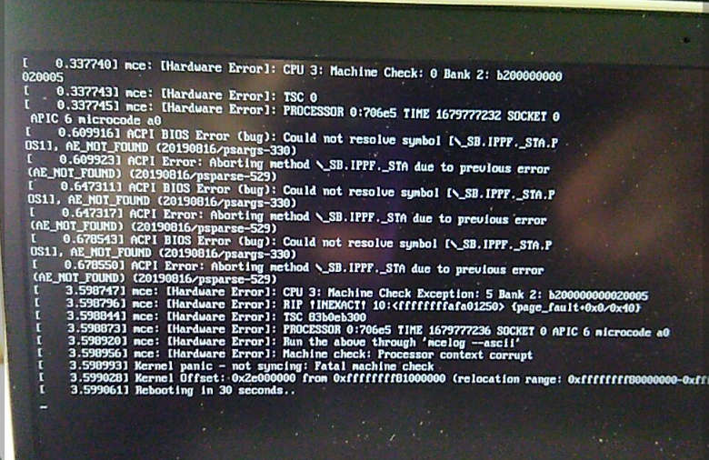

                  Hi, I have replaced the Richtek RT3612EB today with a new one, and still crashes in windows and Linux, but ms-dos works well.
                  Hi, I have replaced the output mosfets and tantalum capacitor, and still the same. I have not replacement for coils now.
                  Booting a BlackArch linux iso via Ventoy, it still crashes, but looking at the screen error messages seems that cpu is damaged.
                  I don't know what messages can say, so I hope someone in the forum can read that messages in the photo attached, and tell what it is about.
                  Thanks in advance.

                    #29
                    As a matter of last resort,replace the coils and see if the voltage drops a bit on coils. It may be the cpu is overheating and resulting in panic kernel.

                      #30
                      Hi, have some interesting news.
                      laptop has been working for a few hours and can confirm that voltage on vcore is too much higher than it should be.
                      In bios setup screen vcore was 0.8 volts and in windows login screen it was 0.6 volts during that few hours.
                      So I think it should be a problem with a resistor o capacitor from the feedback circuit.
                      I have tested some resistor but seems to be good all of them, but without schematic is very difficult to follow the circuit.
                      Could be an internal cpu voltage sensor problem?
