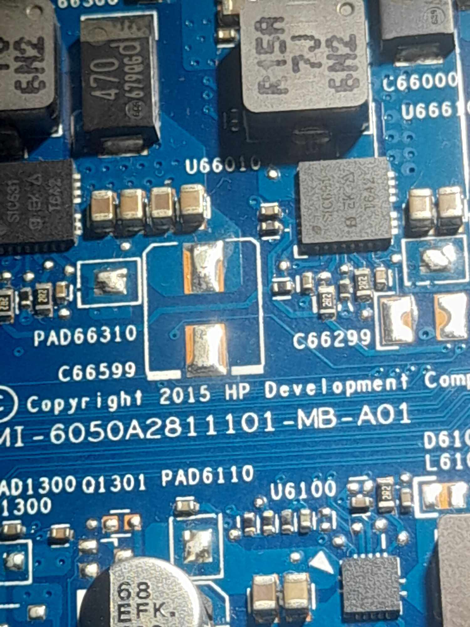

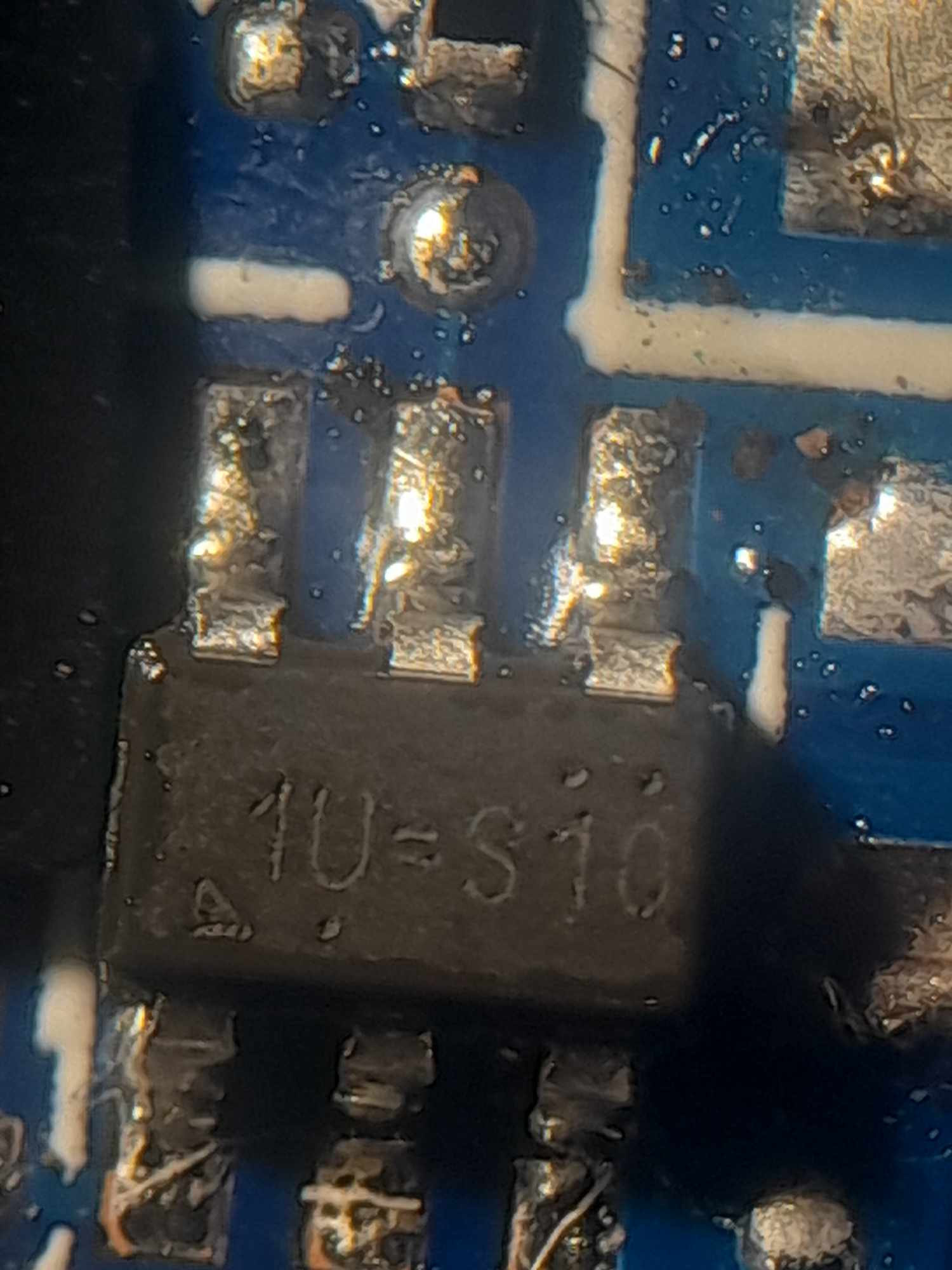

Does anyone know what is this chip attached please
HP MI-6050A2811101-MB-A01 what is this chip
Tags: None
Add full laptop model name in thread title, and write/type motherboard model number at description, don't be lazy.
Must be Richtek RT8097ALGE -> Marking code 1U=***Attached Files----------------------------------------------------------------------------------------------------------------------------------------------------------
