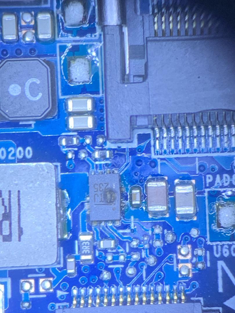

this board short on 5v rail...what name of this ic ya? ...board number 6050A2945601-MB-A01
help recognize ic part hp elitebook 840 g5
Most probably it's a Monolithic Power Systems (MPS) NB679GD 5V-8A Buck Converter , marking code ALTAttached Filesif you find these attachements useful please consider making a small donation to the site
