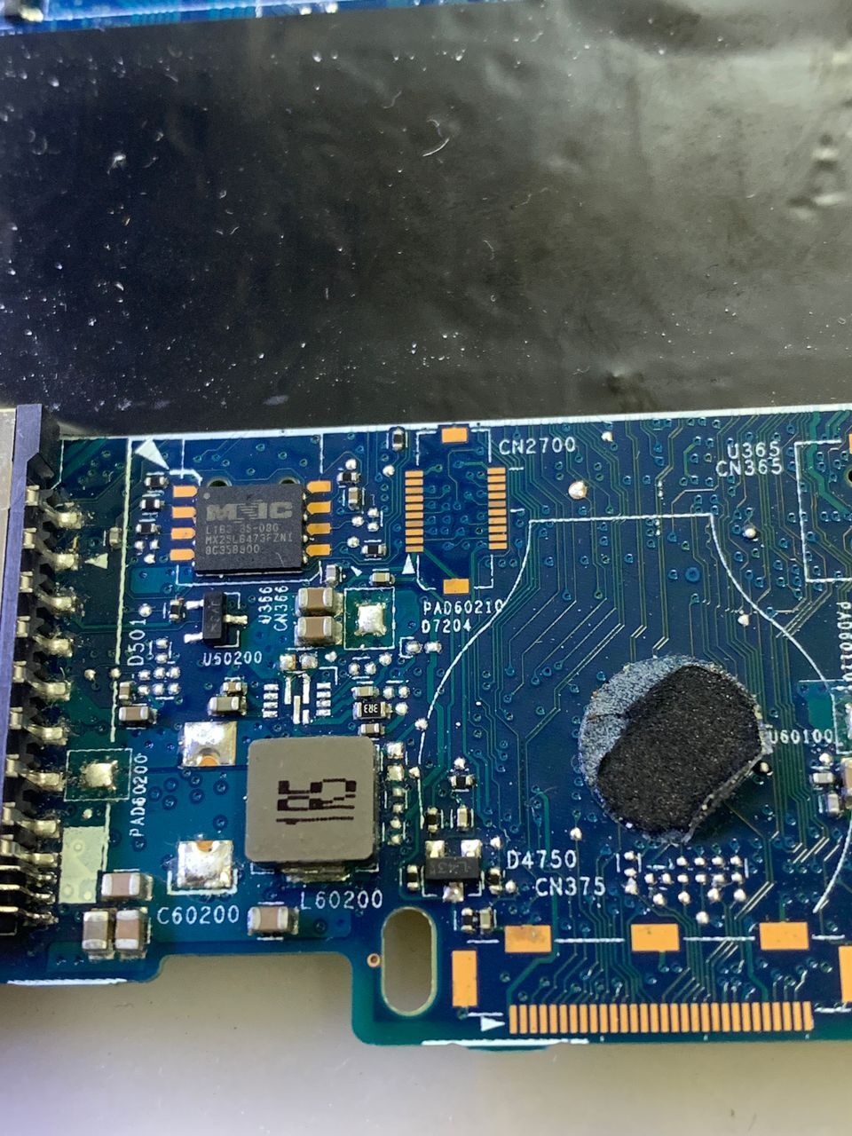

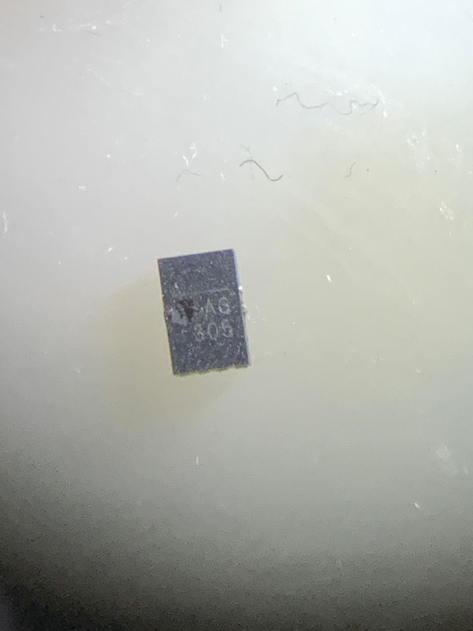

help identify ic part hp elitebook 840 g3
  • dqtech
    Badcaps
    • Jul 2018
    • 640
    • N/A
    ic burn half.....board number 6050a2822301
  • dqtech
    Badcaps
    • Jul 2018
    • 640
    • N/A
    i have NB679 @ ALT ...is this compatible??
    • dqtech
      Badcaps
      • Jul 2018
      • 640
      • N/A
      latest update:
      i replace with NB679 and laptop working just fine..just found out that areas is 5v rail and nb679 is 5v ic
        There is no schematic available for this model, but according to this post - "L60200 = 5v", i.e. this IC must be exactly a Monolithic Power Systems (MPS) NB679GD 5V-8A Buck Converter , marking code ALT.

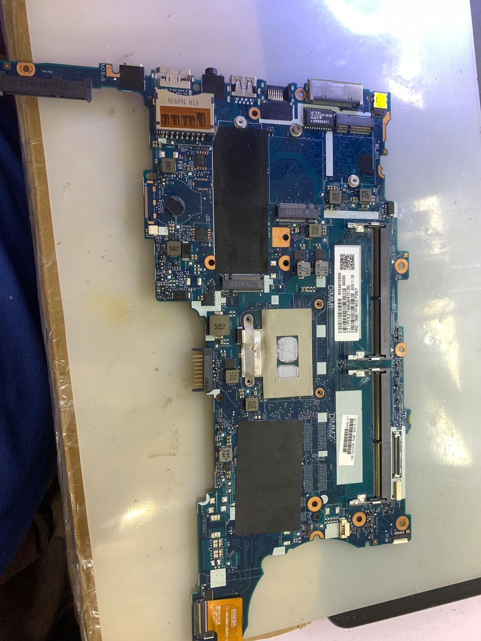

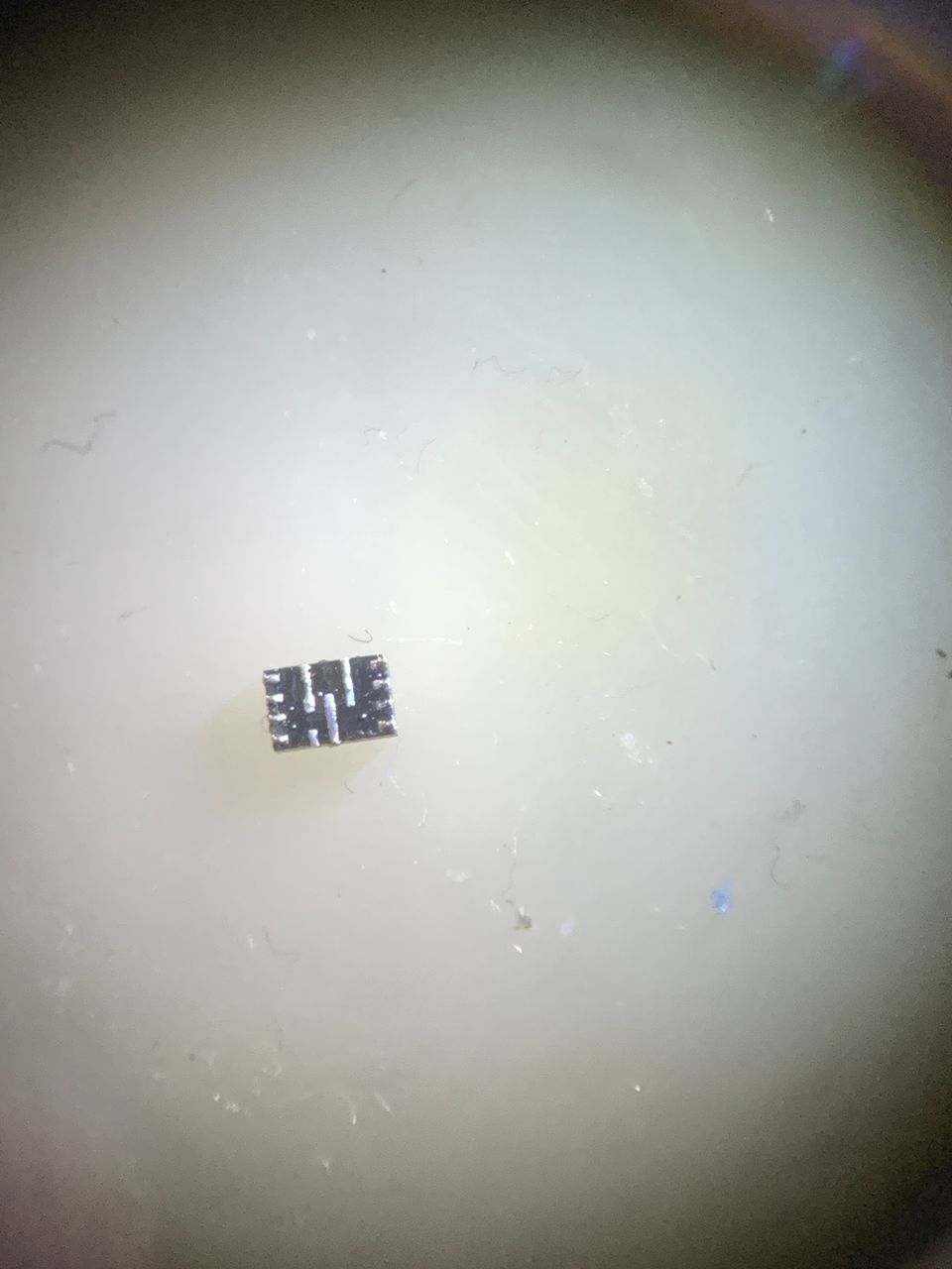

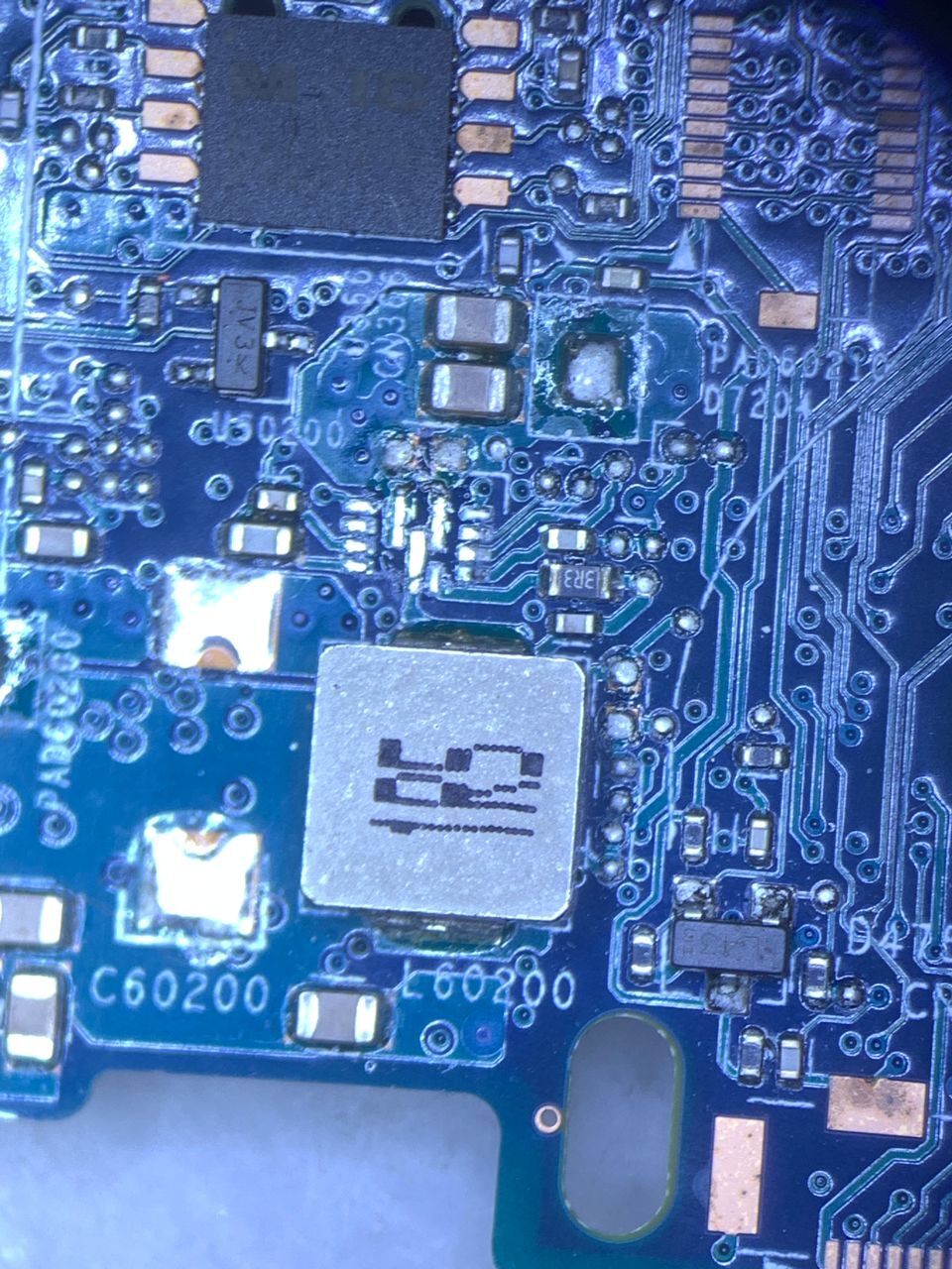

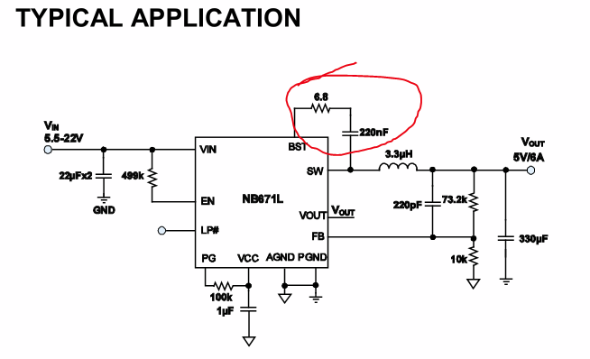

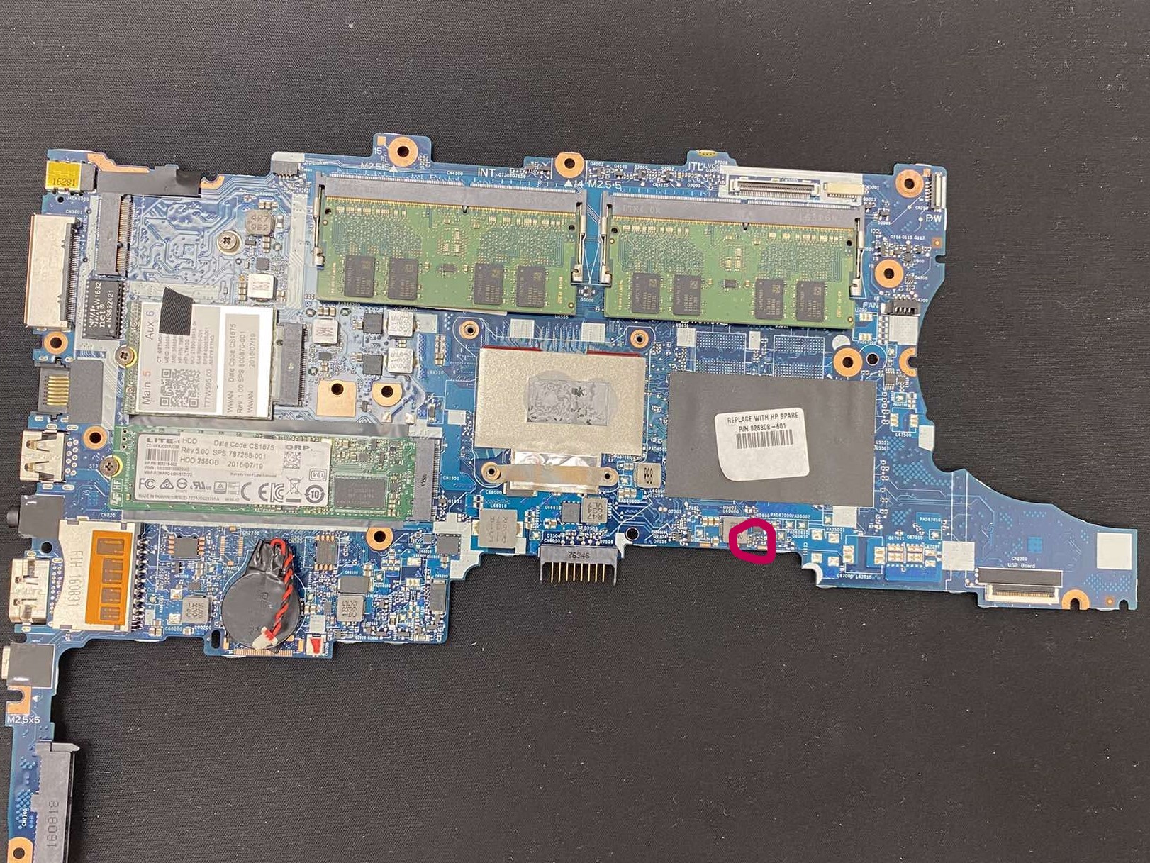

          HP Elitebook 840 G3 6050A2822301-MB-A01 help identify part
            • 22080
            The QFN IC is a Monolithic Power NB671LGQ ,datasheet https://www.datasheets360.com/pdf/8164110733501024792 .In the Typical application layout ,pin 10 BST ​has a 6.8 ohm resistor and a 220nF cap
            • piszpunta
              • Jan 2019
              • 255
              • poland
              I replaced it, it works thx
