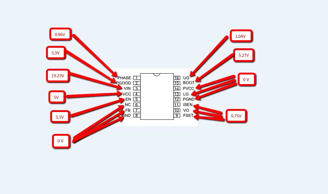

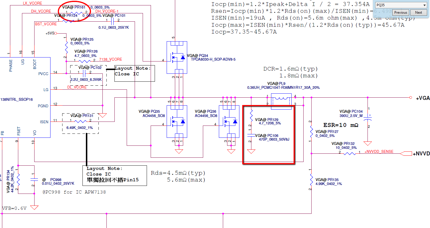

    Hi, i need help with acer 5742G (it is Compal NEW71 LA-5893P)
    Laptop wont start when connected LVDS. When i disconnect LVDS fan start spin, no picture on VGA output.
    I found that i hava 0.94V on PQ36 and PQ35. and i have 4 Ohm D to S
    I check PQ36 and PQ35 them they have no leakage

    i check PU998

                can you tell me what mean VGA@ xxx i cannot find the cap and resistor

                  10 ohm is too small. 3V on 10 ohm, meaning it should consume 300mA. Why no picture - maybe it will not show to vga by default, maybe gpu problems. Try another panel first.

                          PU998 output is 0.96V, should be ok for vga core. If possible reprogram ec and bios.
