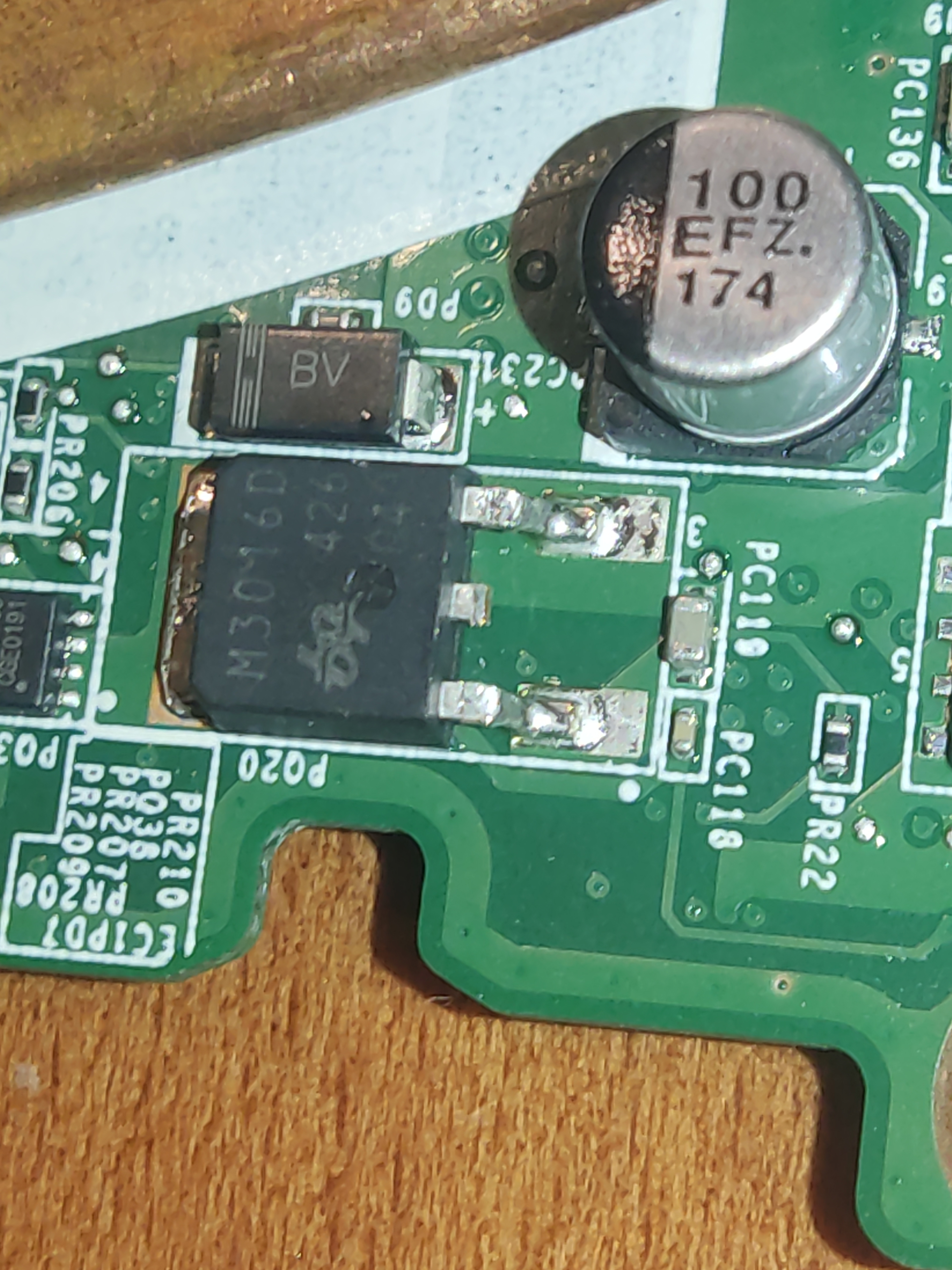

    Ok I found some screwdrivers today and opened this laptop
    I starting detaching all peripheral sockets one by one and also both ram modules too and testing in between all steps. No luck. I ended with only the mb and the pwr cable, and it still shows the same symptom
    I found these board online (day11amb6e0 rev e with i7 4510u) but too expensive for what they are
    Does anyone have any knowledge about this issue or have any pointer on what to start checking?

        Thanks I found the schematic

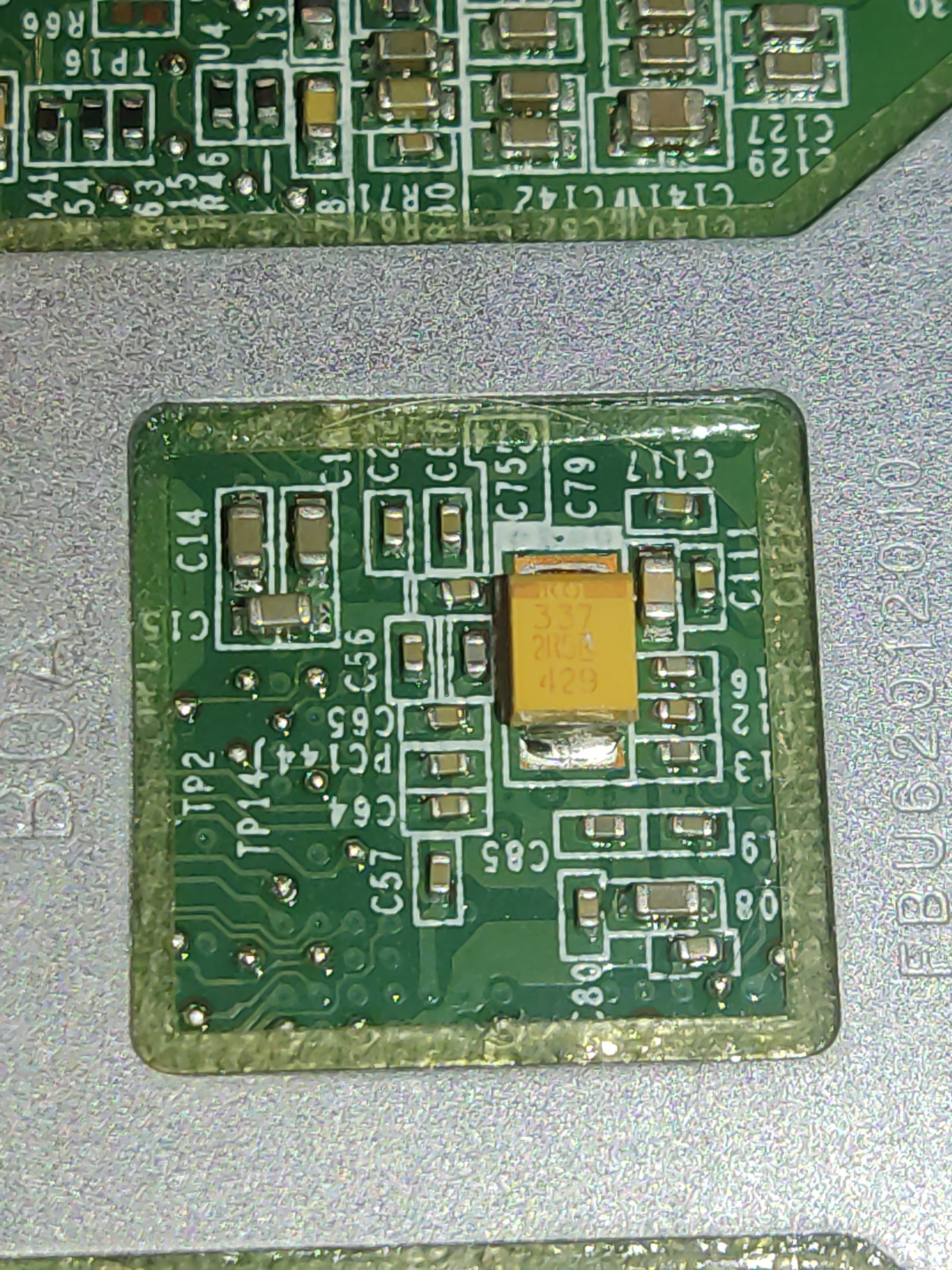

        Before I found your reply I already tested something and it's weird...
        Under the VGA ic, Nvidia, theres a bunch of small capacitor around a larger yellow cap labeled c79, I measured across this one with no power and it had 25ohm to gnd. Seems too low. It drives the +vgacore voltage.
        I checked this voltage while DC was in the charge plug and mb was trying to boot up and it was pulsing from 0 to 900mv until one time where the power stayed up.
        After several tries I realized that it does continue to boot up (nothing connected to MB to I can't really check what's actually going on or not) as soon as I touch the +vgacore with my multimeter points. How could this be? Something related to fooling the gpu_core_sense?
        Weird...I may solder a wire to this one and plug it all back in and see if the screen actually comes back

          Also specifically replying to your comment:
          01: pc147 is 14ohm, pc154 is 24ohm, pc159 os 18 ohm
          02: ad_id: 0,6v
          03: rtcrst and srtccrst can't find a place to test them, I see them at the sch but I can't find a physical pad to test them
          04 DC in MOSFET:19v, 24v, 19v. I can't find any more MOSFETs. This one is the only MOSFET I can see by the ps area
          Thanks!!!

              The resistance at C79 is correct as its expected to show low resistance. Note that cpu/gpu area will always show low resistance to GND. Since the mb is switching with 900mA current draw,there cant be any issue with RTC circuit like RTCRST#.So you can ignore this part.DC-in mosfet voltage is also correct.
              Measure voltage on all big grey coils when powered on.
              Check DRAMRST# is present or not on pin30 of ram slot.

                I got it to power up with the trick of moving stuff around c79
                voltage at coils:
                • around ps input I get 1.4v and 3v
                • Close to CPU and VGA I get all three coils 0.9v
                • Close to USB ports I get 3.3v and 5v. But close to this last one, c747 has 0v across....all the other large caps have the same voltage as their neighbor coil
                Is there and easy and safe place to probe dramrst?
                I don't have a thermal camera but by touching I can't feel any overheating area ..
                thanks!

                  Very weird now: I realized that in order to get it to continue booting (not really booting, read below) it's not actually about messing with the multimeter around c79 but about pushing over the back side of the area between CPU and Nvidia IC (middle point between both heatsinks arms)
                  I may be wrong but this sounds to me like reflowing?? Which I can't do as I don't have the proper gear...
                  When I say continue booting I mean that the power led stays on all the time, the fan keeps running at different speeds, and I can hold the pwr button down for ten seconds for it to shut off properly. But I don't see a real boot as I tried this all again back into its case and connected to ram, hd, LCD, battery and everything and no signs of life...LCD stayed off as if nothing was connected to it.
