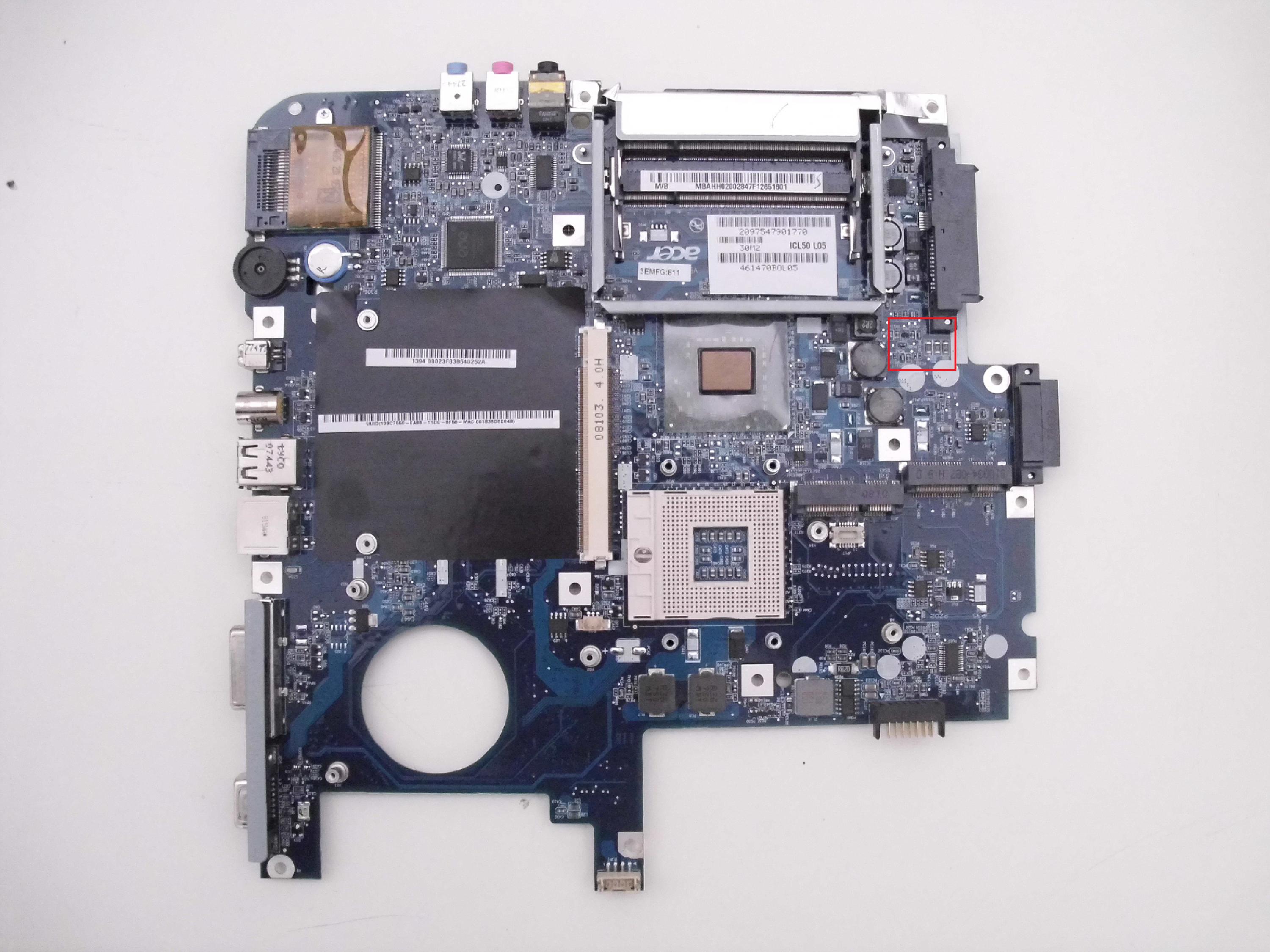

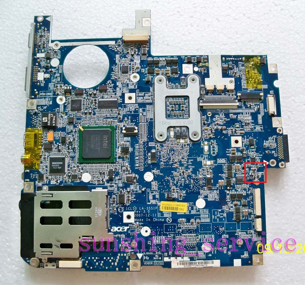

          Re: My laptop acer aspire 5720zg dead (no power and lights)
          I mark two place where getting hot. I don't have motherboard scheme, then I can't check 3V and 5V. Can you give the address or show on the motherboard where I need to check 3V and 5V.
          • lezsimply
            The Wanderer
            • Jan 2013
            • 657
            • Philippines
            Check PL3 for 3.3v_alw and PL4 for 5v_alw, voltages must be present.
            Look for PU3 (MAX8744E) thats your 5v and 3.3v regulator IC. Schem added. hope this helps...
            • povilas602
              • Jan 2014
              • 10
              • nera
              PL3 0.01 and PL4 0.07V, but for PU3 i don't understand what pin I must check for 5V and 3V...
                        Now I checked PU3 PIN21 is 3.3V, but in #5 comment picture i mark two place where getting hot. Maybe PD2,PR2,PR3,PR4,PR5,PR6,PR7,PR8 in this place heat up. PL2 3.2V.
