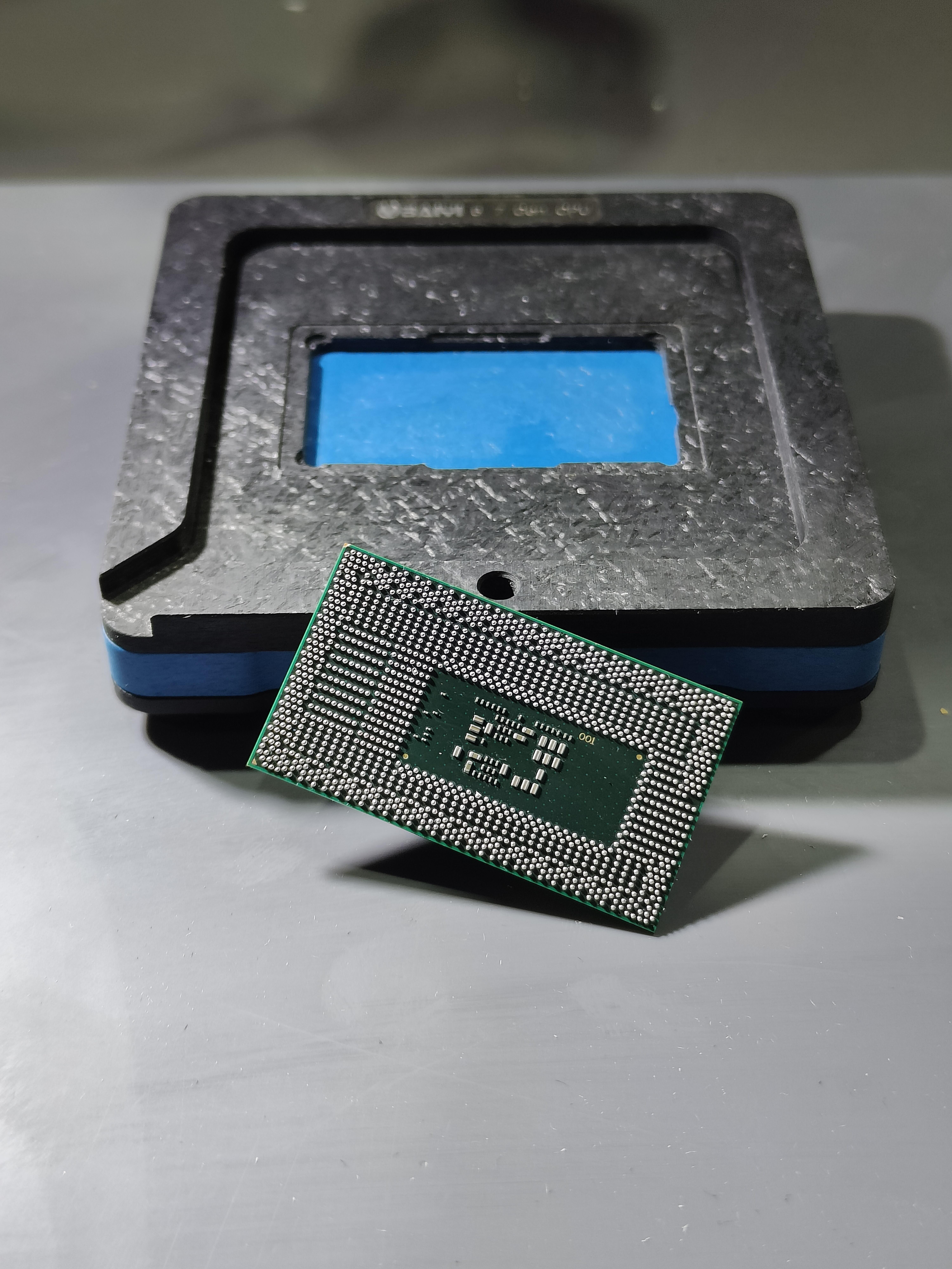

    Hello friends.
    Has anyone ever try and succeed replacing a consumer grade CPU with something removed from a corporate one?
    I have plenty of sr2f1 cpus that are %100 in working condition , ID like to use them in consumer laptops as replacements
    Is it possible-compatible / bios-wise ?

    I've tried this on two completely different motherboards , no luck. Updated CPU microcode, transferred ME Region from one to other. Looks like i'm missing something.

      Intel Boot Guard

        Thanks for the reply. Can you suggest any workaround for this spesific issue?
        If you're referring cleaning the me region with factory me firmware , i've already done that.

          Boot Guard cant be removed by cleaning me firmware.However, i dont have the knowhow to remove bootguard so far.

            Thats bad. I have 55 of SR2F1 they're perfectly fine. Does that mean that i can not use them on consumer boards 😞

              Boot Guard public key hash is fused into the PCH by the laptop manufacturer, it cannot be removed. BIOS must be signed with the laptop manufacturer's private key. If Verified Boot is enabled, it won't run the BIOS if it is unsigned or signed with a different key. UEFITool NE can be used to check if BIOS is signed and what is the public key. On a running system, MEInfo (from Intel System Tools) can be used to check what is fused into the PCH.
              If private key has leaked it might be possible to sign any BIOS but I haven't seen it done yet.

                Thats pretty much sums it up what i gathered researching all night.
                AMI v2 protected ranges hash file found at base 00F2BF40h

                This is what i get from the dump file that i got from the board which i removed the CPU. SR2F1 - LA-E131P
