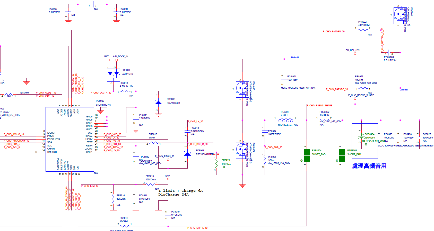

    I have come across the problem with ASUS ROG G712LU. BOARD IS G532LWS.
    Laptop is working ok on AC but it has problem with battery. In BIOS battery shows always 100%. Laptop is not turning on battery.
    I can see charging voltage 8.44V on PRS8902, as soon as I connect the battery it'll become 0.44V
    Voltages I measured.
    P_CHG_SCL_5 3.3v
    P_CHG_SCL_5 3.3v
    P_CHG_BATDRV_20 - without battery connection 8.4v
    Anyone can help me to resolve the problem?
  • mon2
    • Dec 2019
    • 14662
    Start with a known good battery. Amazon is good for returns if the battery is not required. Your smbus line voltages are fine. The bms board inside the battery could be defective or rigged to spew out the 100% charge value when it is not.

  • saisoni20
    • Feb 2022
    • 116
    mon2, Thanks.
    With new battery it works perfectly fine.
