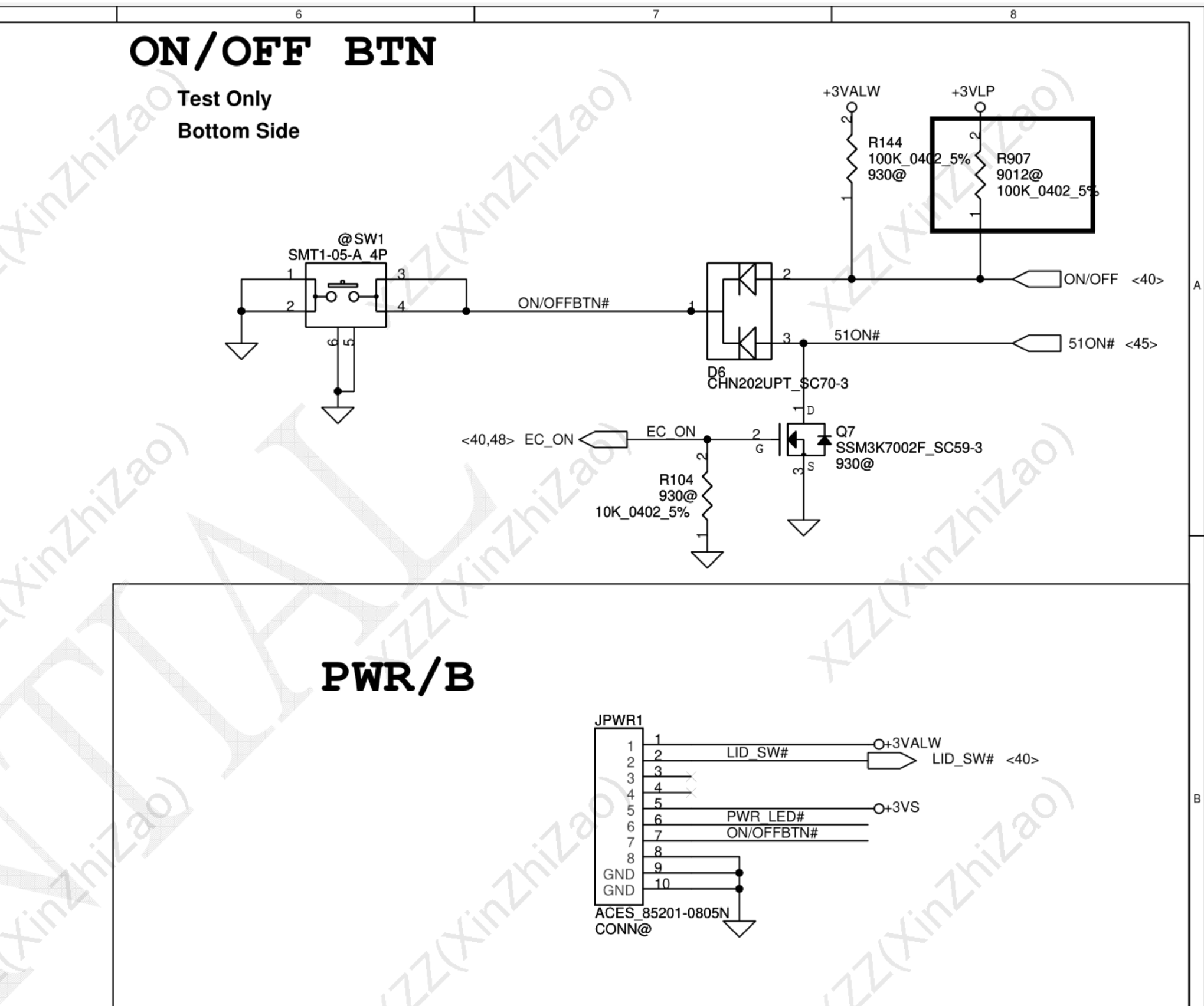

            Would you have the attached parts on your board? This is from the Acer Aspire v3-571G schematics in my database.

            Not sure I fully understand. There is PWR button as a part of keypad, as we spoke above.Not separated.
            I enclosed a picture of the mainboard
              ON/OFFBTN# is SWK1 Click image for larger version

                Do you mean there might be an alternative/another way how to start the laptop?Via SWK1 ?
                • mon2
                  • Dec 2019
                  • 14216
                  Yes.

                    I tried to start the laptop via SWK1 but still the same behaviour - the laptop did not start.
                    Do you think it can be BIOS problem or SuperIO or different problem?
