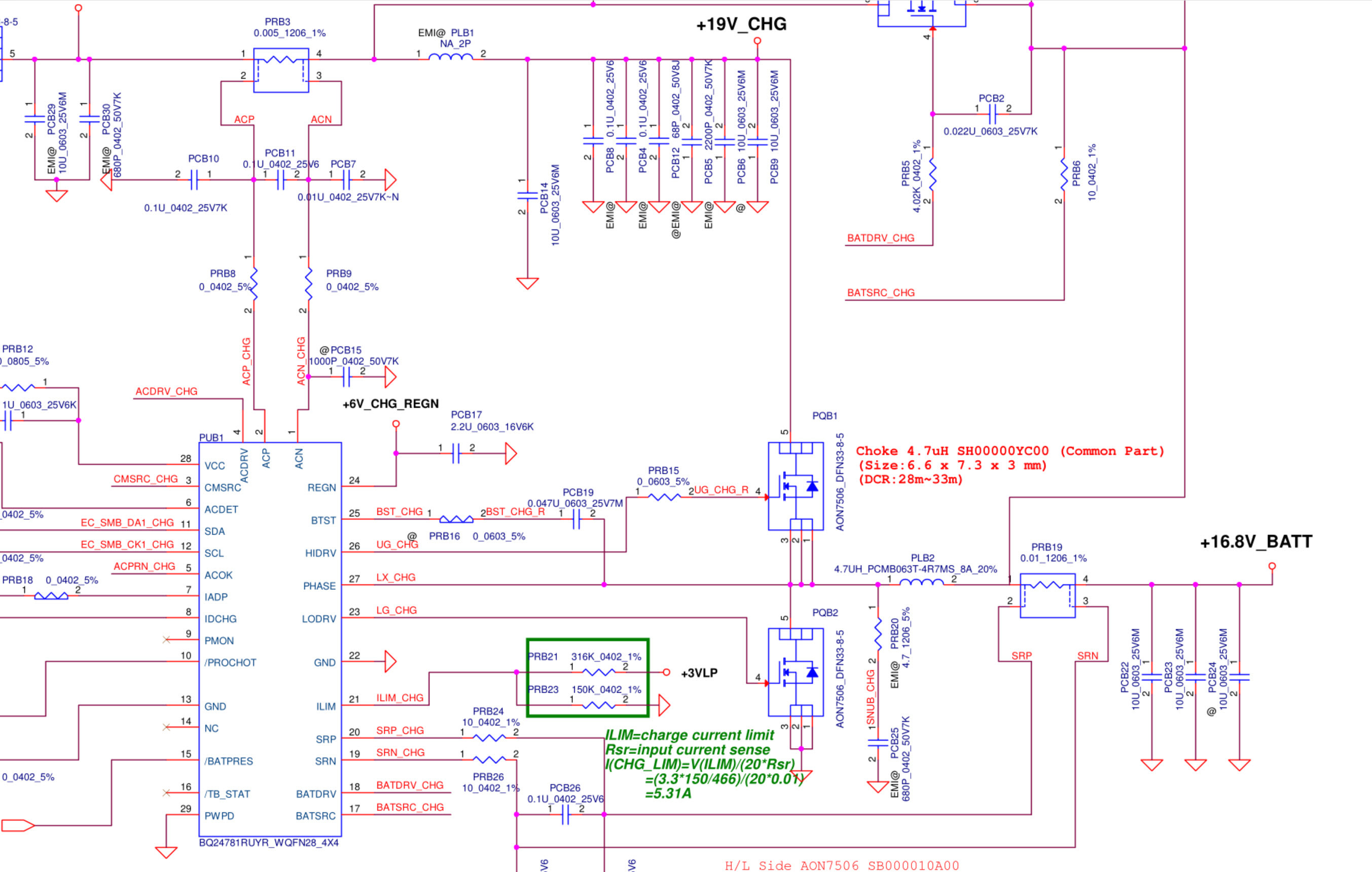

    Hi, I got this laptop with a dead GPU and i have replaced the moderboard same model
    The problem the new motherboard does not charge the battery. The faulty motherboard is charging.
    In windows the battery is presend and if i plug in the charger is detected
    All voltages are present
    What i have done :
    -i have replaced the BQ chip
    -i have replaced the IO chip with the IO chip fron the faulty motherboard
    -i have replaced the bios chip with the one from faulty motherboard
    Nothng has changed
    Any other ideea?

    With care, measure and post the voltage to ground of each pin on the BQ charger IC for a review. Do attach the power adapter and battery for this review.
    Questions:
    1) Same charger IC part # was used for the replacement?
    2) BQ and other replaced parts are properly soldered onboard?
    3) Is the battery a known good battery? It was the same battery that worked with the fault motherboard?

      Found the problem
      It was so easy but i have spent few hours to find it
      The first mosfet from the power supply circuit was shorted,so it was working like a fuse. I didn`t check as the laptop was working fine.
      Now is charging
      Thank you for your quick answwr

        Np. Your case is mentioned in the sticky above on charger circuits by piernov. Good job on the repair!!

          I did that, first thing before postig but i have missed the part with DC shorted mossfet )
