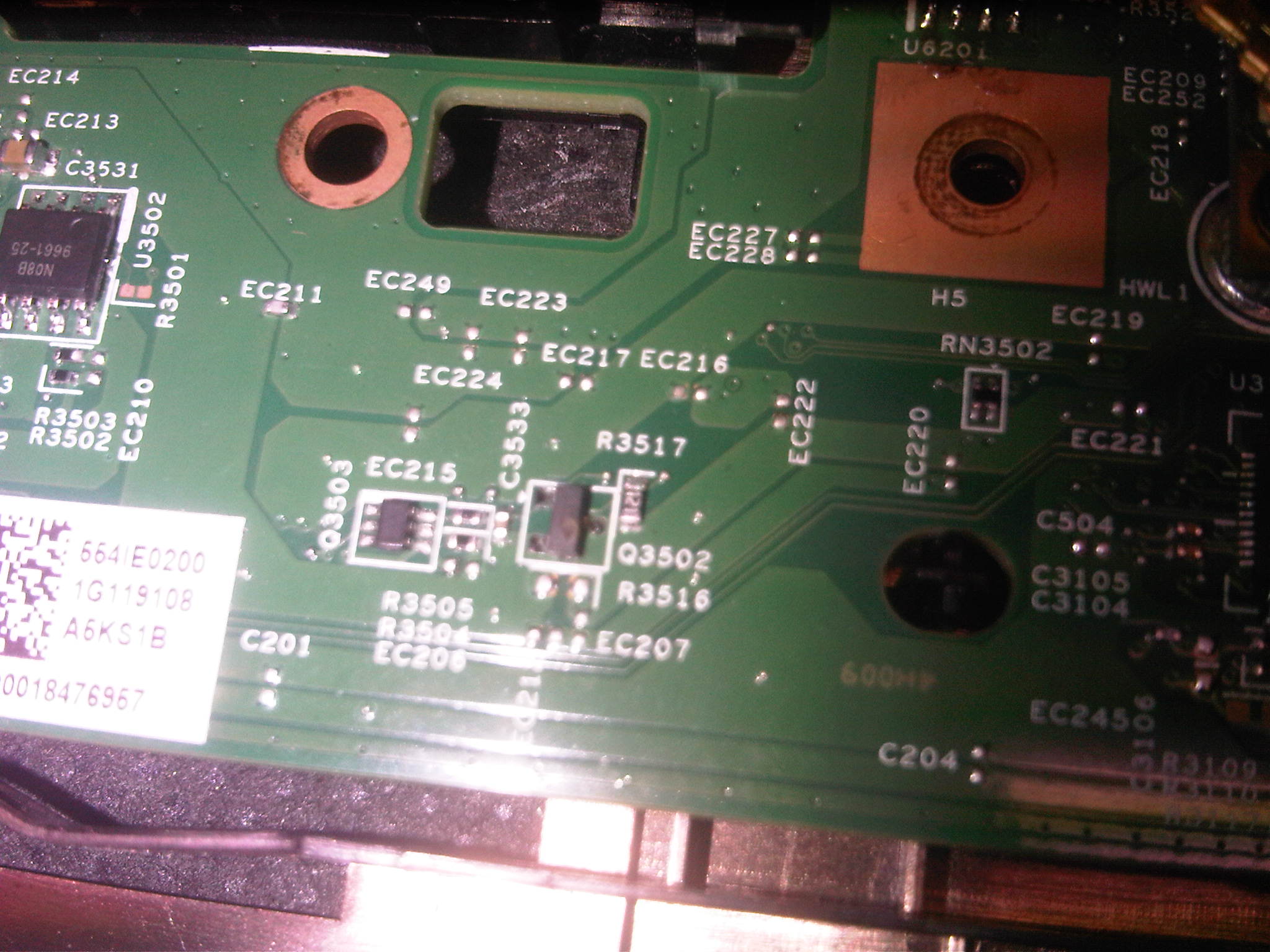

    Hy all
    Q3502
    I don't know what burn on that USB extension cuz I can't read it.
    I search the whole schematic and could not found what's that.
    On the left side with 2 pins the top leg got 1.6v and the lower one got 3.3v, on the right side the leg(only one) got 1.6 v
    I can't use any of those USB but the WiFi
    Can I just bypass the 3.3v to the right side?
    Ty

    if you cant find it in schematic, so you are looking in to a wrong schematic. if it is a switch, you can bypass it.

      ty spidey!
      i think its the wrong schematic.
      but hey i already ordered from ebay another usb board.
