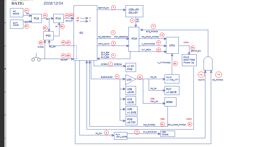

    Hi to all experts
    I really strugle with this acer aspire 5742g with intel i3-370m processor and Nvidia graphics. I have attached schematics to you if you don’t have it.
    Problem is there is no VGA voltage, all other voltages are ok. RSMRST is 3.3V so Bios and Kbc is ok. PLT_RST I have checked at wireless Lan connector at pin 22, and there is voltage. There is voltage at RAS,CAS,WE,CKE0,CKE1 pin’s at DIMM slots, so memory controller inside CPU is also ok.
    If you look at page 50. PU998, there is VIN voltage but there is no voltage at EN pin. So I have traced VGA_ON and get to page 38 and U21.
    Supply voltage is ok, but there is no DGPU_PWR_EN voltage.
    I have tryed to reprogram BIOS chip and reflow PCH, with no success.
    Don’t know if I’m looking at right direction.
    Can anybody help me with this problem ?
    Thank you very much

    With all signals and voltages you have checked, and bios reprogrammed, the solution points to a new PCH.

        Re: Acer aspire 5742g no VGA voltage
        Thanks for reply guys.
        It looks like I didn't get PLT_RST pin corectly as it is 0V
        After checking system power management pins at PCH, SYS_PWROK was missing,
        Next I checked U44 at pin 4 SYS_PWROK – no voltage. Pin 1 VGATE – 3.3V ; pin 2 EC_PWROK – 0V page no 15.
        The resistor R632 is ok, 10Kohm but mesuring at resistor gave 0.8ohm, short somewhere. I removed U44 still short on pin 2 and pin 3.
        It looks like pin 2 is conected with SIO at pin no 104. Mesuring SIO pin no 104 and ground gives below 1ohm – short.
        I tryed to bypass points at U44 pin no 5 and 4, and PCH started to work, I got PLT_RST and VGA_voltage, now all voltages are here but no display since SIO don’t comunicate with Bios.
        I think it’s SIO fault as EC_PWROK shouldnt be grounded or shorted ? It gives RSMRST voltage but it’s not 100% okay.
        What do you think ?
            U21b can also be the problem as a short at pin4 can stop ec_pwrok signal
              power on sequence
                  EC_PRWOK=SYS_POWEROK_1 because r332=0 ohm . thus a short at one will be also at the other . unless you remove r332 before check sys_powerok_1
                    power on sequence clean picture
                      U21 pin no 4 to ground is 2.1Mohm there is no short.
                      At SIO pin no 104, 106, 107 is shorted.
                      There is no R332 as seen in picture. The line goes right and down next to the first pad somewhere else but it's not shorted ?
                      The second pad where should be resistor is around 3 Ohms.
                        Originally posted by robrock1
                        do you have a diagnosis card for mini pci-x? then you could see if post is running or not. Replace 1st nvidia chip and then the kbc if possible.
                        No at hand, I'm checking Bios chip with scope...
                        I don't see connection of Nvidia chip with KBC EC_PWROK ?
                          according to the picture you are right. so try replacing sio
