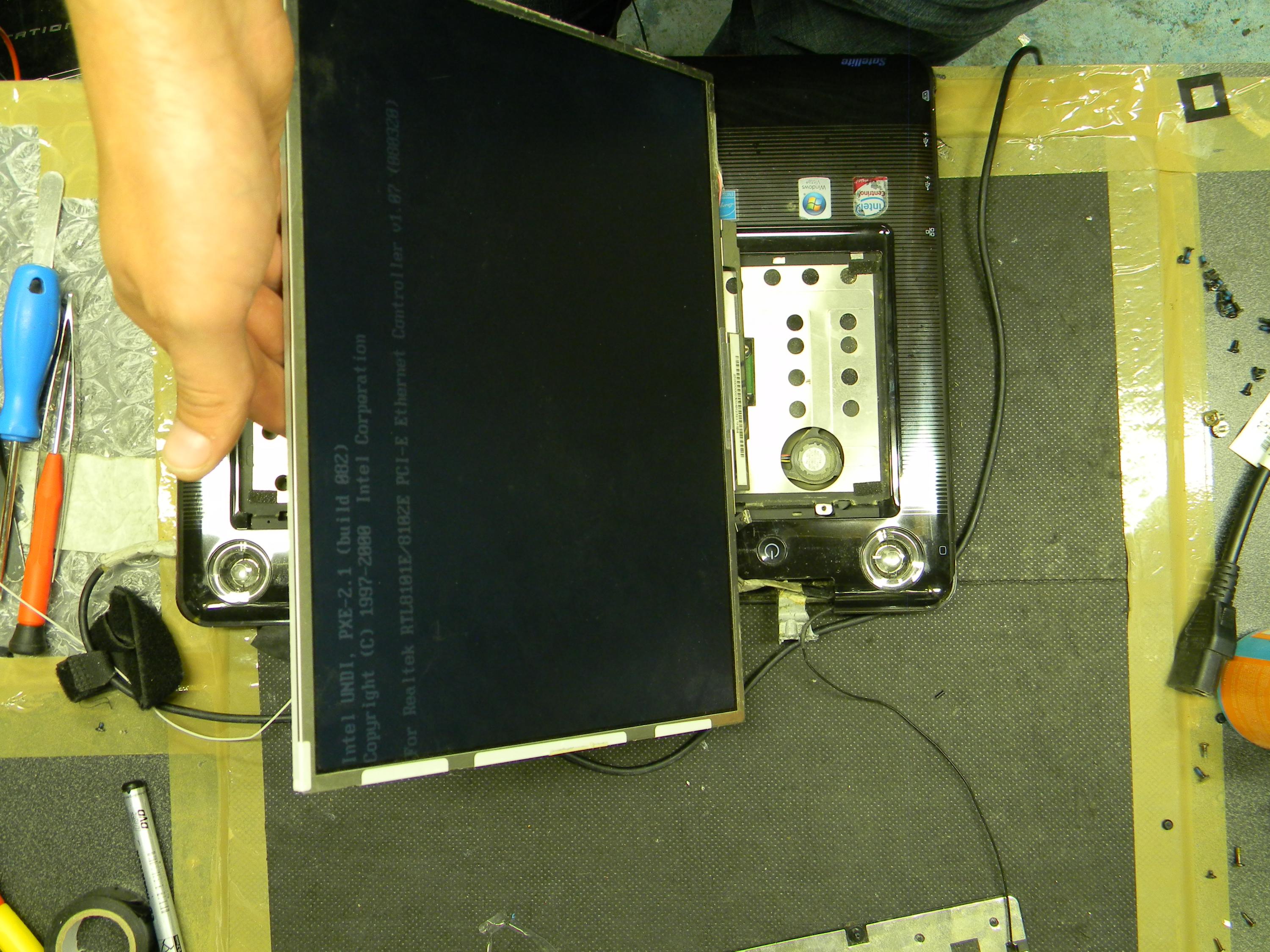

                i`m sry but i don`t want to hijack anything i`m working on a dell m5030 amd ver. with no backlight on the led but when i finish it or atleast try i can help you with your toshiba
                i got a the half working intel ver a300-1mc but understand that i need to finish mine first.
                find the schem and i will pull out the mainboard and we will check it

                    Re: Toshiba Satellite A300 No Power Problem
                    it seems you have backlight, since text is clear.
