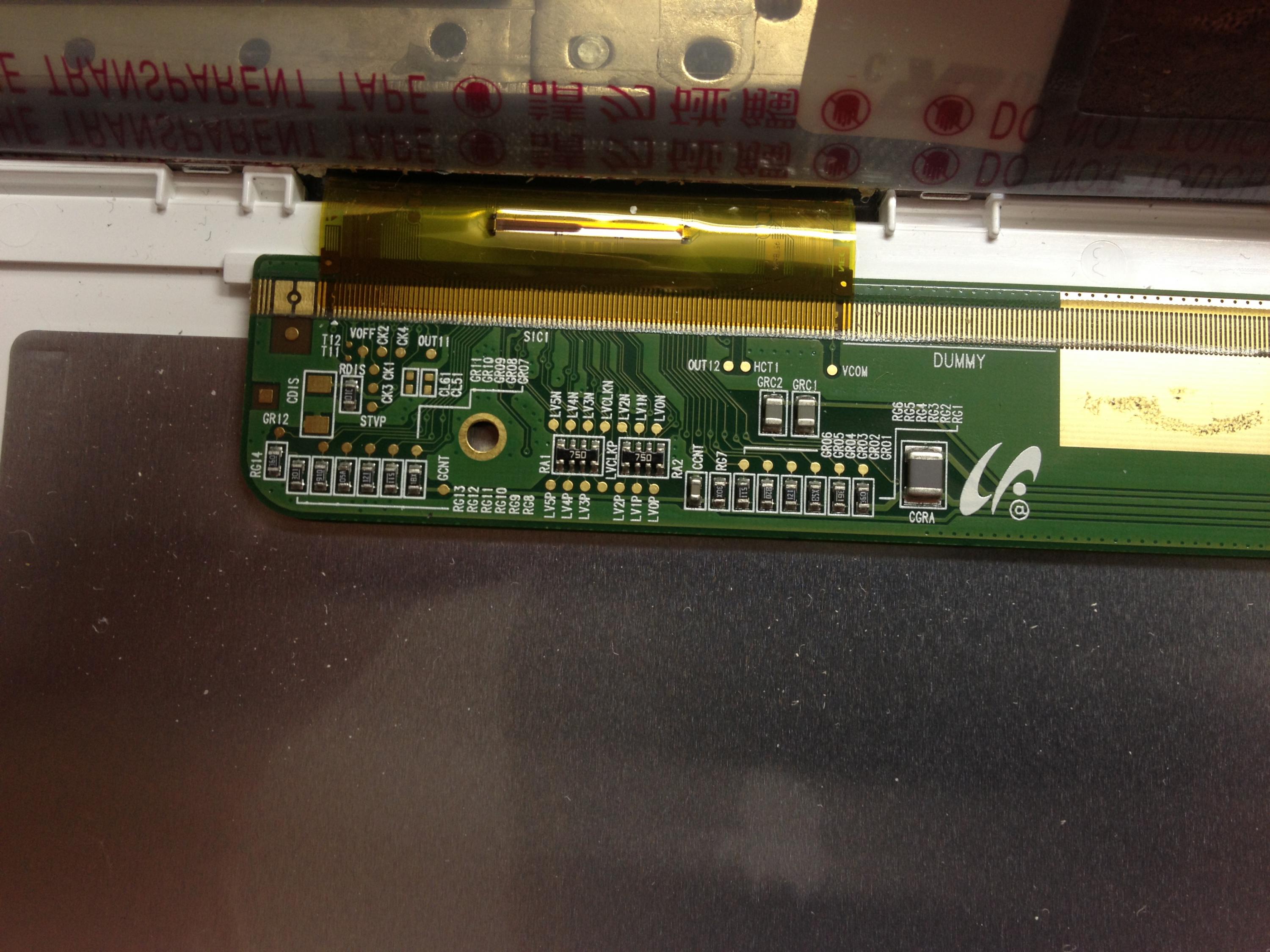

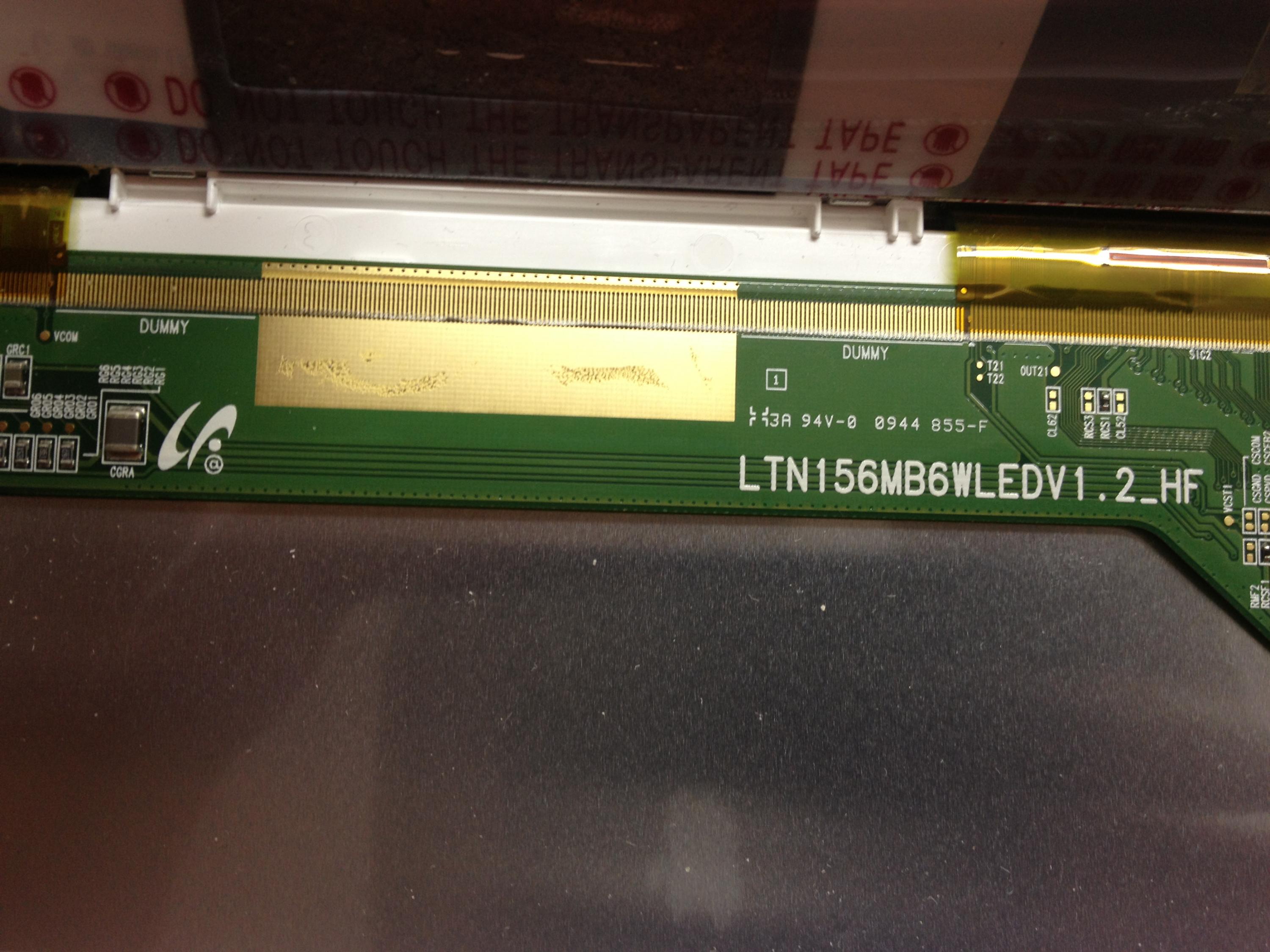

    i have this toshiba, when turn ON, all working ok but no backlight on LCD.
    I disassemble the screen and i think this is LED LCD so no inverter.
    Can you please check the photo of the LCD board and tell me what should i check.
    I see on one pict there is circle component marking (220). Is this a capacitor?
    Thank you

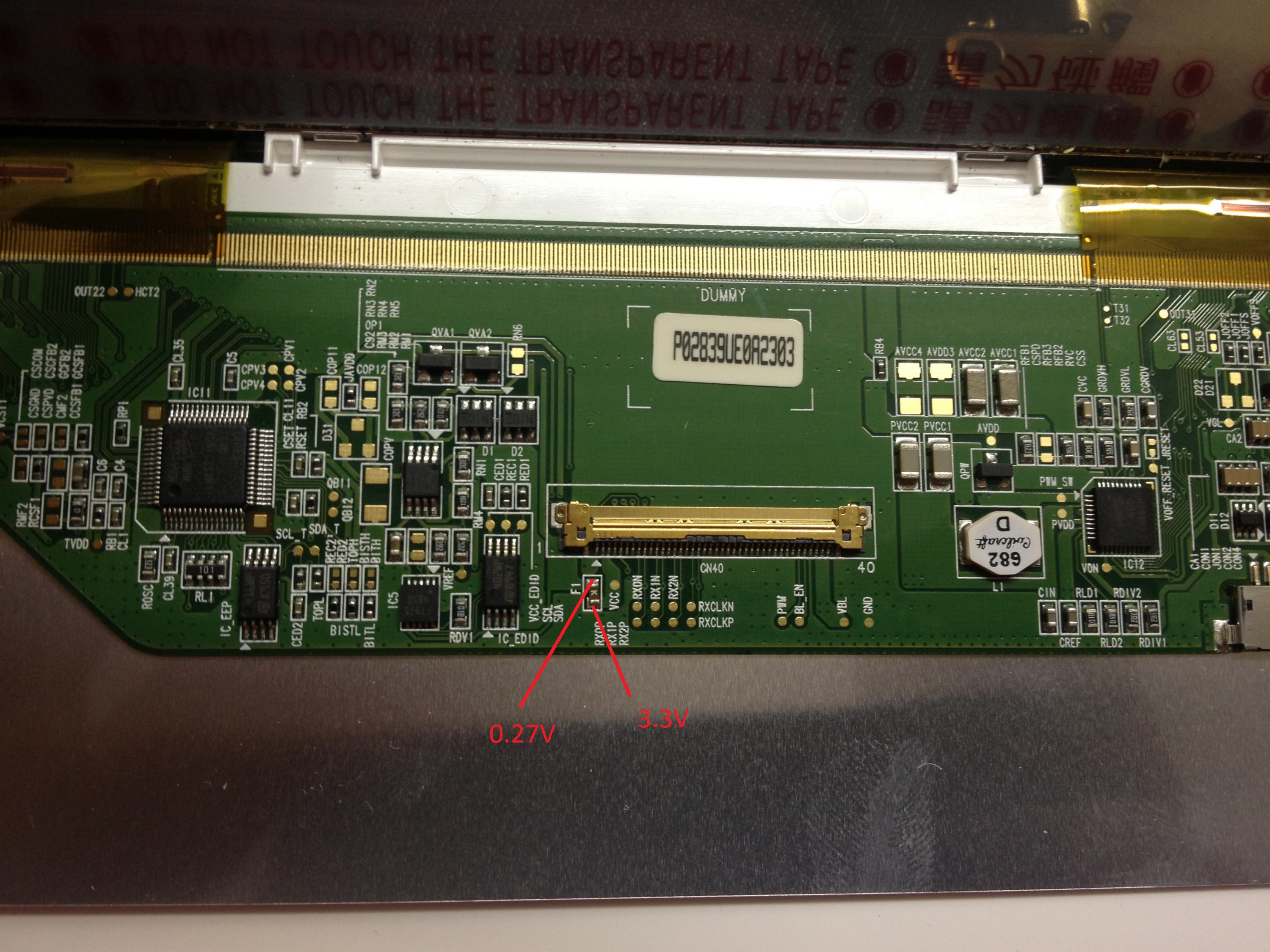

    Pin 1 ,2,3=19v (VSL)
    pin 5=3.3v (BL_EN)
    pin6= 3.3v for full brigthness (PTW)

      pin 1= 0V
      pin 2,3 =3V
      pin 4,5,6 =3.15

          i found 19V on LCD board, it is marked here.

            0.81v is too small for back light control . it should be between 2 and 3v max . reflow GPU and if it does not not work ; disconnects the connector pin(0.81v) and with a wire ,solder 3V(+v3alw) directly from the motherboard up to the screen at pin ptw(0.81v).

                                        i disconnect pin11 and connect +3VALWP on it, but light wont turn on. Now i have 3V on PWM. Is this the LCD screen fail?
                                        @spidey: how can i check this IC?
