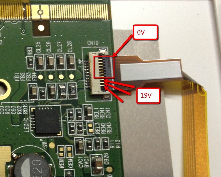

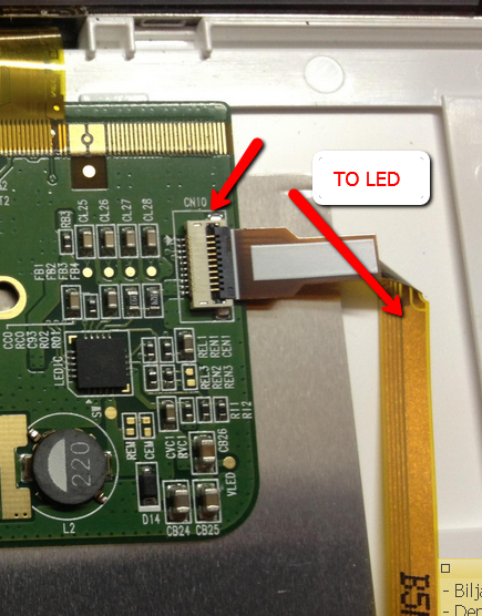

Re: Toshiba Satellite L500-1R1 no backlight
find datasheet, you can also find schematic for your screen. Measure input voltages and signal, check if you can get the output. if the working conditions ok on input side and you dont have output, that means it is not working, if you have output, then you should chnge backlights.
