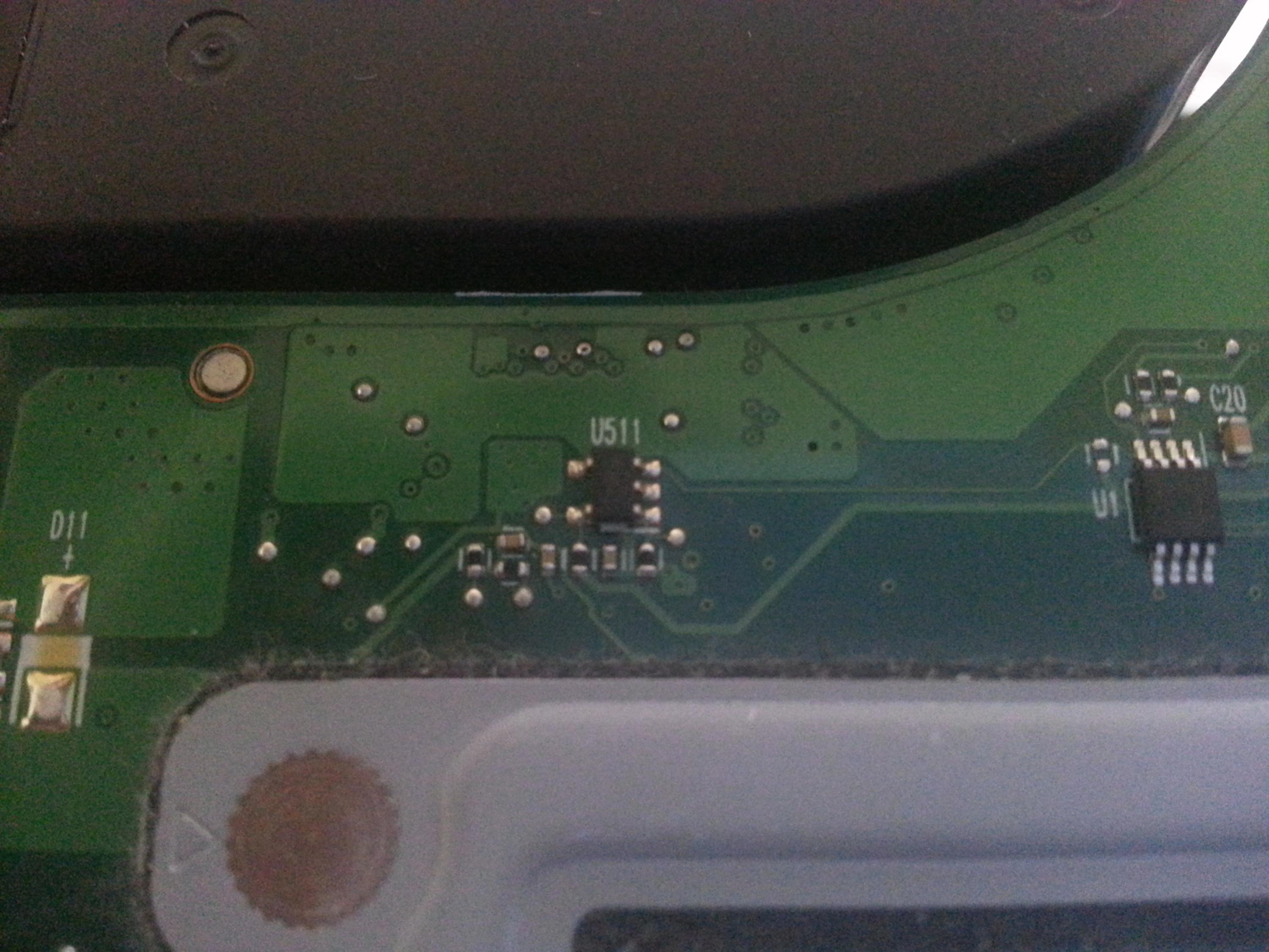

Toshiba satelite l300 power problem
  • jawal37
    • Feb 2013
    • 41
    • afric
    Toshiba satelite l300 no power u511 short circuit

      plzz tell me more about the model of the notebook i found schematics for Inventec PS10S Inventec PT10SC Inventec PS10AP - 6050A2175001 Inventec PS10A - 6050A2174501

        I too also have a dead l300 but could not locate that U511. Where is it? Board number 6050a2170201-mb-a03

            Here you go, ... This is where the chip is, ... Close to the fan.

              you need to remove it and see if the chip it self its short or the short its on the pads
