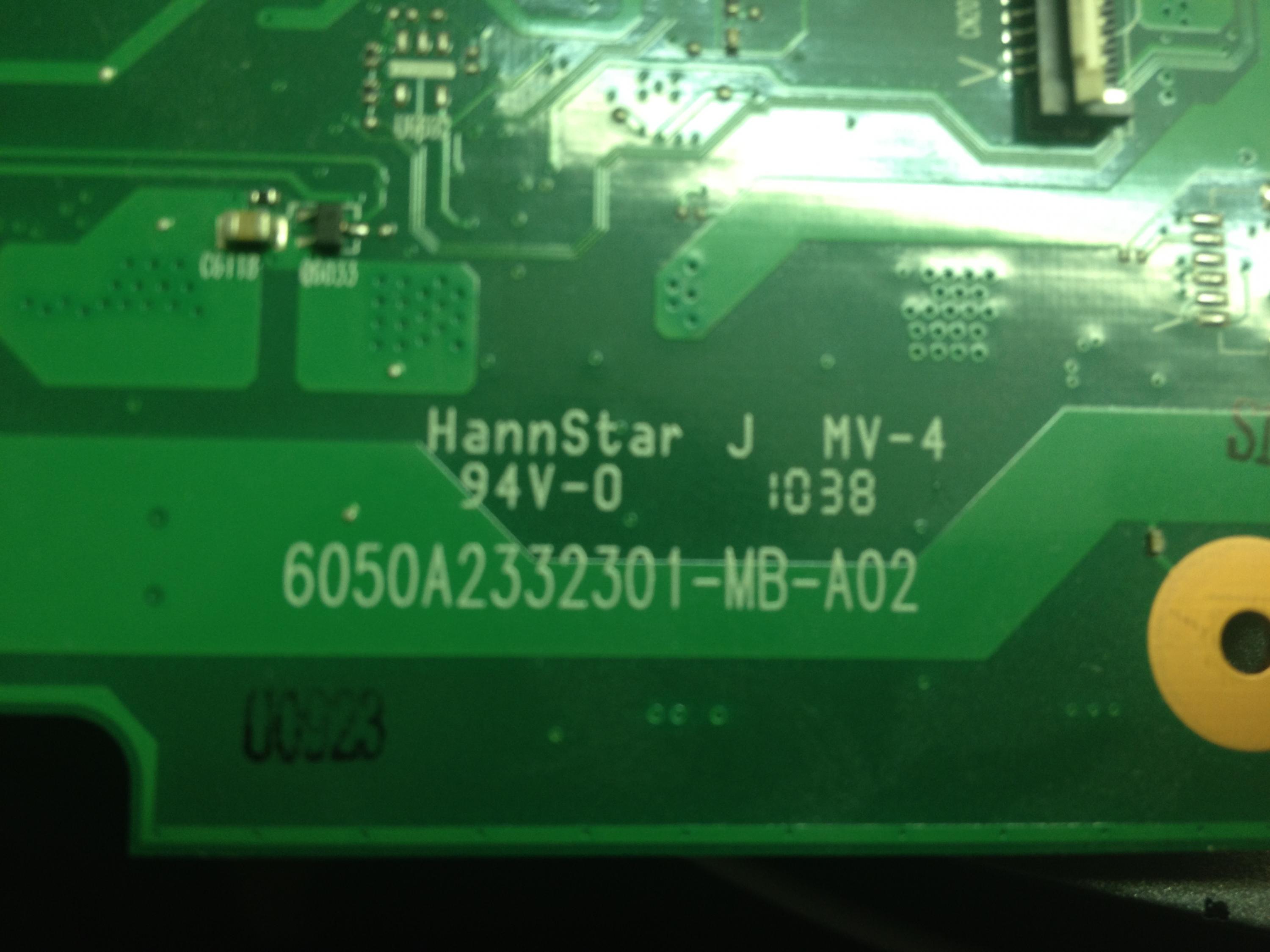

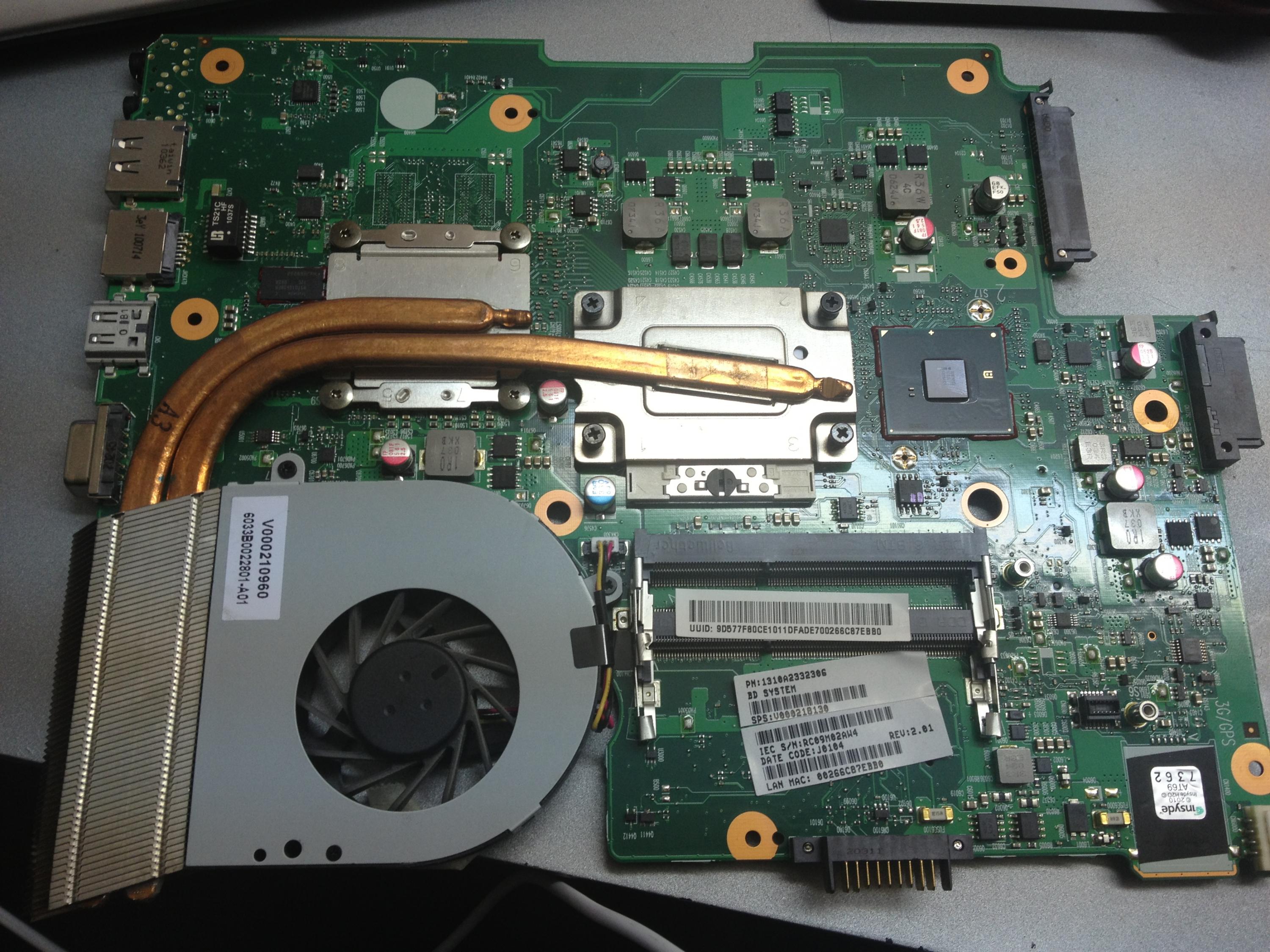

    Hi, i got this notebook with no power led on. I assume that the power jack is bad but jack is fine. i got 19V on board, but no sign of power when i press power switch. Can someone help?

    i test all fuse they are OK

      when push start button on battery, orange LED (battery empty) blink, and that is it, no charging LED and no power LED

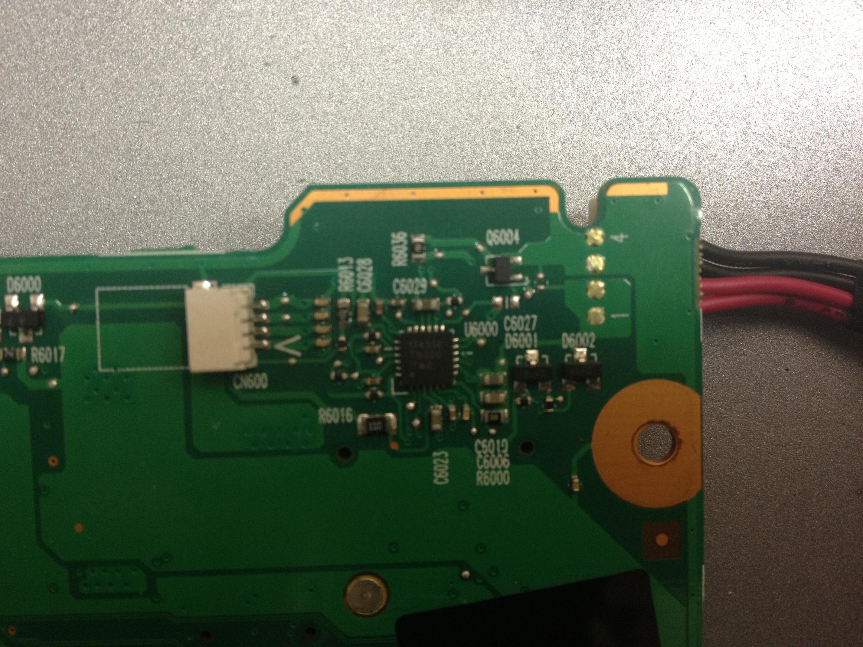

              i found in this thread the same problem, i think here is bad MAX17435ETG+ Battery Management High f SMBus. And i found the schematic od mobo. So there is no power, all led-s are dead except blinking orange (like battery low). What do you think?

                i replace MAX17435ETG+, but still no power , i check L6000 now its 0V.

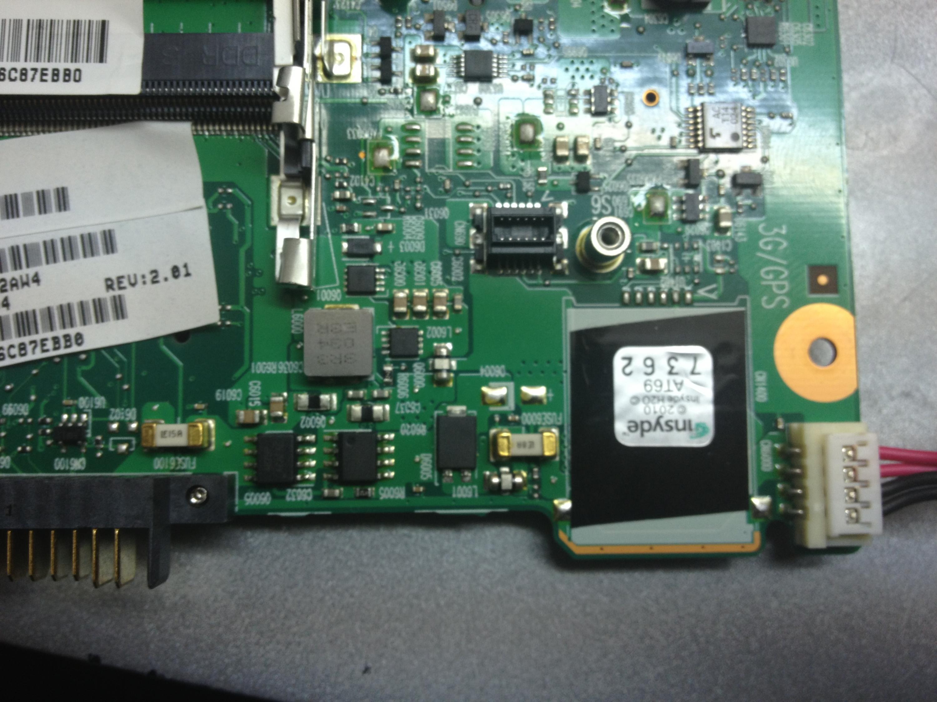

                  Re: Toshiba Satellite L655 (HannStar J MV-4 94V-0)
                  i don't see that any voltages other than 1V are going into the U6000 IC, i have 12V on one side of Q6002 and other side is 0.86V.
                            If there is 12v on the Drain of Q6002, it should be 19v from the charger. Why is it only 12v?
                            Or is the 12v on the Source from the battery?
                                If you have 12v on one side of Q6002, (I think it comes from battery) probably D6005 or L6001 (from 19v side) could be open. Check it and post.
