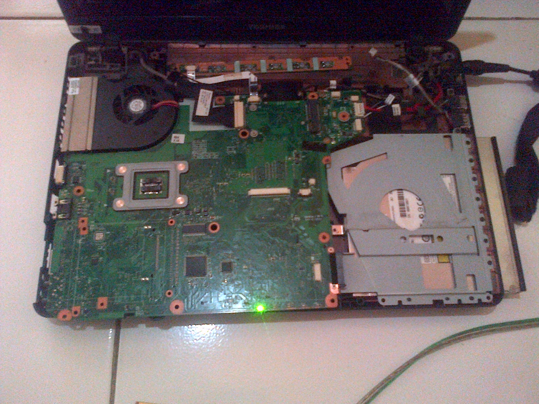

    toshiba L510 laptop does not display the image on the screen
    when I turn on the laptop using the battery ... laptop dead, and the indicator light
    when i use an adapter (charging) her laptop restart
    of those two things
    no display screen

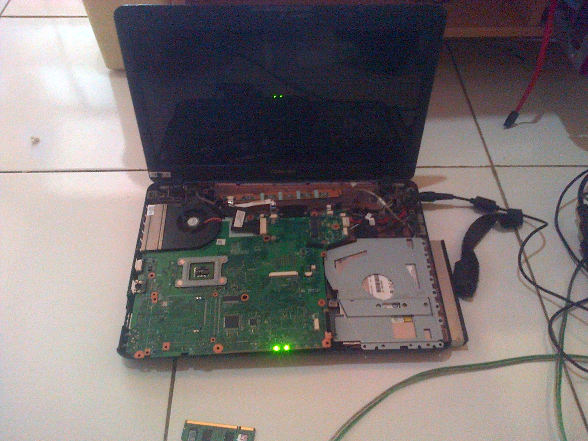

        laptop adapter is included in the mode without batteries
          Re: toshiba L510 laptop no display
          after the switch
          indicator lights "RAM" is not working

            It's your ATI GPU. Do a reflow and then check. If it does, reball that chip.

              Would You Try In External Monitor Or LCd Monitor?
              if not Done. Still Prob.
              In This Forum have Trend same as Problem Like Yours. Like They Called Modify Capacitor.
              if they Same Problem. Kawan its time to Re flow A GPU...
              then Ok... Baik

                Try to remove the nec/tokin and replkace it withe 4 capacitor 330

                    yes I have used the external LCD ..
                    but there was no response at all
                    yes i will try to reflow

                      yes I've done the installation of capacitor 330uf 4
                      but do not get a response at all

                              make sure you put 330uf 2.5v. not 6.5v
                              you can add another 330uf 2.5v, see what happen
                              if its GPU related, don't waste you time reflowing it, reball it right away..

                                What is the brand and part number of the new capacitors?
                                Does the Vcore voltage turn on?
                                  Try to replace the NEC tokin first, if it is still, then reball your GPU Chipset
