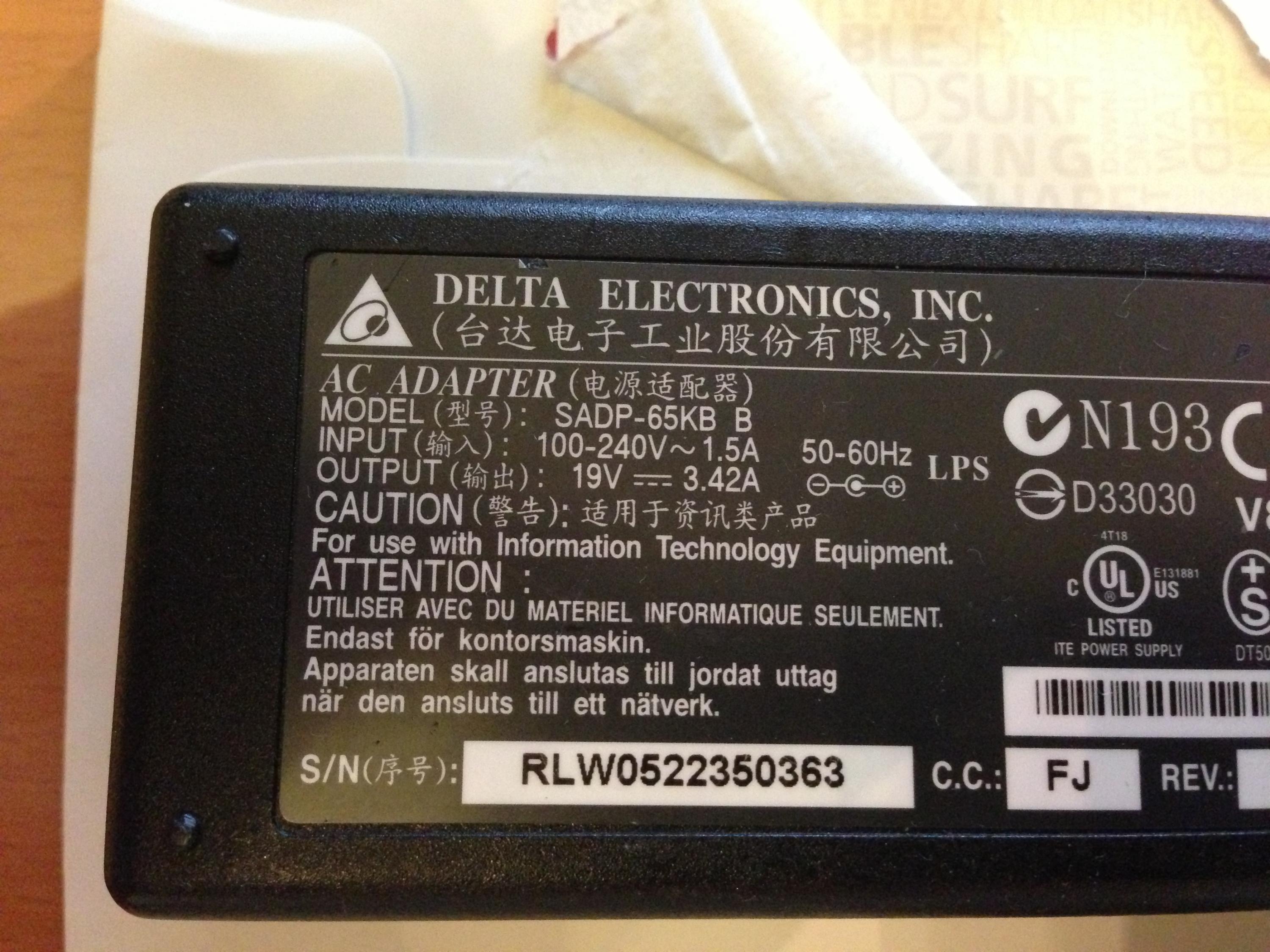

It is a Delta electronics manufactured unit for an ASUS laptop (a3v laptop I bleieve)
Outputi s 19V - 3.42 amps.
model number is sadp-65kb b

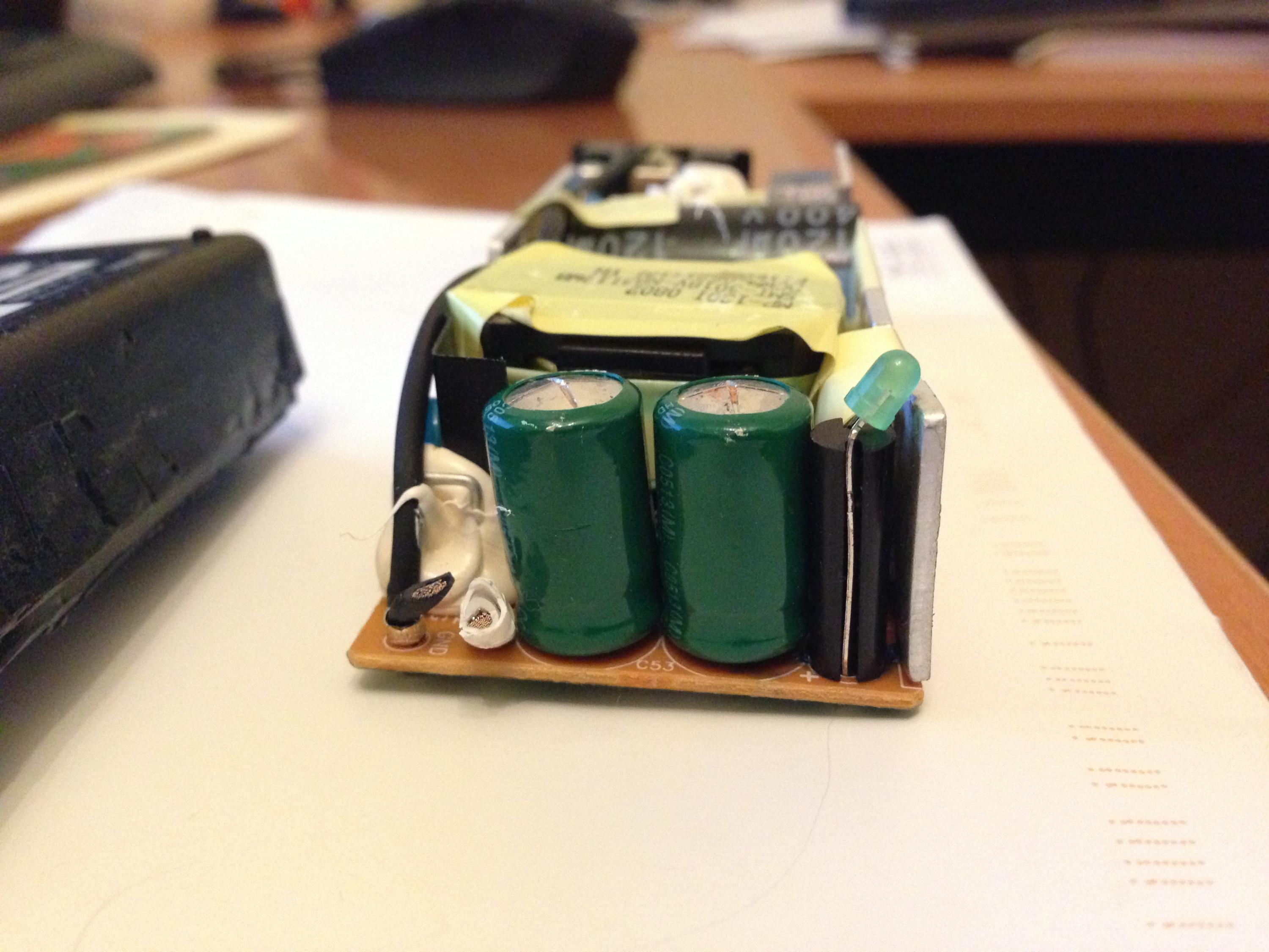

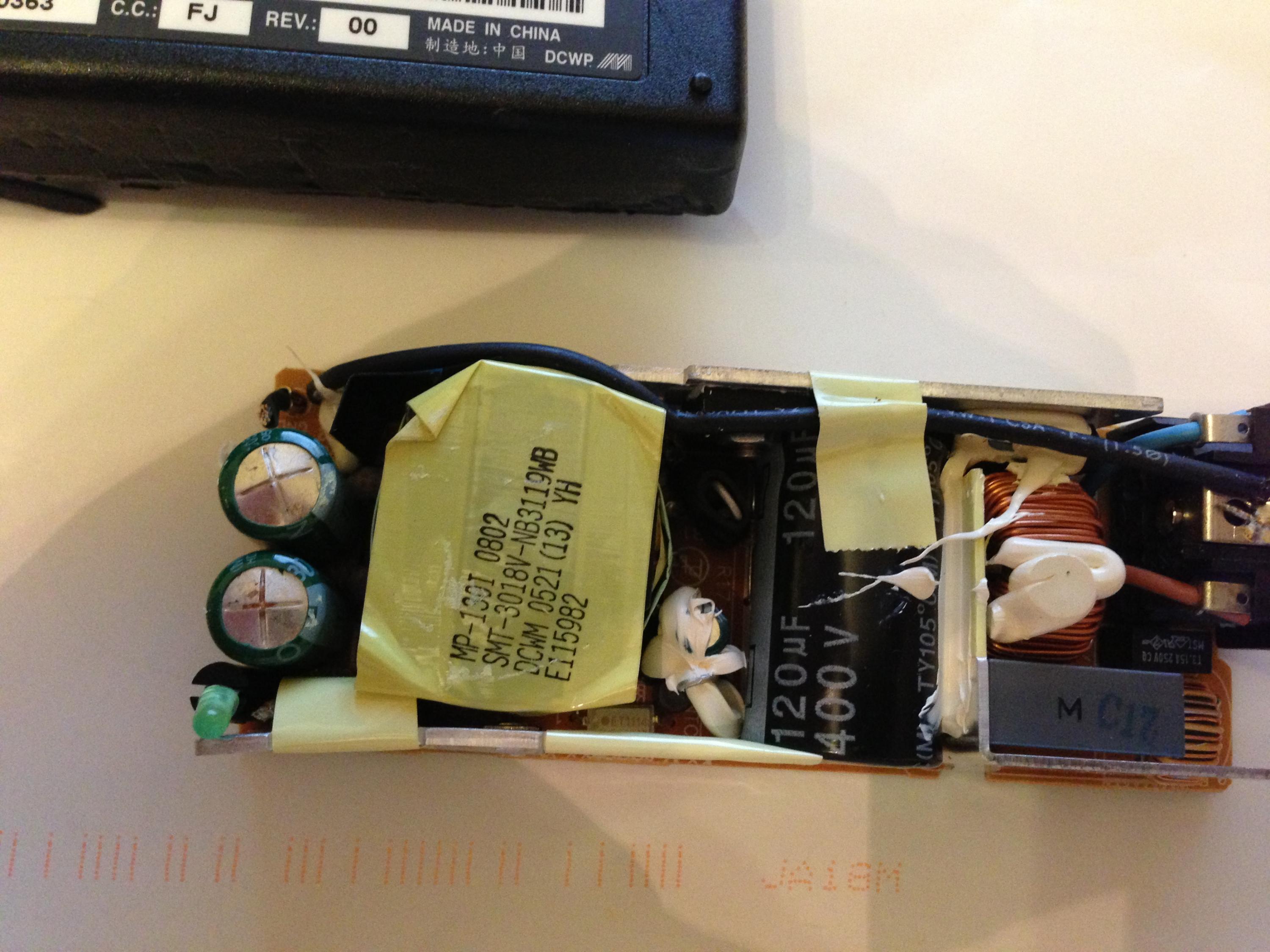

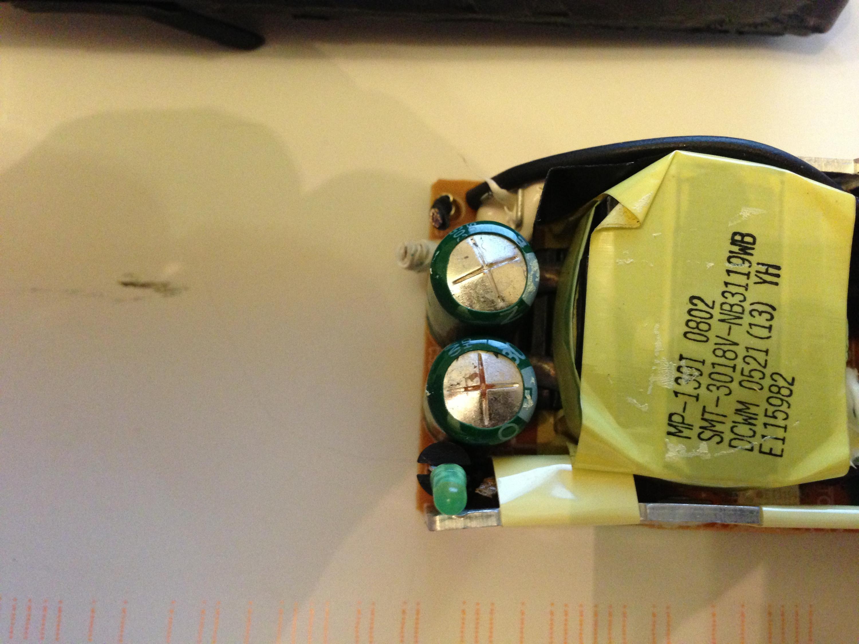

I cracked open the ac adapter and found 2 bad capacitors
25V-680uF were bulging/leaking.
Don't know if this is a known issue with these adapters, but hopefully this knowledge may help someone.
