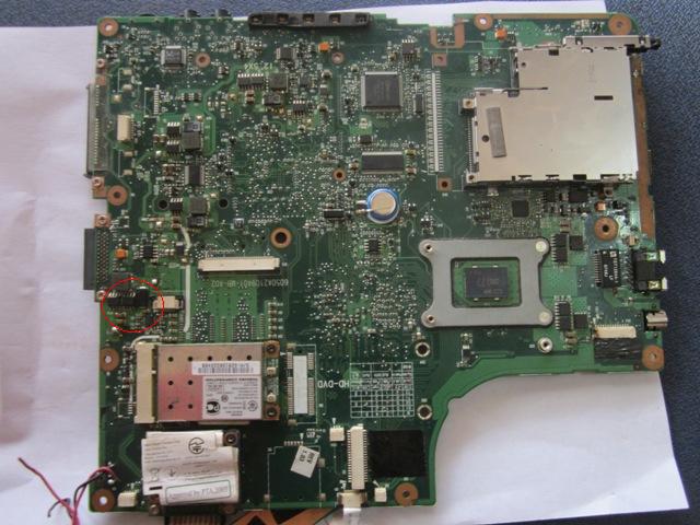

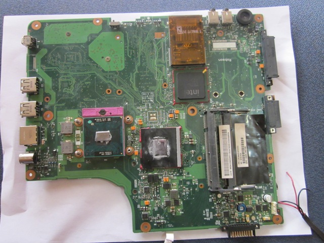

    Hi fellas,
    A customer brought a faulty laptop to my shop last week, it was toshiba saltellite A200 and it wont power on nor charge battery no led indicators when you press power button but after some few troubleshooting i realize there was a short on the mobo. i later on found a MOSFET 4800B which was the problem so i removed it and replaced it with a similar one and everything start working fine, led indicators were on, battery was charging well but i found another problem i cant get a clue to, "when i press the power button there is no display and the the power keeps on restarting after every 10secs and will go off automatically on the third restart, some few months ago i had the same problem with Toshiba satellite M200 after changing a bad cap. can someone help me on this?

            It will help if you post wich motherboard is mounted. I have 3 diferents schematic motherboard for satellite A200 with many 4800B mosfets in diferent circuits.

              My mobo is toshiba satellite Pro A200, model number is PSAF4A-003007

                Hi bluestone, this model number is not mention in any of the esquematics I have. could you see in the motherboard something like IAKAA M/B LA-3401P, or LA-3481P, or Milwaukee 10 WS2 BUILD?

                  Yes francisco, i see Milwaukee 10, please help
