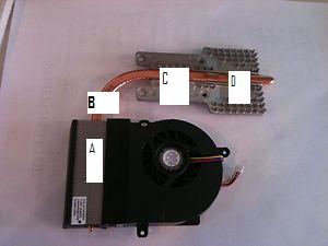

    I have a Toshiba Satellite L300-145 that overheats and shuts down the CPU reaches over 95º and then shuts down,at idle it works in the 60-70º range.
    but as soon as I run the CPU at 100% it quickly jumps from 60-95º in less than 5 minutes.
    I have reapplied thermal paste and cleaned fan and heatsink vents but to no avail ,my only work around at the moment is to reduce my CPU speed in windows vista from 100% to 80% on an Intel T2390 which relates to a speed reduction from 1.8 to 1.3 GHz. at 1.3 it reaches a maximum temp of about 85º.
    I'm thinking that it's related to heatsink but it seems to be working well, as you can see in the picture section C lies on top of CPU ,D on video card I turned on the computer with the heatsink in the position in the photo and felt the areas with my finger the results were the following with fan spinning:
    Section C ,D very HOT
    Section B warm
    Section A cool.
    To me this seems normal unless someone else knows better.
    I would like to get the laptop working at it's full speed again and not run reduced.
    Any replies would be helpful.

    Re: Toshiba Satellite L300 overheating ,bad heatsink?
    any damage to copper pipe section (crack or dents etc)?
    have you replaced thermal pad under D?

      Hi
      I have removed thermal pad and tried paste with same result I then put back the original thermal pad.
      There seems to be a long scratch where C is on top like the picture but doesnt seem to be deep enough and not sure how it even got that scratch since I have never scratched it.
      It gets hot though.
      By the way I couldn't take a picture of my heatsink so I found this one instead.

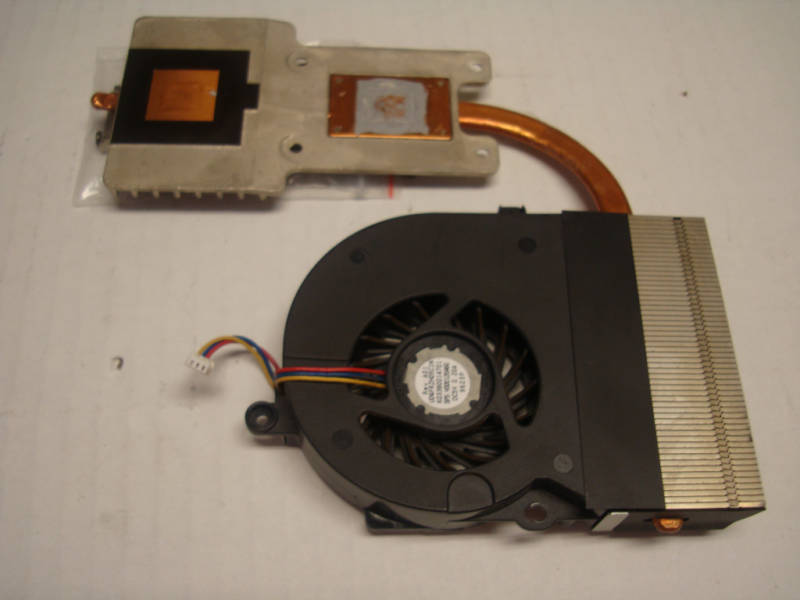

        heatsink has 4 screws around C to hold it tight and flat to CPU,
        this is not the case with D, there is always a gap of about one sixteenth of a inch, so paste wont do the job, some advise a copper shim there,
        I would never put a copper shim there,
        reason being, if you take a feeler guage to the gap you find that they can have a greater gap on oneside than on the other side, so a shim can never be flat to chip and heatsink
        I think it would be worth replacing thermal pad with new one, especially now that you have taken off the old one at some point

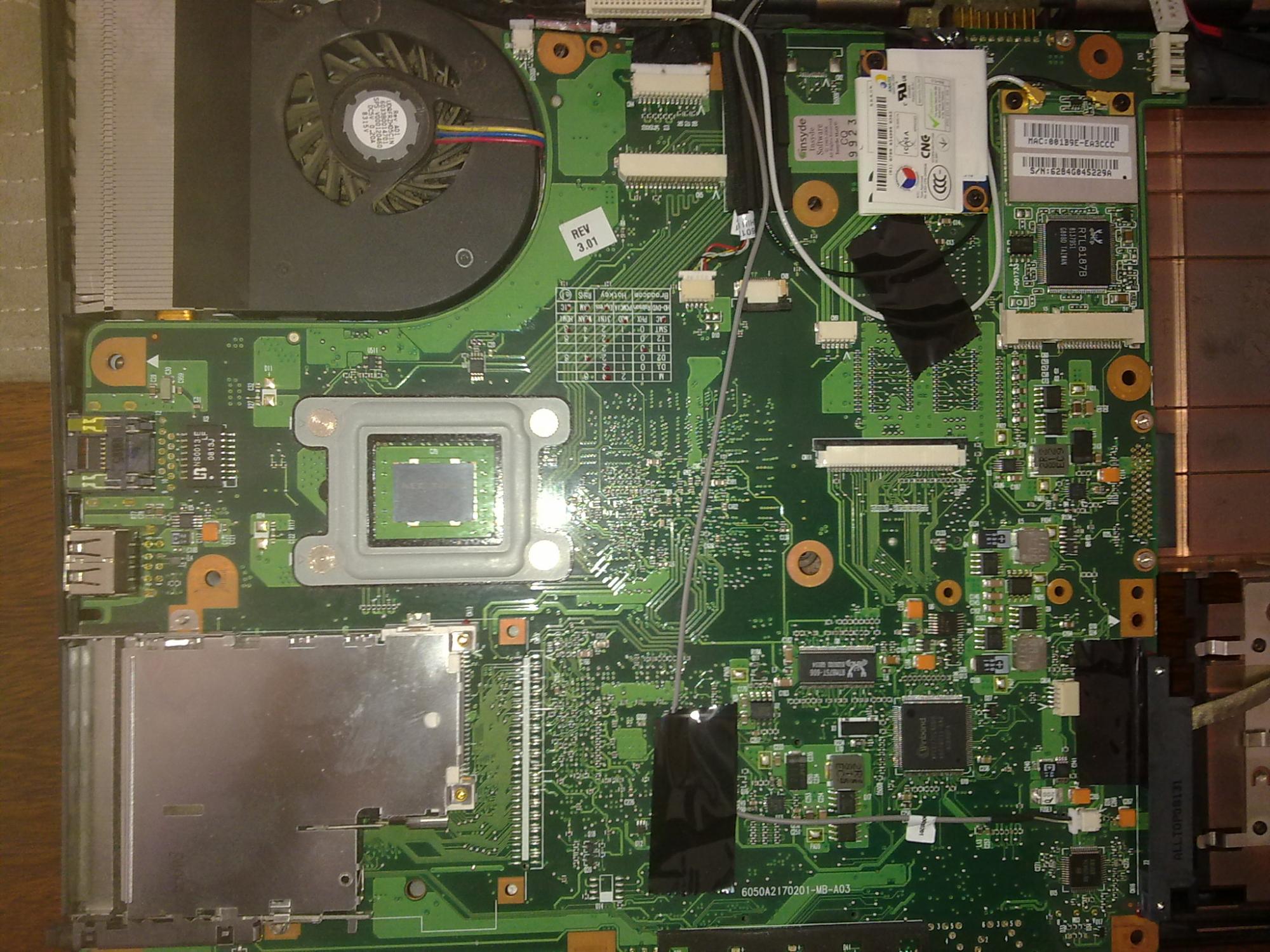

          Here is the bottom of the heatsink
          Image taken from:
          http://www.laptech24.co.uk/store/Tos...000120610.html

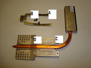

            Now this is how it connects to the motherboard:
            Area C and D has 4 holes that are placed on 4 metal shafts that protrude from the motherboard.
            Section A is attached to section D without screws as it hooks on and section B is bolted down with two screws on C the heatsink only uses two screws.
            The heatsink is lowered down with pressure and attaches itself to graphics chip and CPU.
            When I tried with the paste on the graphics chip there was evidence of contact between the two as it was smudged.

                  Can you take a pic of the motherboard underside?
                  • fabiog
                    • Jul 2011
                    • 102
                    thanks for the replies so it seems likely to be a heatsink or fan problem.
                    Here is a picture of the motherboard bottom side.
                    Image taken from:
                    http://www.buy-motherboard.com/produ...productid=8418
                    • mockingbird
                      • Dec 2008
                      • 5488
                      No, the other side... I want to see the VRM caps. Also, I'm not sure all L300 boards are the same. Take one of yours specifically. Toshiba switches OEMs with minor model revisions.
