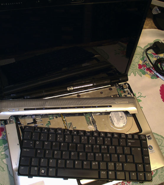

    HP Pavilion dv6700
    Not sure if customer dropped it.
    Screen doesn't show any loading stuff from starting.
    Lights come on, fan goes, hear the launching sound of Vista, screen gets on, but nothing shows up on it, no arrow, nothing.
    Customer wants quotation first!...
  • Newtonkh
    • Aug 2012
    • 5
    • India
    Re: HP Pavilion dv6700
    Please tell the complete cofiguration. I guess it is nVidia issue, Reflowing will solve for timebeing but will not last long.
    • Th3_uN1Qu3
      Believe in
      • Jul 2010
      • 6031
      • Romania
      Yes, backlight on and no picture is a common symptom of failed nvidia graphics chip.
      A working TV? How boring!
      • burntfingers
        • Jan 2011
        • 148
        Thanks, guys.
        I found out the set has already been reflowed, but apparently the trick wasn't successful.
        Customer will have to scrap this one, it appears.
