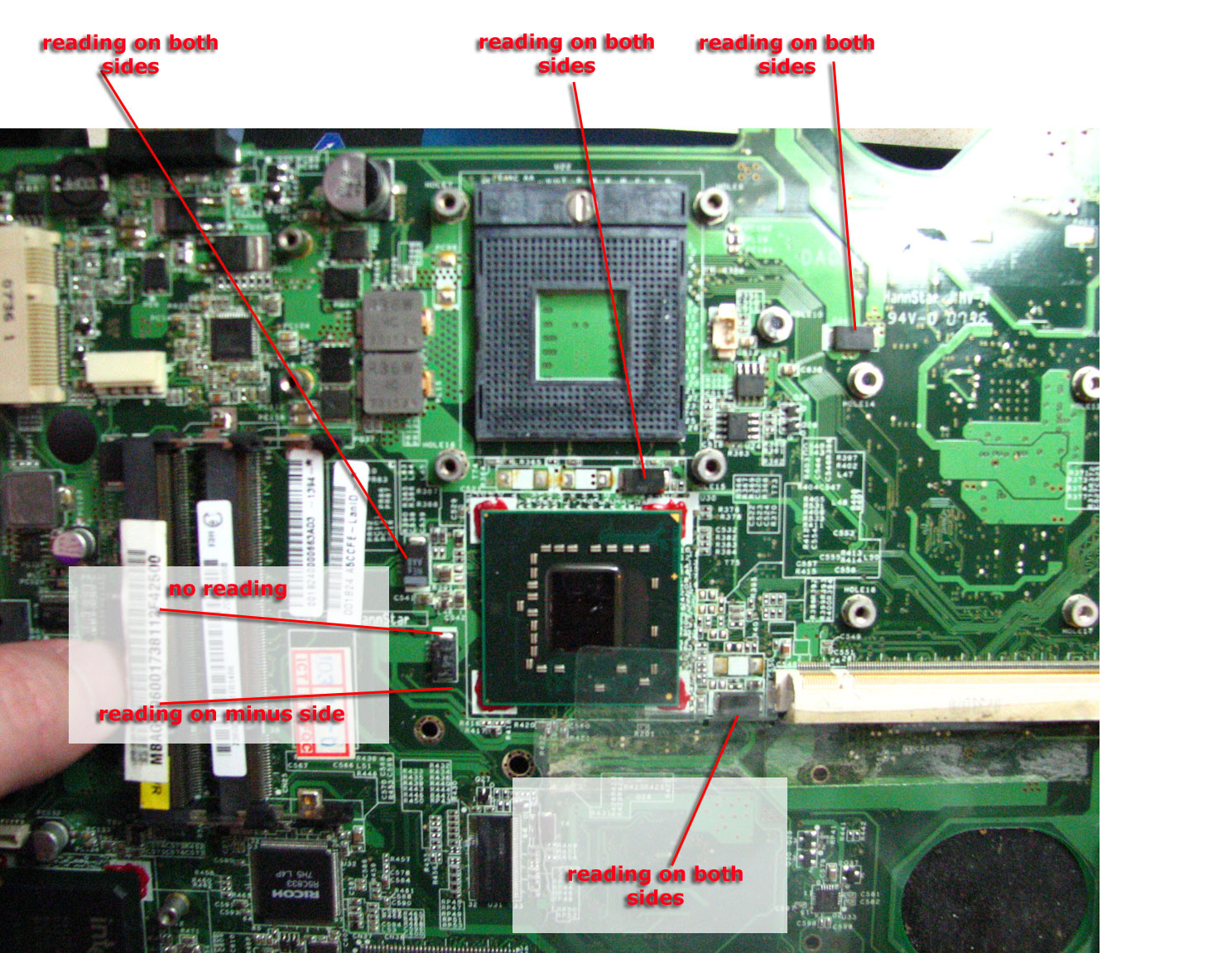

          Hi. I measure this 5 caps and some has readings no both sides, measured on board, without desoldering.
          Is that bad cap who has reading OHM on both sides ?

            Re: Acer aspire 5920 blink led light on Charger
            Check capacitors PC112 and PC118 near the memory slots,,, One of them or both them may be shorted
            or Sometimes PC90 and PC96 is shorted..

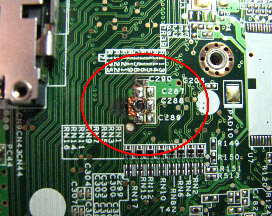

              Im found bad spot, there is 3 or 4 burned elements, I think is capacitors, EV@4.7U/25V_8
              I remove this elements and nov laptop is on, but is in LOOP restarting, I must find propper caps and replace them, maybe then will work OK I hope, finger crossed

                      i totally destroyed and removed capacitor PC112. maybe this is not the best way to fix things but i think PC118 will do its job.
                      i saw your case and that is a little different. in my 5920 i had not any sign of burned components. have you looked for another mobo?
