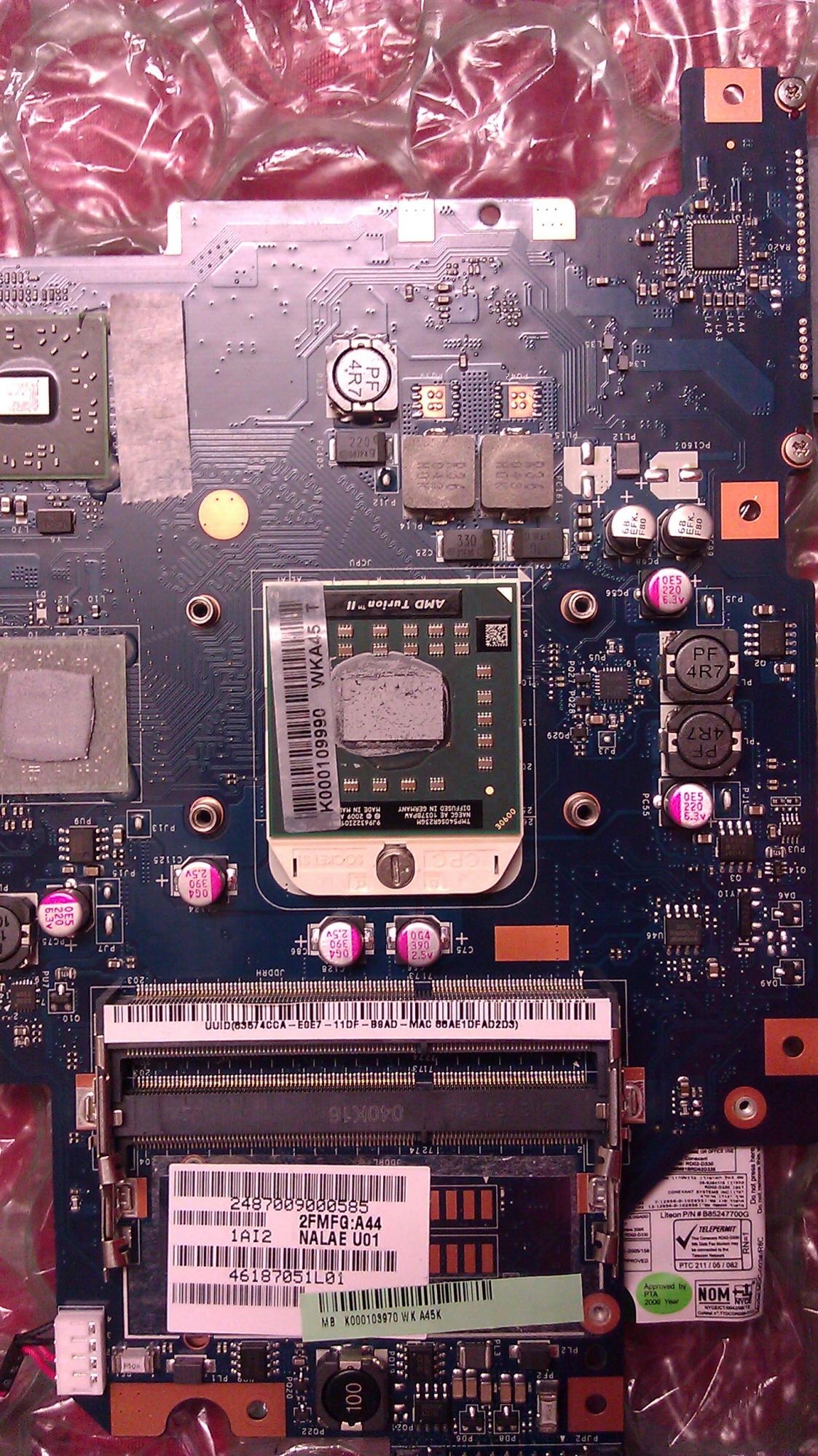

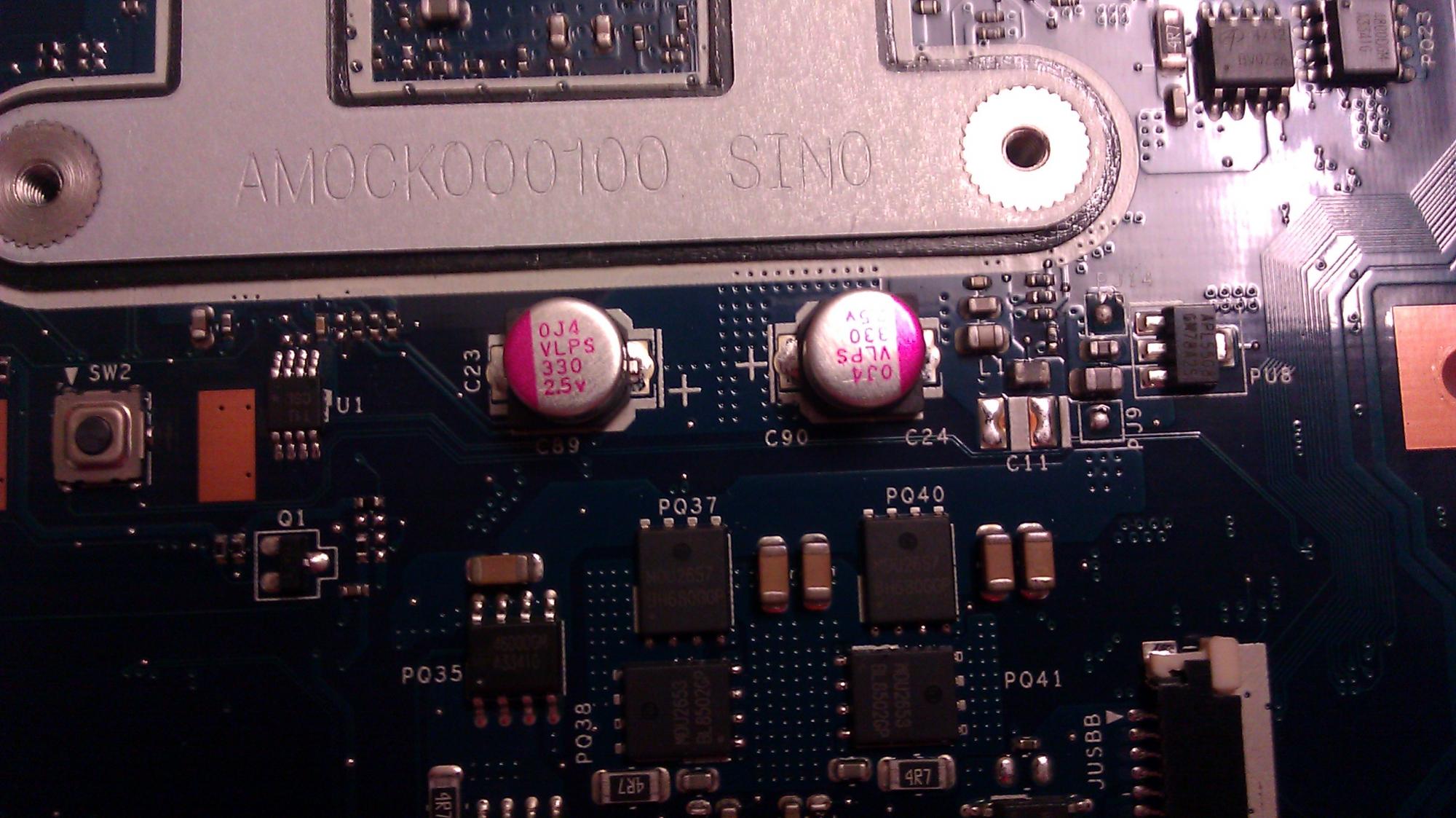

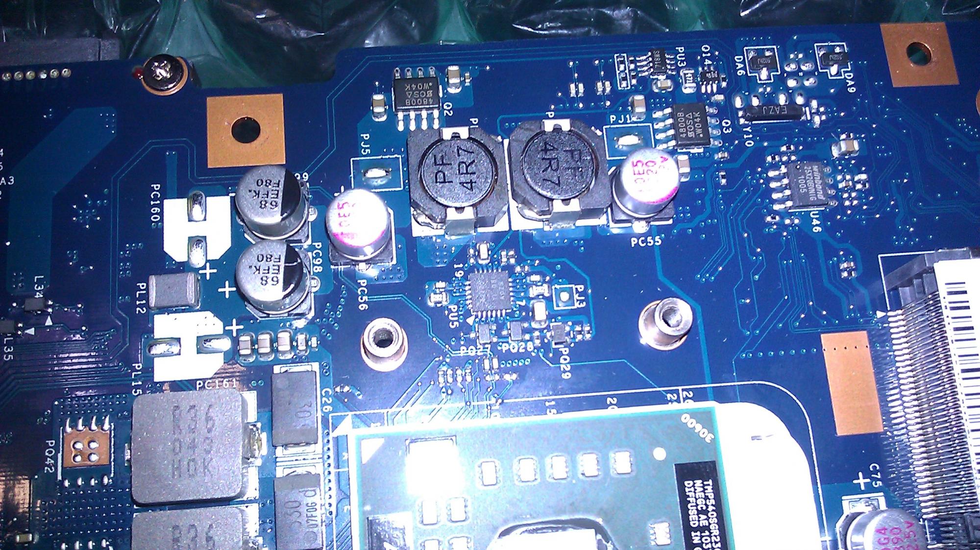

        Hello b700029 and fabiog, (fabiog, I hope you don't mind me jumping in on this thread as well)
        I have the same issue as fabiog, Toshiba L675D-S7049 works great on battery, but freezes immediately after plugging in or soon thereafter. However, I too do NOT have the Nec/Tokin OE907.
        I have tried countless other solutions as well, to no avail.
        Can you please tell me which capacitors to change, I am attaching images of both sides of the motherboard which if you zoom a bit, you can see the capacitors, some of which are:
        3 0E5 220 6.3V
        3 0G4 390 2.5V
        3 0J4 VLPS 330 2.5V
        Here I need your expertise...
        Can you please guide me on which to change and with what?
        If you need me to attach other images, or to post any additional information, please let me know...
