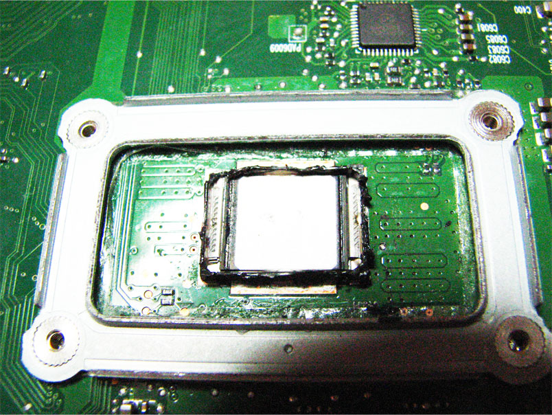

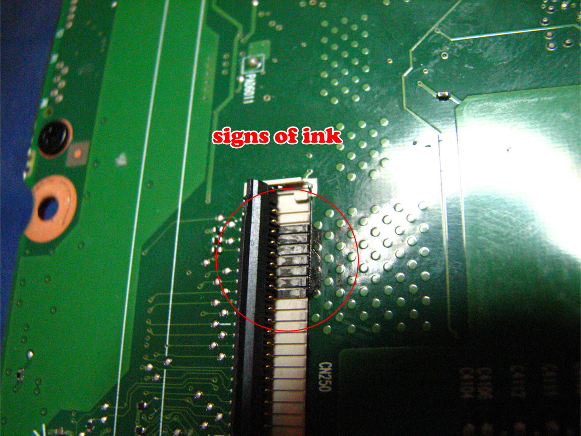

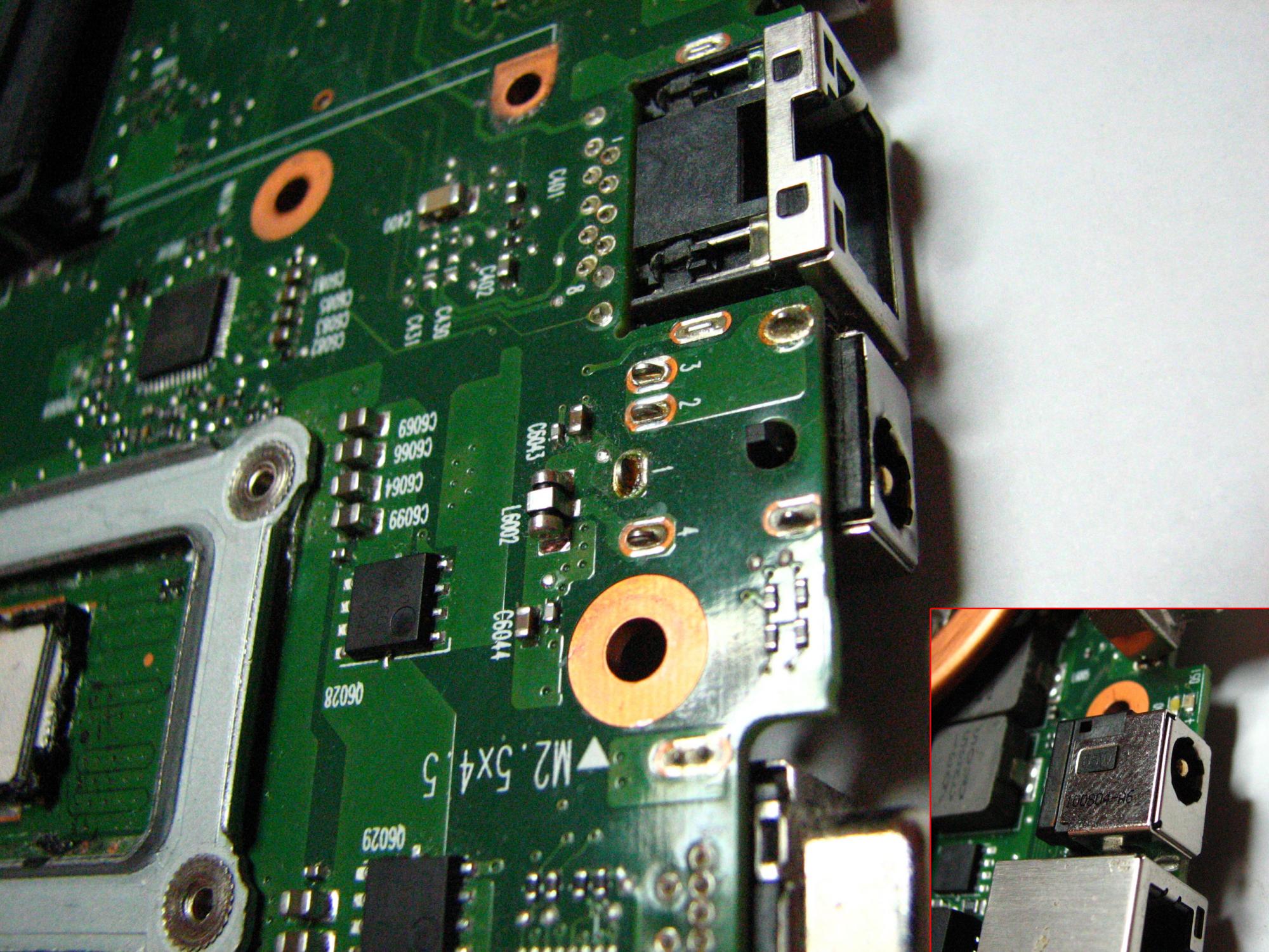

    Hi. This laptop was spilled with ink, on board has just little signs of ink, I just reflow the NEC Tokin 0E907 and now work, but power connector on motherboard has owerheating like hell. I try with 100% OK ac power adapter and result is same. What can be wrong ?

    That 0E907 looks destroyed. You can't reflow those, you need to replace them. They're only rated to stand 1 soldering cycle.
    There may be ink in the connector causing a high resistance connection, or other traces of it on the board creating a partial short. Ensure you have removed all of the ink. An infrared camera can identify the hot spots where this is happening.
    If you have an adjustable power supply of sufficient capacity you can remove the connector, solder wires to the pads and directly apply voltage. (Make sure to use the current limit function to prevent damage if there is a partial short somewhere else.)
      Re: HP 620 ac power connetor overheating
      Hi. I try your suggestion, solder + and - wire direct on board, after app 1 hour wire and board around conntacts no heat at all maybe 25-30°c, but AC adapter got app 50°C I see manytime hot AC adaptors but I think is that normal when is battery empty.
      So I think that is solved, bad AC connector on motherboard ?

        I hope this helps you a bit but yes some alcohol should clean that baby up pretty well depending on the ink it shouldn't cause that much problem but there is no way of knowing for sure so it is best to clean it up as best as possible.

          Hi. I fix this heating with resolder onboard AC power jack pins, and wash all motherboard with trichlorethylene. Now and before laptop work OK. Thanks for all.
