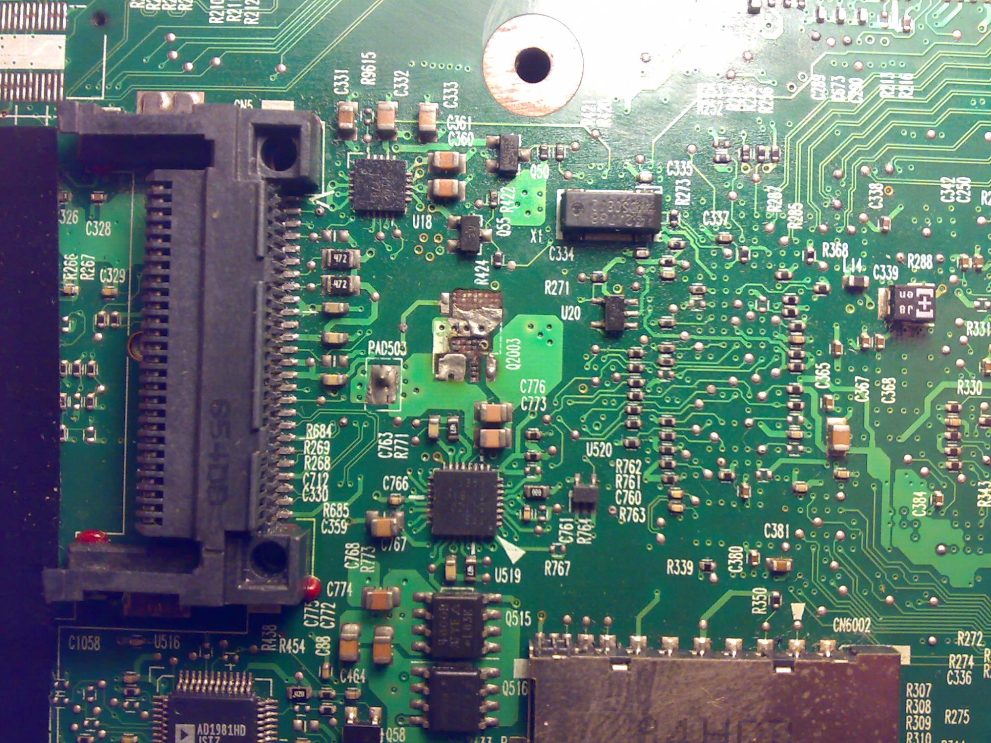

    This one has been on the shelf for a while now and thought i'd have another look. These motherboards seem to be plagued with this 7 flash then off problem. There are tons of dead ones on ebay...
    I did a bit of digging tonight and found a polish tech forum mentioning the model and fault in question.
    http://translate.googleusercontent.c...b2N71W9ZEl-BNQ
    What i cant fathom from the translation is, is the TPS51120 IC knackered or are they saying there is a short causing the TPS51120 to trip its protection?
    It gets too hot to touch with the battery inserted and power off
    Same with just power lead and battery and just power lead.
    It does however charge the battery ok.

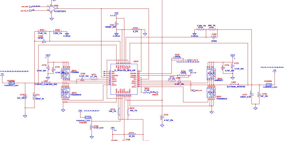

    This appears to be the schematic for the area.
    http://pdf1.alldatasheet.com/datashe.../TPS51120.html
    Im hoping someone more savvy than me can look through their findings and decipher the cure.

    I can't find much information on a 7620s. Did you mean 6720s?
    Schematics for the6720s (and related models) here:
    http://www.mediafire.com/?h909692ir7fab6x
    The power diagram is on page 4 and you can see that the battery charger/selector is before the main system power rail so it is normal that battery can still charge.
    Page 7 shows the TPS51120 and surrounding circuitry. It has two 100mA LDOs, one for 5V (labeled V5AL) and one for 3.3V (labeled V3AL). They should always be on when power is supplied. A short somewhere on either rail can cause the '51120 to heat up really quickly. You can isolate the V3AL by desoldering PAD555 and then checking for shorts beyond it, or by just plugging in and seeing if the '51120 gets hot again. If it still gets hot with V3AL disconnected, either the '51120 is internally bad or the V5AL is shorted. V5AL only powers U520, U8, and U6, the latter two are for the battery charger so I doubt they're shorted. Check the VREG5 and VREG3 voltages on pins 19 and 21 of the '51120, with V3AL disconnected. They should be at 5 and 3.3V.

          Have you checked the other side of the board? The pad shouldn't be far from pin 19 and C764. But the 3.3V looks OK so the fault is probably somewhere in the V5AL circuit. Post a high resolution, clearly focused picture of the board and we can help identify things beter.
          4.45V is indeed too low and shows the regulator being pushed beyond its current limit. Fortunately there's not much on V5AL... check these for shorts by removing these and testing resistance across them (or just seeing if the voltage rises back to ~5V with them out of the circuit):
          C765-767
          U520
          (on page 5
          C500
          C503
          U6
          U8
          On page 27 of the TPS51120 datasheet there's "VREG5 output voltage vs output current" and extrapolating that graph down to 4.45V makes it look like the short is consuming almost 1A to pull the voltage that low. Anything that reads <10 ohms is likely bad.

                    Lol! i wanted a hotspot and i got one. After lifting all the components above and not getting any change was about to put it back down and do something else. Turned the magnifier light off and a tiny arc from the IC popped out at me. Had a realy close look and one of the legs [pin 22 vbat] was broken right by the chip body. Exacto knife and kynar wire sorted that but on powering again i was treated to a firework display from an LDO fun !
                    The offending article is marked q2003 and not on the schematic...

                        Yeah, that was it exactly! Took out some of the copper so looks like I'm going to have to trace other solder points. It will live again! Lol
                        • KountZERO
                          • Nov 2009
                          • 78
                          Re: HP Compaq 7620s 7 flashes of death.
                          That image seems to be of the version of the motherboard as well. I cant seem to be able to get an image as good as that one
                          Checking the dmg again it seem that only a bridge to the other side of the board needs to be repaired. Its a shame i cant find an image of the pcb mask for the area under the LDO.
                          • KountZERO
                            • Nov 2009
                            • 78
                            LOL who would have thought i'd find a use for my old nokia n73.
                            Here is the damage after cleanup. You can see the bridge to the other side, its track came from pin 3, back under the IC. Now to fathom what caused the pyrotecnics before i blow another up lol.
